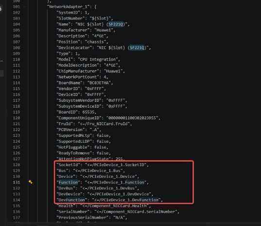

配置文件中,NetworkAdapter_1下的Bus、Device、Function均取用PCIeDevice_1下属性:
查看日志中 /bmc/kepler/Systems/1/PCIeDevices/PCIeDevice_1_010105
bmc.kepler.Systems.PCIeDevices.PCIeDevice Bus、Device、Function均为0

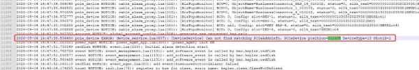

根据日志dump_info\AppDump\pcie_device\mdb_info.log来看,PcieAddrInfo_NIC_1_010101似乎并没有被加载上,导致没有找到相关的PCIeAddrInfo去分配信息
2026-09-04 14:47:38.534480 pcie_device ERROR: device_service.lua(607): [DeviceService] Can not find matching PCIeAddrinfo, PCIeDevice position=010105 DeviceType=13 SlotID=1
进一步发现PcieAddrInfo_NIC_1_010101的Bus再持久化设置时设置失败,导致对象挂掉
2026-09-04 14:25:21.426514 pcie_device ERROR: object_manage.lua(325): AddObject PcieAddrInfo_NIC_1_010101 failed, life_cycle_id:1, error:kepler.class.SetSyncPropertyError: The property Bus of the object PcieAddrInfo_NIC_1_010101 is a synchronous property and cannot be set
