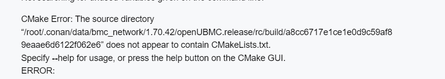

CMake Error: The source directory “/root/.conan/data/bmc_network/1.70.42/openUBMC.release/rc/build/a8cc6717e1ce1e0d9c59af89eaae6d6122f062e6” does not appear to contain CMakeLists.txt.
Specify --help for usage, or press the help button on the CMake GUI.
ERROR:
ConanException: Error 1 while executing cd ‘/root/.conan/data/bmc_network/1.70.42/openUBMC.release/rc/build/a8cc6717e1ce1e0d9c59af89eaae6d6122f062e6’ && cmake -G “Unix Makefiles” -DCMAKE_BUILD_TYPE=“Debug” -DCMAKE_SYSTEM_NAME=“Linux” -DCMAKE_SYSTEM_VERSION=“3.14” -DCONAN_CMAKE_FIND_ROOT_PATH=“/opt/RTOS/208.9.0/arm64le_5.10_ek_preempt_pro/sdk” -DCONAN_CMAKE_FIND_ROOT_PATH_MODE_PROGRAM=“NEVER” -DCONAN_CMAKE_FIND_ROOT_PATH_MODE_LIBRARY=“ONLY” -DCONAN_CMAKE_FIND_ROOT_PATH_MODE_INCLUDE=“ONLY” -DCMAKE_SYSROOT=“/opt/RTOS/208.9.0/arm64le_5.10_ek_preempt_pro/sdk” -DCONAN_IN_LOCAL_CACHE=“ON” -DCONAN_COMPILER=“gcc” -DCONAN_COMPILER_VERSION=“7.3” -DCONAN_LIBCXX=“libstdc++” -DCMAKE_INSTALL_PREFIX=“/root/.conan/data/bmc_network/1.70.42/openUBMC.release/rc/package/a8cc6717e1ce1e0d9c59af89eaae6d6122f062e6” -DCMAKE_INSTALL_BINDIR=“bin” -DCMAKE_INSTALL_SBINDIR=“bin” -DCMAKE_INSTALL_LIBEXECDIR=“bin” -DCMAKE_INSTALL_LIBDIR=“usr/lib64” -DCMAKE_INSTALL_INCLUDEDIR=“include” -DCMAKE_INSTALL_OLDINCLUDEDIR=“include” -DCMAKE_INSTALL_DATAROOTDIR=“share” -DCMAKE_EXPORT_NO_PACKAGE_REGISTRY=“ON” -DCONAN_EXPORTED=“1” -DBUILD_MANUFACTURE=“False” -DCONAN_DEFS_QEMU=“True” -DPACKAGE_VERSION_MAJOR=“1” -DPACKAGE_VERSION_MINOR=“70” -DPACKAGE_VERSION_REVISION=“42” -DCMAKE_TOOLCHAIN_FILE=“conan_toolchain.cmake” -DCMAKE_SKIP_BUILD_RPATH=“True” -DCMAKE_SKIP_RPATH=“True” -DCMAKE_SKIP_INSTALL_RPATH=“True” -DCMAKE_BUILD_WITH_INSTALL_RPATH=“False” -DCMAKE_INSTALL_RPATH_USE_LINK_PATH=“False” -Wno-dev ‘–no-warn-unused-cli’ ‘/root/.conan/data/bmc_network/1.70.42/openUBMC.release/rc/build/a8cc6717e1ce1e0d9c59af89eaae6d6122f062e6’

manifest中回退对应组件的版本号试一试
这个问题主要是在打包(package())阶段存在问题的
然后看到bingo基本上是最新版本的,可以拉最新的manifest仓,然后重新执行:python3 init.py -path <bmc_sdk.zip文件路径> -user <openUBMC社区用户名> -psw <openUBMC社区用户密码>
再次出包就应该没有问题了
  1. 这里面主要是触发了全量源码构建,但目前bmc_network组件在社区只有conan包导致的,可以直接conan download bmc_network/1.70.42@openUBMC.release/stable -r openubmc_dev看看能不能直接下载,然后不能不下载可以直接给我们返一下日志信息,也希望能够提供之前有问题的全部日志信息
  2. conan download bmc_network/1.70.42@openUBMC.release/stable -r openubmc_dev成功之后,拉最新的manifest,重新python3 init.py, 然后清除缓存rm -rf ~/.conan/data/*, 然后重新再来一次bingo build -sc qemu
按照您提供的方式构建成功了,多谢
