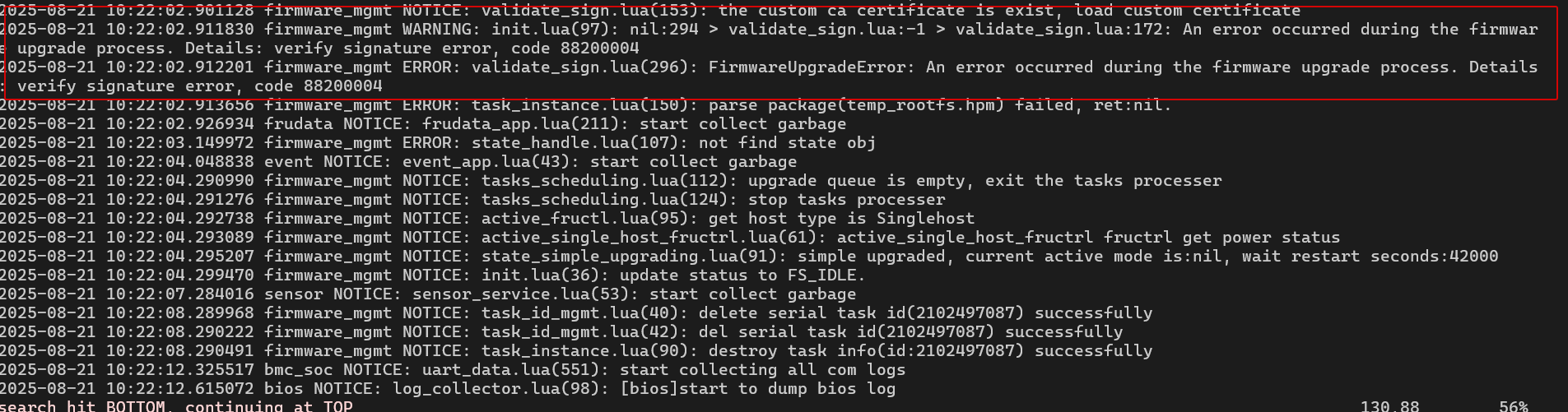

目前环境是2506的高可用版本,该版本升级过渡包失败(PS: 过渡包,2503的高可用包和2506的高可用包的签名都是同一个)日志如下:
% 1970-01-01 01:58:39.000292 firmware_mgmt NOTICE: active_fructl.lua(95): get host type is Singlehost
1970-01-01 01:58:39.001249 firmware_mgmt NOTICE: utils.lua(38): The file path is local.
1970-01-01 01:58:39.011093 firmware_mgmt NOTICE: init.lua(36): update status to FS_SIMPLE_UPGRADING.
1970-01-01 01:58:39.032522 firmware_mgmt NOTICE: task_service.lua(53): task create success, task id: 1610296419
1970-01-01 01:58:39.034576 firmware_mgmt NOTICE: task_id_mgmt.lua(30): add serial task id(1610296419) successfully
1970-01-01 01:58:39.037513 firmware_mgmt DEBUG: app_preloader.lua(77): …e_mgmt/lualib/upgrade/tasks_process/tasks_scheduling.lua:141: app(firmware_mgmt/service/main) fork func, count=1, delay=0
1970-01-01 01:58:39.039140 firmware_mgmt NOTICE: tasks_scheduling.lua(107): start tasks processer
1970-01-01 01:58:39.039858 firmware_mgmt DEBUG: tasks_scheduling.lua(115): queue num: cached:1, process:0
1970-01-01 01:58:39.193046 firmware_mgmt NOTICE: file_transfer.lua(145): start to move file [guodu_M102_0801_rootfs_TaiShan200_2280v2.hpm] from tmp to shm
1970-01-01 01:58:39.845514 firmware_mgmt NOTICE: file_transfer.lua(150): move_file_s ok:true, err:0
1970-01-01 01:58:42.060310 firmware_mgmt DEBUG: validate_sign.lua(321): file_num 3 file1_id 1, file2_id 2, file3_id 3, file_list_len 171, cms_sign_len 9378, crl_file_len 3522
1970-01-01 01:58:42.460126 firmware_mgmt WARNING: init.lua(97): nil:294 > validate_sign.lua:-1 > validate_sign.lua:172: An error occurred during the firmware upgrade process. Details: verify signature error, code 88200004
1970-01-01 01:58:42.461705 firmware_mgmt ERROR: validate_sign.lua(296): FirmwareUpgradeError: An error occurred during the firmware upgrade process. Details: verify signature error, code 88200004
1970-01-01 01:58:42.464011 firmware_mgmt ERROR: task_instance.lua(150): parse package(guodu_M102_0801_rootfs_TaiShan200_2280v2.hpm) failed, ret:nil.
1970-01-01 01:58:42.681832 firmware_mgmt ERROR: state_handle.lua(107): not find state obj
1970-01-01 01:58:43.793221 firmware_mgmt NOTICE: tasks_scheduling.lua(112): upgrade queue is empty, exit the tasks processer
1970-01-01 01:58:43.793988 firmware_mgmt NOTICE: tasks_scheduling.lua(124): stop tasks processer
1970-01-01 01:58:43.796182 firmware_mgmt NOTICE: active_fructl.lua(95): get host type is Singlehost
1970-01-01 01:58:43.797238 firmware_mgmt NOTICE: active_single_host_fructrl.lua(61): active_single_host_fructrl fructrl get power status
1970-01-01 01:58:43.800265 firmware_mgmt NOTICE: state_simple_upgrading.lua(91): simple upgraded, current active mode is:nil, wait restart seconds:42000
1970-01-01 01:58:43.812737 firmware_mgmt NOTICE: init.lua(36): update status to FS_IDLE.
1970-01-01 01:58:47.793003 firmware_mgmt NOTICE: task_id_mgmt.lua(40): delete serial task id(1610296419) successfully
1970-01-01 01:58:47.793572 firmware_mgmt NOTICE: task_id_mgmt.lua(42): del serial task id(1610296419) successfully
1970-01-01 01:58:47.794565 firmware_mgmt DEBUG: task_id_mgmt.lua(165): del parallel sub task id failed, sub task id:1610296419
1970-01-01 01:58:47.795492 firmware_mgmt NOTICE: task_instance.lua(90): destroy task info(id:1610296419) successfully
