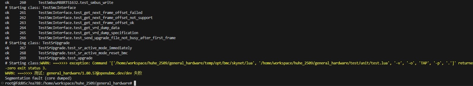

单元测试 bingo test -ut运行失败
2509版本:bingo 版本为: 0.6.80
general_hardware下运行bingo test -ut出现以下错误:

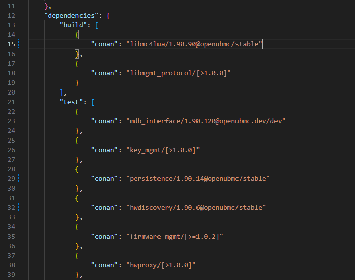

之后修改相关依赖文件的版本号:
运行后报错:
ok 258 TestSmbusM88RT51632.test_parse_response
ok 259 TestSmbusM88RT51632.test_smbus_read_quick
ok 260 TestSmbusM88RT51632.test_smbus_write
Starting class: TestSmcInterface
ok 261 TestSmcInterface.test_get_next_frame_offset_failed
ok 262 TestSmcInterface.test_get_next_frame_offset_not_support
ok 263 TestSmcInterface.test_get_next_frame_offset_ok
ok 264 TestSmcInterface.test_get_vrd_dump_data
ok 265 TestSmcInterface.test_get_vrd_dump_specification
ok 266 TestSmcInterface.test_send_upgrade_file_not_busy_after_first_frame
Starting class: TestSrUpgrade
ok 267 TestSrUpgrade.test_sr_active_mode_immediately
ok 268 TestSrUpgrade.test_sr_active_mode_reset_bmc
ok 269 TestSrUpgrade.test_upgrade

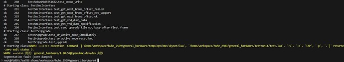

Starting class:WARN: ===>>>> exception: Command ‘[’/home/workspace/huhe_2509/general_hardware/temp/opt/bmc/skynet/lua’, ‘/home/workspace/huhe_2509/general_hardware/test/unit/test.lua’, ‘-v’, ‘-o’, ‘TAP’, ‘-p’, ‘.’]’ returned non-zero exit status 3.
WARN: ===>>>> 测试: general_hardware/1.80.57@openubmc.dev/dev 失败
Segmentation fault (core dumped)
按照社区相关贴执行临时解决方案apt-get install -y ipmitool dbus-x11 libdbus-1-dev dbus,还是报以上错误:
之前运行过2503的bingo test -ut命令,运行成功,其bingo版本号是0.5.X,尝试修改bingo版本号,也运行失败
目前没有好的定位手段来确定是哪里的问题

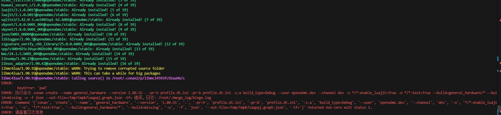

试一下这个 bingo test -jit
升级到conan2后, bingo 做了调整, 组件的dt包是默认经过luajit转译的。
在进行组件DT测试时,需要显式指定-jit参数。
我这边试了一下bingo test -jit,还是报以上错误:
Starting class: TestUpgBaseTest
ok 286 TestUpgBaseTest.test_start
ok 287 TestUpgBaseTest.test_upgrade_finish_func
ok 288 TestUpgBaseTest.test_upgrade_single_retimer_finish_func
ok 289 TestUpgBaseTest.test_upgrade_single_retimer_func
Starting class: TestUpgServiceTest
ok 290 TestUpgServiceTest.test_start
Starting class: TestUpgServicehandler
ok 291 TestUpgServicehandler.test_is_upgrading_active
ok 292 TestUpgServicehandler.test_no_upgrade_service_obj
ok 293 TestUpgServicehandler.test_unallowed_upgrade
ok 294 TestUpgServicehandler.test_upgrade_init
Starting class: TestUpgradeSubject
WARN: ===>>>> exception: Command ‘[’/home/workspace/huhe_2509/general_hardware/temp/opt/bmc/skynet/lua’, ‘/home/workspace/huhe_2509/general_hardware/test/unit/test.lua’, ‘-v’, ‘-o’, ‘TAP’, ‘-p’, ‘.’]’ returned non-zero exit status 2.
这个看着应该是执行到TestUpgServiceTest的用例执行失败,异常退出了。

not ok 266      TestSrUpgrade.test_upgrade
#   ...al_hardware/test/unit/sr_upg_service/test_sr_upgrade.lua:56: bad argument #3 to 'unpack' (initial position out of string)
#   stack traceback:
#       ...al_hardware/test/unit/sr_upg_service/test_sr_upgrade.lua:56: in upvalue 'TestSrUpgrade.test_upgrade'

# Ran 342 tests in 0.074 seconds, 339 successes, 1 failure, 2 errors
WARN: ===>>>> exception: Command '['/home/ocy/openUBMC/25-09/source/general_hardware/temp/opt/bmc/skynet/lua', '/home/ocy/openUBMC/25-09/source/general_hardware/test/unit/test.lua', '-v', '-o', 'TAP', '-p', '.']' returned non-zero exit status 3.
WARN: ===>>>> 测试: general_hardware/1.80.55@openubmc.dev/dev 失败
这是我的2509环境,有几个用例测试确实会失败
not ok 55 TestDpuObj.test_log_clear
not ok 9 TestDpuObj.Test_get_sdi_cpld_info
bingo 版本为: 0.6.55
general_hardware:1.80.55
hwdiscovery:1.90.6
各组件版本都为2509配套
是的,固定测试用例失败!我又执行了几遍,not ok是执行到300 TestUpgradeobject就异常退出了,TestUpgradeobject为源码没做修改,可能还要再分析下,

WARN: ===>>>> exception: Command '['/home/workspace/huhe_2509/general_hardware/temp/opt/bmc/skynet/lua', '/home/workspace/huhe_2509/general_hardware/test/unit/test.lua', '-v', '-o', 'TAP', '-p', '.']' returned non-zero exit status 3.
这种失败就是正常的功能测试失败,是符合预期的,应与依赖组件确认功能性变更
