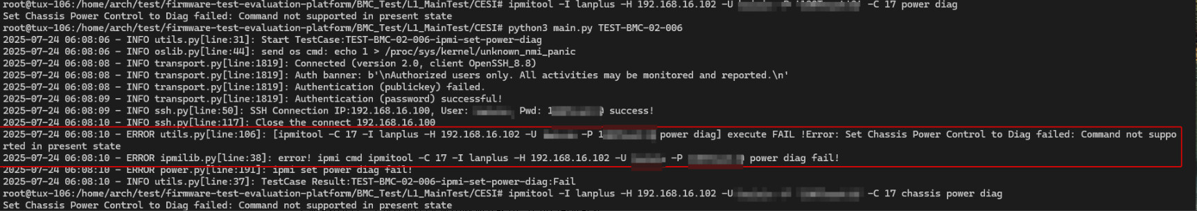

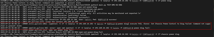

ipmitool -I lanplus -H 192.168.16.102 -U xxxx -P 'xxxx' power diag
# iBMC 返回
Set Chassis Power Control to Diag failed: Command not supported in present state
日志片段如下(见截图):
root@tux-106:/home/arch/test/firmware-test-evaluation-platform/BMC_Test/L1_MainTest/CESI# ipmitool -I lanplus -H 192.168.16.102 -U xxxx -P 'xxxx' -C 17 power diag
root@tux-106:/home/arch/test/firmware-test-evaluation-platform/BMC_Test/L1_MainTest/CESI# python3 main.py TEST-BMC-02-006
2025-07-24 06:08:06 - INFO utils.py[line:31]: Start TestCase:TEST-BMC-02-006-ipmi-set-power-diag
2025-07-24 06:08:06 - INFO oslib.py[line:44]: send os cmd: echo 1 > /proc/sys/kernel/unknown_nmi_panic
2025-07-24 06:08:08 - INFO transport.py[line:1819]: Connected (version 2.0, client OpenSSH_8.8)
2025-07-24 06:08:08 - INFO transport.py[line:1819]: Auth banner: b'\nAuthorized users only. All activities may be monitored and reported.\n'
2025-07-24 06:08:08 - INFO transport.py[line:1819]: Authentication (publickey) failed.
2025-07-24 06:08:09 - INFO transport.py[line:1819]: Authentication (password) successful!
2025-07-24 06:08:09 - INFO ssh.py[line:50]: SSH Connection IP:192.168.16.100, User: xxxx, Pwd: xxxx success!
2025-07-24 06:08:10 - INFO ssh.py[line:117]: Close the connect 192.168.16.100
2025-07-24 06:08:10 - ERROR utils.py[line:106]: [ipmitool -C 17 -I lanplus -H 192.168.16.102 -U xxxx -P xxxx power diag] execute FAIL !Error: Set Chassis Power Control to Diag failed: Command not supported in present state
2025-07-24 06:08:10 - ERROR ipmilib.py[line:38]: error! ipmi cmd ipmitool -C 17 -I lanplus -H 192.168.16.102 -U xxxx -P xxxx power diag fail!

Kunpeng 服务器(openubmc)本身就不支持标准的 chassis power diag
谢谢大佬,做用例开发时候发现有个跑不通,所以来问下,这块我在用例上标注一下
1、关于问题1/2/3,IPMI的power diag命令是需要硬件(如CPLD)、CPU芯片、BIOS以及OS共同配合的,最早是在x86平台定义的,通过NMI实现,BMC只是作为触发的入口,其核心流程是靠CPU芯片、BIOS和OS完成的,当前鲲鹏平台暂不支持,后续如果支持了,openUBMC会实现该标准IPMI命令;

由于当前鲲鹏平台的硬件、CPU芯片、BIOS暂不支持,所以openUBMC暂未实现,并非openUBMC不主动规划实现该标准命令
