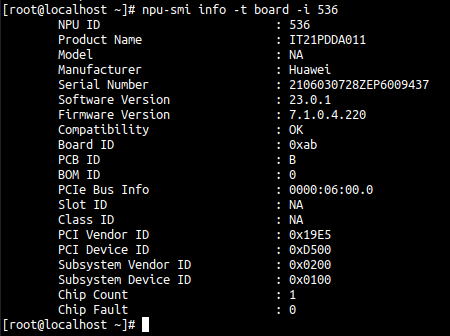

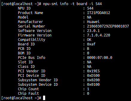

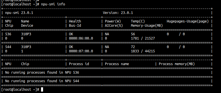

使用npu-smi工具查询pcie卡相关信息:
总共有两张npu卡,第一张的npu chip id为536,第二张的npu chip id为544。
544为300vpro,536为300ipro
查询300vpro的四元组信息:
查询300ipro的四元组信息:
发现两张卡的四元组信息是一致的,是操作问题还是设计本身如此呢,如果四元组信息一致 该如何在bmc测区分这两张卡

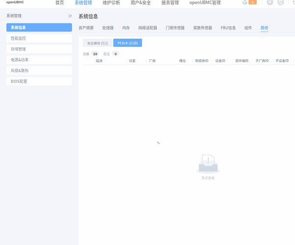

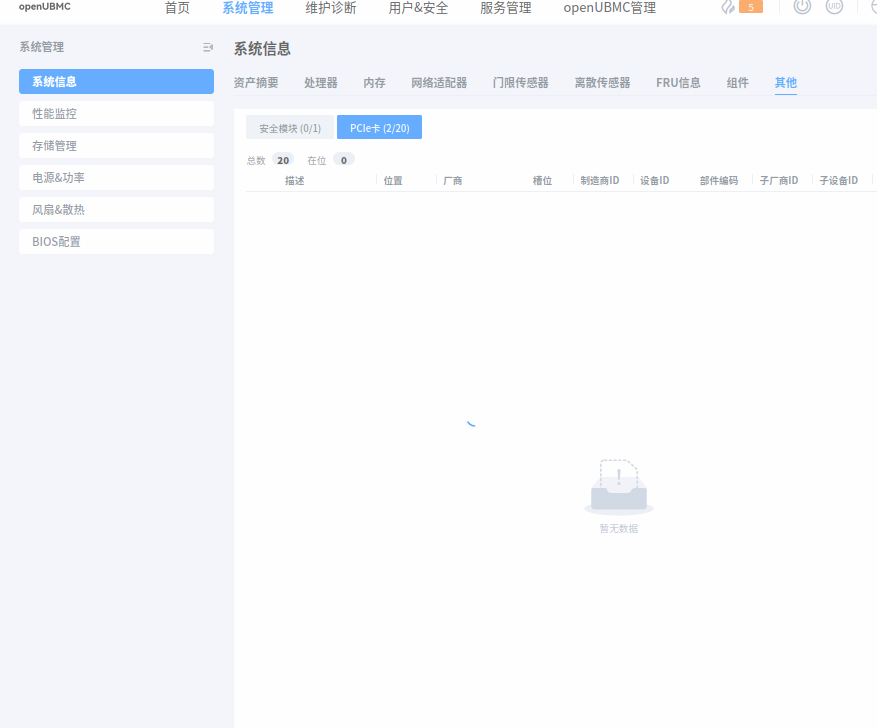

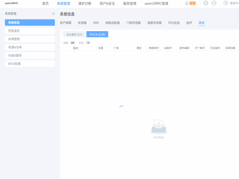

出现的场景:刷BMC包 → 上电OS-> 一开始Pcie卡的状态是(0/20)-> 后面bios加载成功后变为(2/20),点击如下图web页面,转圈圈几分钟。
以下是在转圈圈的时候,我使用 tail -f /var/log/app.log 抓的貌似相关的日志:
2025-08-25 09:18:07.260773 pcie_device ERROR: remote_rp.lua(174): Get object PCIeCard_1_0101010106's reference property Name failed, err: org.freedesktop.DBus.Error.UnknownObject: Unknown object path /bmc/kepler/Systems/1/PCIeDevices/PCIeCards/NPUCards/NPUCard_1_0101010106
2025-08-25 09:18:07.263409 web_backend WARNING: init.lua(574): service[bmc.kepler.web_backend] request timeout: remote service[bmc.kepler.pcie_device], path[/bmc/kepler/Systems/1/PCIeDevices/PCIeCards/PCIeCard_1_0101010106], interface[bmc.kepler.Object.Properties], method[GetWithContext], used time[60s]
2025-08-25 09:18:08.634888 power_strategy ERROR: power_strategy_utils.lua(89): Unhealthy power monitor status
2025-08-25 09:18:12.262747 pcie_device NOTICE: biz_topo.lua(570): [BizTopo] configuration list length: 1, uid: 00000055040139250005 [repeated 4 times in 0s from 2025-08-25 09:12:52.059892 to 2025-08-25 09:12:52.404066][flush]
2025-08-25 09:18:13.204525 network_adapter NOTICE: device_manager.lua(434): get network adapter model for b=124 d=0 f=0. model=CPU Integration
2025-08-25 09:18:21.997324 pcie_device ERROR: remote_rp.lua(174): Get object PCIeCard_1_0101010104's reference property Name failed, err: org.freedesktop.DBus.Error.UnknownObject: Unknown object path /bmc/kepler/Systems/1/PCIeDevices/PCIeCards/NPUCards/NPUCard_1_0101010104
2025-08-25 09:18:21.998796 web_backend WARNING: init.lua(574): service[bmc.kepler.web_backend] request timeout: remote service[bmc.kepler.pcie_device], path[/bmc/kepler/Systems/1/PCIeDevices/PCIeCards/PCIeCard_1_0101010104], interface[bmc.kepler.Object.Properties], method[GetWithContext], used time[60s]
2025-08-25 09:18:22.048557 pcie_device ERROR: remote_rp.lua(174): Get object PCIeCard_1_0101010106's reference property Name failed, err: org.freedesktop.DBus.Error.UnknownObject: Unknown object path /bmc/kepler/Systems/1/PCIeDevices/PCIeCards/NPUCards/NPUCard_1_0101010106
2025-08-25 09:18:22.050126 web_backend WARNING: init.lua(574): service[bmc.kepler.web_backend] request timeout: remote service[bmc.kepler.pcie_device], path[/bmc/kepler/Systems/1/PCIeDevices/PCIeCards/PCIeCard_1_0101010106], interface[bmc.kepler.Object.Properties], method[GetWithContext], used time[60s]
2025-08-25 09:18:26.375258 thermal_mgmt WARNING: init.lua(574): service[unknown] request timeout: remote service[bmc.kepler.pcie_device], path[/bmc/kepler/Systems/1/PCIeDevices/PCIeCards/PCIeCard_1_0101010104], interface[bmc.kepler.Object.Properties], method[GetWithContext], used time[60s]
2025-08-25 09:18:29.688357 network_adapter NOTICE: device_manager.lua(434): get network adapter model for b=124 d=0 f=0. model=CPU Integration
2025-08-25 09:18:48.469877 web_backend WARNING: init.lua(574): service[bmc.kepler.web_backend] request timeout: remote service[bmc.kepler.pcie_device], path[/bmc/kepler/Systems/1/PCIeDevices/PCIeCards/PCIeCard_1_0101010104], interface[bmc.kepler.Object.Properties], method[GetWithContext], used time[60s]
2025-08-25 09:18:48.530441 pcie_device ERROR: remote_rp.lua(174): Get object PCIeCard_1_0101010106's reference property Name failed, err: org.freedesktop.DBus.Error.UnknownObject: Unknown object path /bmc/kepler/Systems/1/PCIeDevices/PCIeCards/NPUCards/NPUCard_1_0101010106
2025-08-25 09:18:48.532361 web_backend WARNING: init.lua(574): service[bmc.kepler.web_backend] request timeout: remote service[bmc.kepler.pcie_device], path[/bmc/kepler/Systems/1/PCIeDevices/PCIeCards/PCIeCard_1_0101010106], interface[bmc.kepler.Object.Properties], method[GetWithContext], used time[60s]
2025-08-25 09:20:19.569438 event NOTICE: object_manage.lua(236): add objects completely, path: /bmc/kepler/ObjectGroup/0101010106, position: 0101010106, life cycle id: 1, took 0ms [repeated 35 times in 185s from 2025-08-25 09:13:53.320080 to 2025-08-25 09:16:58.492166][flush]
2025-08-25 09:20:22.408348 web_backend WARNING: init.lua(574): service[bmc.kepler.web_backend] request timeout: remote service[bmc.kepler.pcie_device], path[/bmc/kepler/Systems/1/PCIeDevices/PCIeCards/PCIeCard_1_0101010106], interface[bmc.kepler.Object.Properties], method[GetWithContext], used time[60s]
