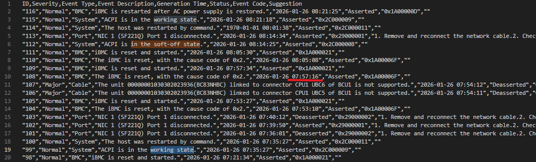

日志1:
日志2:
日志3:
第一次产生:可以看见直接关联的Scanner读值为1。
2026-01-26 07:54:24.326975 sensor NOTICE: sensor_instance.lua(616): BCU1 3V3_RISER2|{“source”:{“properties”:[{“Property”:“Value”,“Service”:“bmc.kepler.hwproxy”,“Interface”:“bmc.kepler.Scanner”,“Path”:“/bmc/kepler/Scanner/Scanner_3v2_010101”},{“Property”:“Value”,“Service”:“bmc.kepler.hwproxy”,“Interface”:“bmc.kepler.Scanner”,“Path”:“/bmc/kepler/Scanner/Scanner_PowerGood_010101”}],“Default”:110,“expressions”:[“expr(($2 == 0) ? 110 : ((($1/20) * 20 * (3.3 * 1.5 / 4096) * (100 / 3)) > 255 ? 110 : (($1/20)* 20 * (3.3 * 1.5 / 4096) * (100 / 3))))”,“expr($1 == 0 ? 110 : $1)”]},“type”:“synchronization”,“value”:[1,1]}
第一次消除,读值为2700:
2026-01-26 07:57:42.165548 sensor NOTICE: sensor_instance.lua(616): BCU1 3V3_RISER2|{“type”:“synchronization”,“source”:{“properties”:[{“Property”:“Value”,“Interface”:“bmc.kepler.Scanner”,“Service”:“bmc.kepler.hwproxy”,“Path”:“/bmc/kepler/Scanner/Scanner_3v2_010101”},{“Property”:“Value”,“Interface”:“bmc.kepler.Scanner”,“Service”:“bmc.kepler.hwproxy”,“Path”:“/bmc/kepler/Scanner/Scanner_PowerGood_010101”}],“Default”:110,“expressions”:[“expr(($2 == 0) ? 110 : ((($1/20) * 20 * (3.3 * 1.5 / 4096) * (100 / 3)) > 255 ? 110 : (($1/20)* 20 * (3.3 * 1.5 / 4096) * (100 / 3))))”,“expr($1 == 0 ? 110 : $1)”]},“value”:[2700,1]}
第二次产生:读值又变为1:
2026-01-26 07:58:28.937361 sensor NOTICE: sel_management.lua(693): add sel[{“SensorId”:“ThresholdSensor_3vRiser2_010101”,“SelEventType”:1,“SensorNumber”:62,“SelMsgVersion”:4,“GenerateId”:32,“Timestamp”:1769414308,“SelType”:2,“RecordId”:70,“SensorType”:2,“SelData1”:82,“RecordSeq”:223,“SelData3”:98,“SelData2”:0,“SubjectName”:“MainBoard”,“SensorName”:“BCU1 3V3_RISER2”}] successfully, record id is 70
第二次消除:读值为0,但是PowerGood寄存器依然为1
2026-01-26 07:58:39.688545 sensor NOTICE: sensor_instance.lua(616): BCU1 3V3_RISER2|{“type”:“synchronization”,“source”:{“properties”:[{“Property”:“Value”,“Interface”:“bmc.kepler.Scanner”,“Service”:“bmc.kepler.hwproxy”,“Path”:“/bmc/kepler/Scanner/Scanner_3v2_010101”},{“Property”:“Value”,“Interface”:“bmc.kepler.Scanner”,“Service”:“bmc.kepler.hwproxy”,“Path”:“/bmc/kepler/Scanner/Scanner_PowerGood_010101”}],“Default”:110,“expressions”:[“expr(($2 == 0) ? 110 : ((($1/20) * 20 * (3.3 * 1.5 / 4096) * (100 / 3)) > 255 ? 110 : (($1/20)* 20 * (3.3 * 1.5 / 4096) * (100 / 3))))”,“expr($1 == 0 ? 110 : $1)”]},“value”:[0,1]}

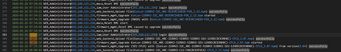

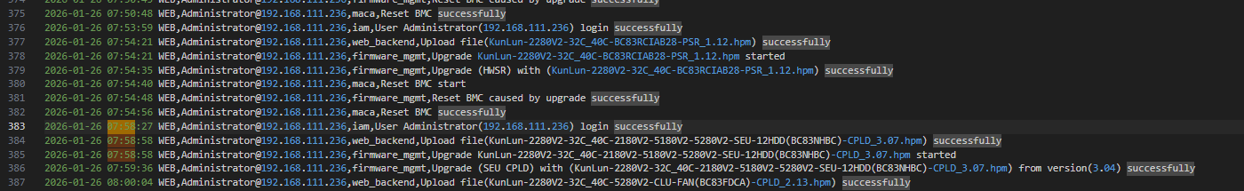

读值为0是电压为0,按理说可以认为是下电状态。但是此时实际是上电状态,最接近的只有BMC重启的动作,按理说不应该对电压读值产生影响。
时间点附近的动作为升级PSR与CPLD。
