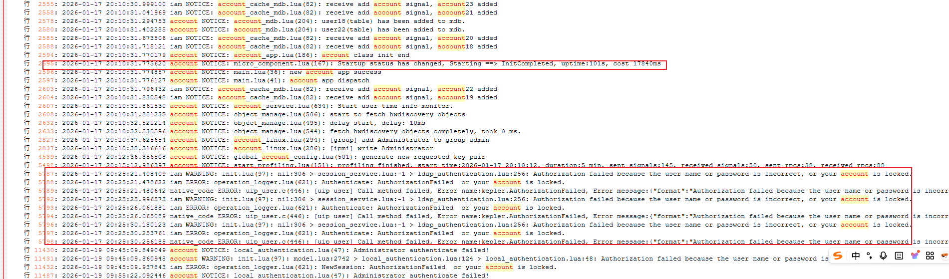

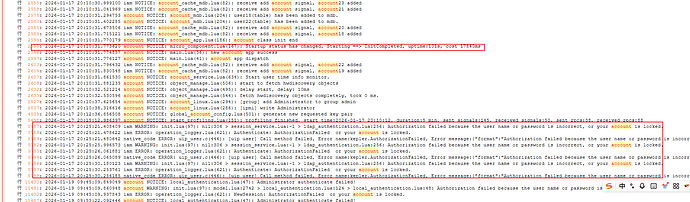

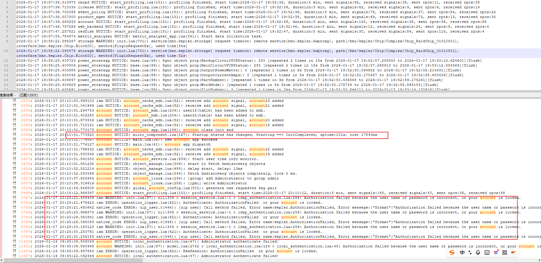

可以查看下app.log里 account组件启动时间和ssh登录时间的差异。
可以看到在登录前account已经启动完成了:
关键日志:
2026-01-17 20:25:21.407913 iam ERROR: ldap_authentication.lua(255): Administrator ldap authenticate failed!
2026-01-17 20:25:21.408409 iam WARNING: init.lua(97): nil:306 > session_service.lua:-1 > ldap_authentication.lua:256: Authorization failed because the user name or password is incorrect, or your account is locked.
2026-01-17 20:25:21.478622 iam ERROR: operation_logger.lua(621): Authenticate: AuthorizationFailed or your account is locked.
2026-01-17 20:25:21.480642 native_code ERROR: uip_user.c(446): [uip user] Call method failed, Error name:kepler.AuthorizationFailed, Error message:{“format”:“Authorization failed because the user name or password is incorrect, or your account is locked.”,“name”:“AuthorizationFailed”,“registry_prefix”:“openUBMC”}.
2026-01-17 20:25:21.597532 network_adapter NOTICE: network_adapter.lua(1449): [network_adapter] update FirmwareVersion successfully, name:PCIeCard8(SP681), FirmwareVersion:15.7.8.1
2026-01-17 20:25:25.996109 iam ERROR: ldap_authentication.lua(255): Administrator ldap authenticate failed!
2026-01-17 20:25:25.996573 iam WARNING: init.lua(97): nil:306 > session_service.lua:-1 > ldap_authentication.lua:256: Authorization failed because the user name or password is incorrect, or your account is locked.
2026-01-17 20:25:26.061881 iam ERROR: operation_logger.lua(621): Authenticate: AuthorizationFailed or your account is locked.
2026-01-17 20:25:26.065089 native_code ERROR: uip_user.c(446): [uip user] Call method failed, Error name:kepler.AuthorizationFailed, Error message:{“format”:“Authorization failed because the user name or password is incorrect, or your account is locked.”,“name”:“AuthorizationFailed”,“registry_prefix”:“openUBMC”}.
2026-01-17 20:25:30.179629 iam ERROR: ldap_authentication.lua(255): Administrator ldap authenticate failed!
2026-01-17 20:25:30.180123 iam WARNING: init.lua(97): nil:306 > session_service.lua:-1 > ldap_authentication.lua:256: Authorization failed because the user name or password is incorrect, or your account is locked.
2026-01-17 20:25:30.253761 iam ERROR: operation_logger.lua(621): Authenticate: AuthorizationFailed or your account is locked.
2026-01-17 20:25:30.256185 native_code ERROR: uip_user.c(446): [uip user] Call method failed, Error name:kepler.AuthorizationFailed, Error message:{“format”:“Authorization failed because the user name or password is incorrect, or your account is locked.”,“name”:“AuthorizationFailed”,“registry_prefix”:“openUBMC”}.
通过日志可以看到account组件已经起来了,但是仍然登录失败

这个日志跟截图里显示的日志不一致。 请提供准确的日志文件。
日志文件中app.log 对应时间点的日志如下:
2026-01-17 20:24:35.535590 bmc_network ERROR: network_init.lua(121): get local link failed [repeated 30 times in 301s from 2026-01-17 20:19:34.661719 to 2026-01-17 20:24:35.535590]
2026-01-17 20:24:35.537948 bmc_network ERROR: object.lua(526): [save_all_objs] save class [Ipv6] objects failed, ./opt/bmc/libmc/lualib/database/row.lua:138: NOT NULL constraint failed: t_network_ipv6.Id [repeated 30 times in 301s from 2026-01-17 20:19:34.663202 to 2026-01-17 20:24:35.537948]
2026-01-17 20:24:42.722273 storage ERROR: nvme_object.lua(702): update ResourceId failed!
2026-01-17 20:26:43.016540 storage ERROR: nvme_object.lua(702): update ResourceId failed!
2026-01-17 20:28:43.268962 storage ERROR: nvme_object.lua(702): update ResourceId failed!
我们这边测试复现了多次,这份日志就是复现问题的一键收集,可能截图是另外复现的,就看这个日志文件吧,问题现象都一样的
从日志看没看出来是什么原因导致的。 这块代码在account仓库的libiam目录, 你也可以看看逻辑。
