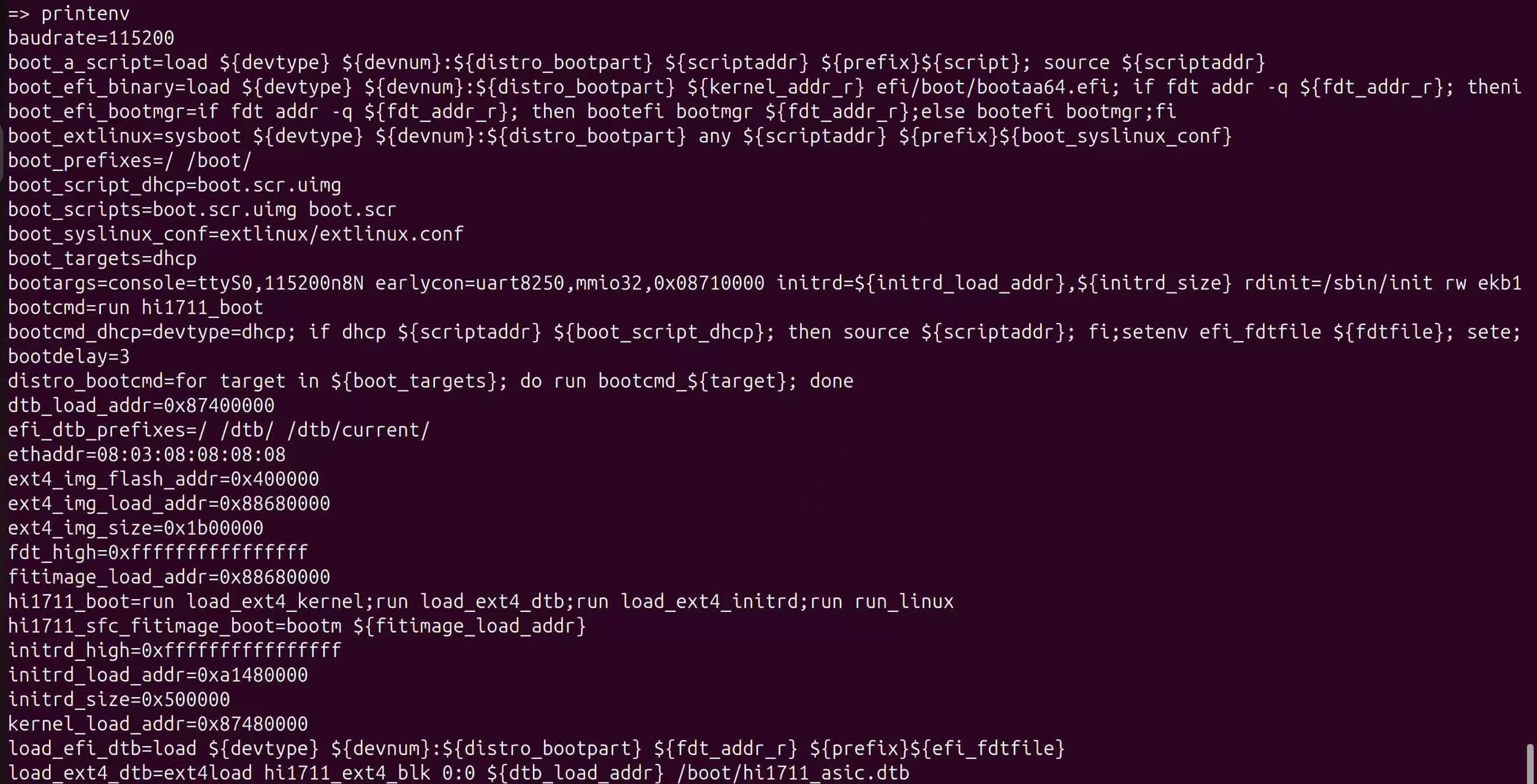

以下是当前uboot的环境

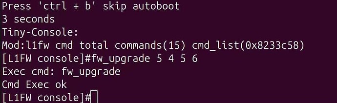

=> fw_upgrade 5 4 5 6
Unknown command ‘fw_upgrade’ - try ‘help’
我当前环境下的uboot没有这个切换分区的命令

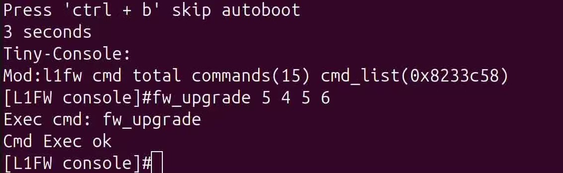

可以试试:
Uboot下敲reg_wr 0x8740148 1
之后再ctrl b进入L1
fw_upgrade 5 4 5 6(后面456是分别指/dev/mmcblk0gp0 /dev/mmcblk0gp1 /dev/mmcblk0gp2)
boot_a55
按照您的方法,进入L1后执行fw_upgrade,结果如下:

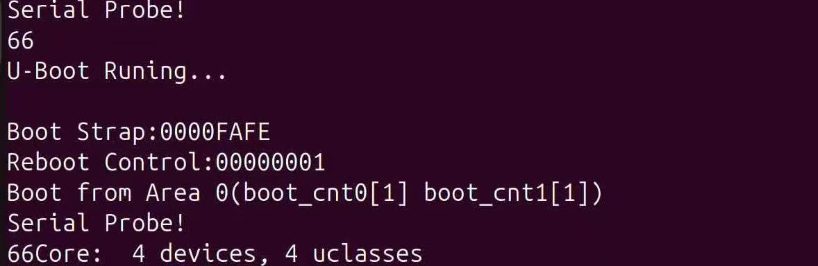

再执行boot_a55后,打引如下:
依然是从area0启动的哎,启动之后在操作系统更改密码,依然无法ssh登陆
4 5 6就是从0开始启动的,换成645试试
感谢,这边改成645就是备区启动了

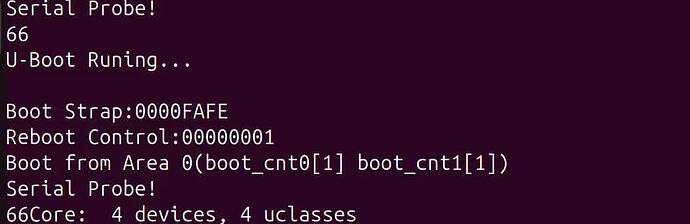

您好,我按照您的流程改成了
您好,我的硬件是1711,尝试了指令fw_upgrade 5 4 5 6和fw_upgrade 5 6 4 5启动都是从Area 0启动的,这是什么原因?

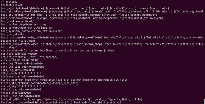

我的uboot下printenv如下:

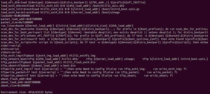

=> printenv
baudrate=115200
boot_a_script=load ${devtype} ${devnum}:${distro_bootpart} ${scriptaddr} ${prefix}${script}; source ${scriptaddr}
boot_efi_binary=load ${devtype} ${devnum}:${distro_bootpart} ${kernel_addr_r} efi/boot/bootaa64.efi; if fdt addr -q ${fdt_addr_r}; then bootefi ${kernel_addr_r} ${fdt_addr_r};else bootefi ${kernel_addr_r} ${fdtcontroladdr};fi
boot_efi_bootmgr=if fdt addr -q ${fdt_addr_r}; then bootefi bootmgr ${fdt_addr_r};else bootefi bootmgr;fi
boot_extlinux=sysboot ${devtype} ${devnum}:${distro_bootpart} any ${scriptaddr} ${prefix}${boot_syslinux_conf}
boot_prefixes=/ /boot/
boot_script_dhcp=boot.scr.uimg
boot_scripts=boot.scr.uimg boot.scr
boot_syslinux_conf=extlinux/extlinux.conf
boot_targets=dhcp
bootargs=console=ttyS0,115200n8N earlycon=uart8250,mmio32,0x08710000 initrd=${initrd_load_addr},${initrd_size} rdinit=/sbin/init rw ekbox=0x20000$0x84be0000 kbox_mem=0x2e0000@0x84900000 swift_irqsoff_enable swxn=1
bootcmd=run hi1711_boot
bootcmd_dhcp=devtype=dhcp; if dhcp ${scriptaddr} ${boot_script_dhcp}; then source ${scriptaddr}; fi;setenv efi_fdtfile ${fdtfile}; setenv efi_old_vci ${bootp_vci};setenv efi_old_arch ${bootp_arch};setenv bootp_vci PXEClient:Arch:00011:UNDI:003000;setenv bootp_arch 0xb;if dhcp ${kernel_addr_r}; then tftpboot ${fdt_addr_r} dtb/${efi_fdtfile};if fdt addr -q ${fdt_addr_r}; then bootefi ${kernel_addr_r} ${fdt_addr_r}; else bootefi ${kernel_addr_r} ${fdtcontroladdr};fi;fi;setenv bootp_vci ${efi_old_vci};setenv bootp_arch ${efi_old_arch};setenv efi_fdtfile;setenv efi_old_arch;setenv efi_old_vci;
bootdelay=3
distro_bootcmd=for target in ${boot_targets}; do run bootcmd_${target}; done
dtb_load_addr=0x87400000
efi_dtb_prefixes=/ /dtb/ /dtb/current/
ethaddr=08:03:08:08:08:08
ext4_img_flash_addr=0x400000
ext4_img_load_addr=0x88680000
ext4_img_size=0x1b00000
fdt_high=0xffffffffffffffff
fitimage_load_addr=0x88680000
hi1711_boot=run load_ext4_kernel;run load_ext4_dtb;run load_ext4_initrd;run run_linux
hi1711_sfc_fitimage_boot=bootm ${fitimage_load_addr}
initrd_high=0xffffffffffffffff
initrd_load_addr=0xa1480000
initrd_size=0x500000
kernel_load_addr=0x87480000
load_efi_dtb=load ${devtype} ${devnum}:${distro_bootpart} ${fdt_addr_r} ${prefix}${efi_fdtfile}
load_ext4_dtb=ext4load hi1711_ext4_blk 0:0 ${dtb_load_addr} /boot/hi1711_asic.dtb
load_ext4_initrd=ext4load hi1711_ext4_blk 0:0 ${initrd_load_addr} /boot/initrd_boot.cpio.gz
load_ext4_kernel=ext4load hi1711_ext4_blk 0:0 ${kernel_load_addr} /boot/uImage
loadaddr=0x8B200000
packet_load_addr=0x87200000
packet_size=0x7c00000
run_linux=bootm ${kernel_load_addr} ${initrd_load_addr}:${initrd_size} ${dtb_load_addr}
scan_dev_for_boot=echo Scanning ${devtype} ${devnum}:${distro_bootpart}…; for prefix in ${boot_prefixes}; do run scan_dev_for_extlinux; run scan_dev_for_scripts; done;run scan_dev_for_efi;
scan_dev_for_boot_part=part list ${devtype} ${devnum} -bootable devplist; env exists devplist || setenv devplist 1; for distro_bootpart in ${devplist}; do if fstype ${devtype} ${devnum}:${distro_bootpart} bootfstype; then part uuid ${devtype} ${devnum}:${distro_bootpart} distro_bootpart_uuid ; run scan_dev_for_boot; fi; done; setenv devplist
scan_dev_for_efi=setenv efi_fdtfile ${fdtfile}; for prefix in ${efi_dtb_prefixes}; do if test -e ${devtype} ${devnum}:${distro_bootpart} ${prefix}${efi_fdtfile}; then run load_efi_dtb; fi;done;run boot_efi_bootmgr;if test -e ${devtype} ${devnum}:${distro_bootpart} efi/boot/bootaa64.efi; then echo Found EFI removable media binary efi/boot/bootaa64.efi; run boot_efi_binary; echo EFI LOAD FAILED: continuing…; fi; setenv efi_fdtfile
scan_dev_for_extlinux=if test -e ${devtype} ${devnum}:${distro_bootpart} ${prefix}${boot_syslinux_conf}; then echo Found ${prefix}${boot_syslinux_conf}; run boot_extlinux; echo EXTLINUX FAILED: continuing…; fi
scan_dev_for_scripts=for script in ${boot_scripts}; do if test -e ${devtype} ${devnum}:${distro_bootpart} ${prefix}${script}; then echo Found U-Boot script ${prefix}${script}; run boot_a_script; echo SCRIPT FAILED: continuing…; fi; done
stderr=serial
stdin=serial
stdout=serial
tftp_ext4_img=tftpboot ${ext4_img_load_addr} Hi1711_ext4fs.img
tftp_network_boot=tftp ${dtb_load_addr} hi1711.dtb; tftp ${kernel_load_addr} uImage; tftp ${initrd_load_addr} initrd_boot.cpio.gz; bootm ${kernel_load_addr} ${initrd_load_addr} : ${initrd_size} ${dtb_load_addr}
tftp_packet=tftpboot ${packet_load_addr} Hi1711_flash_ext4.bin
tftp_uboot=tftpboot ${uboot_load_addr} u-boot.bin
tftpwrite_ext4_img=if test ${serverip} = “”;then echo Need to config IP;else run tftp_ext4_img; run write_ext4_img; fi
tftpwrite_packet=if test ${serverip} = “”;then echo Need to config IP;else run tftp_packet; run write_packet; fi
tftpwrite_uboot=if test ${serverip} = “”;then echo Need to config IP;else run tftp_uboot; run write_uboot; fi
uboot_flash_addr=0x0
uboot_load_addr=0x87200000
uboot_size=0x100000
Environment size: 4916/65532 bytes
