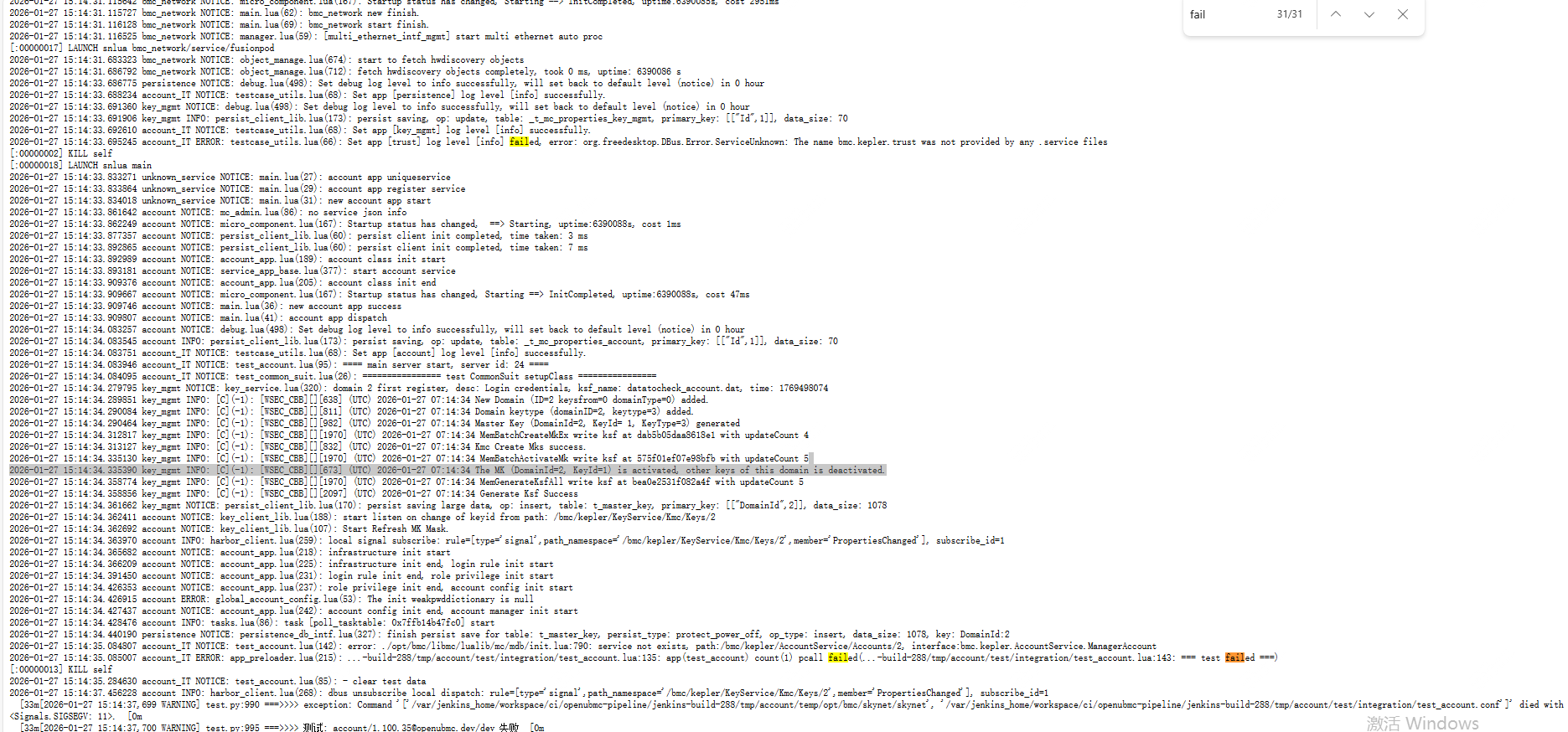

account组件本地IT失败
account组件:1.100.34
代码上库时IT报错
已排除和我的代码修改有关系的可能
分别报错了:
2026-01-27 15:14:33.692610 account_IT NOTICE: testcase_utils.lua(68): Set app [key_mgmt] log level [info] successfully.
2026-01-27 15:14:33.695245 account_IT ERROR: testcase_utils.lua(66): Set app [trust] log level [info] failed, error: org.freedesktop.DBus.Error.ServiceUnknown: The name bmc.kepler.trust was not provided by any .service files
[:00000002] KILL self
[:00000018] LAUNCH snlua main
和
2026-01-27 15:14:35.084807 account_IT NOTICE: test_account.lua(142): error: ./opt/bmc/libmc/lualib/mc/mdb/init.lua:790: service not exists, path:/bmc/kepler/AccountService/Accounts/2, interface:bmc.kepler.AccountService.ManagerAccount
2026-01-27 15:14:35.085007 account_IT ERROR: app_preloader.lua(215): ...-build-288/tmp/account/test/integration/test_account.lua:135: app(test_account) count(1) pcall failed(...-build-288/tmp/account/test/integration/test_account.lua:143: === test failed ===)
[:00000013] KILL self
2026-01-27 15:14:35.284630 account_IT NOTICE: test_account.lua(85): - clear test data
2026-01-27 15:14:37.456228 account INFO: harbor_client.lua(268): dbus unsubscribe local dispatch: rule=[type='signal',path_namespace='/bmc/kepler/KeyService/Kmc/Keys/2',member='PropertiesChanged'], subscribe_id=1
e[33m[2026-01-27 15:14:37,699 WARNING] test.py:990 ===>>>> exception: Command '['/var/jenkins_home/workspace/ci/openubmc-pipeline/jenkins-build-288/tmp/account/temp/opt/bmc/skynet/skynet', '/var/jenkins_home/workspace/ci/openubmc-pipeline/jenkins-build-288/tmp/account/test/integration/test_account.conf']' died with <Signals.SIGSEGV: 11>.e[0m
e[33m[2026-01-27 15:14:37,700 WARNING] test.py:995 ===>>>> 测试: account/1.100.35@openubmc.dev/dev 失败e[0m
这是什么原因呢?
我本地想复现这个问题

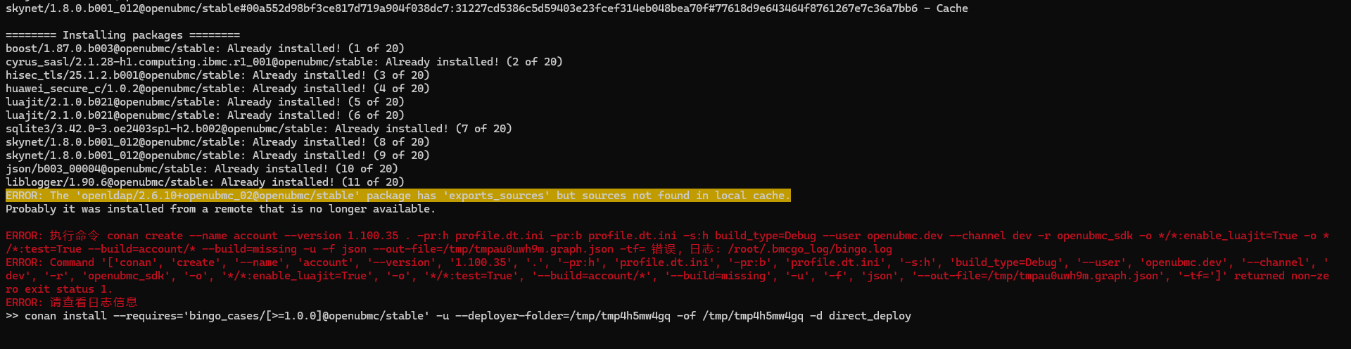

报错ERROR: The ‘openldap/2.6.10+openubmc_02@openubmc/stable’ package has ‘exports_sources’ but sources not found in local cache.
是我用错conan remote了么

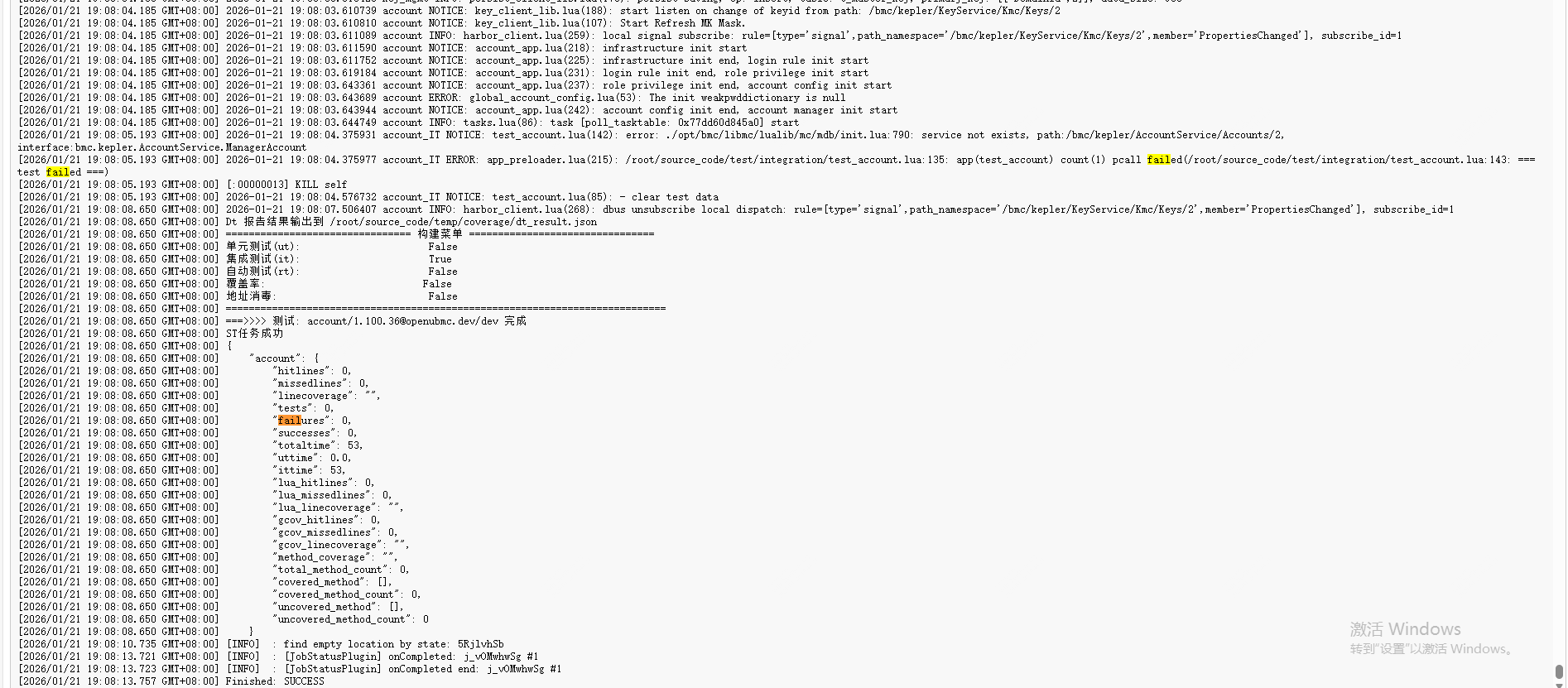

在社区account仓库最新一条pr的IT中发现
fix:修复account与libmc4lua老版本不匹配启动失败的问题-account-AtomGit | GitCode
也是报错trust日志级别设置失败,和找不到2号用户的资源树path
执行conan remove openldap/2.6.10+openubmc_02@openubmc/stable -c 清空本来缓存,再试下。
你看下IT日志里使用的libmc4lua版本是多少
libmc4lua/1.100.73
我看最新的日志是成功的,只是覆盖率不够。
可能是偶现性失败。 你重试几次看看。
发帖之前我看过社区account组件合入pr的it记录,确实是偶现的,但是这个问题得解决吧,不能寄希望于重试
IT测试依赖其他app和服务,存在很多偶发性问题,规划后续彻底解决。 也欢迎您进行定位和修复 :brown_heart:。
