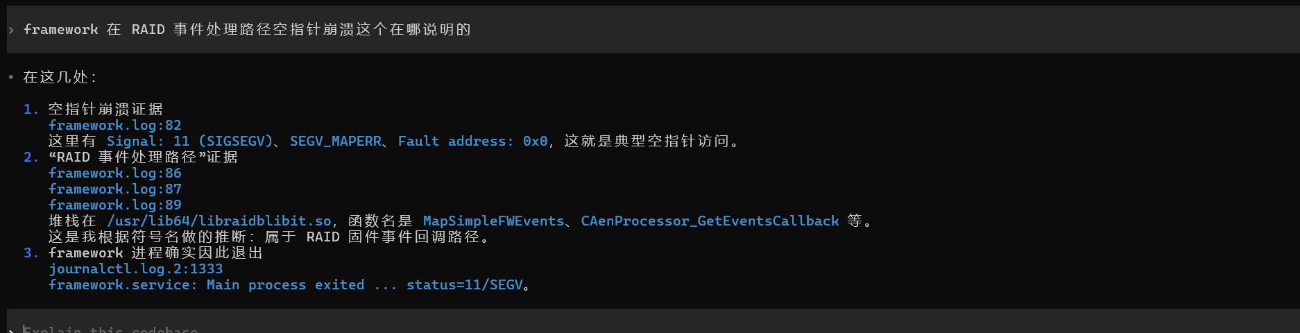

2026-03-03 17:52:35.708589 framework ERROR: l_sig_handler.c(350): ========== FATAL SIGNAL CAUGHT ========== PackageBuildTime: 20260303063950 PID: 6363, PPID: 1 Program: framework Signal: 11 (SIGSEGV) - Segmentation violation Signal code: 1 (SEGV_MAPERR - Address not mapped to object) Sending PID: 0 Fault address: 0x0 ========== END OF CRASH REPORT ==========
2026-03-03 17:52:35.710161 framework ERROR: l_sig_handler.c(310): === Stack Backtrace ===
2026-03-03 17:52:35.710440 framework ERROR: l_sig_handler.c(310): core-info-skynet-11-framework-20260303063950
2026-03-03 17:52:35.711630 framework ERROR: l_sig_handler.c(310): === Source Code Backtrace ===
2026-03-03 17:52:35.712578 framework ERROR: l_sig_handler.c(310): [0] /usr/lib64/libraidblibit.so(FillMrPdAddressArgs+0x254) [0xffff5a3495dc]
2026-03-03 17:52:35.713006 framework ERROR: l_sig_handler.c(310): [1] /usr/lib64/libraidblibit.so(MapSimpleFWEvents+0x4d0) [0xffff5a34a008]
2026-03-03 17:52:35.713830 framework ERROR: l_sig_handler.c(310): [2] /usr/lib64/libraidblibit.so(MapSimpleFWEventsWithMutex+0x54) [0xffff5a34ab40]
2026-03-03 17:52:35.714202 framework ERROR: l_sig_handler.c(310): [3] /usr/lib64/libraidblibit.so(CAenProcessor_GetEventsCallback+0xa20) [0xffff5a331de0]
2026-03-03 17:52:35.714997 framework ERROR: l_sig_handler.c(310): [4] /usr/lib64/libraidblibit.so(EventThreadProc+0x14) [0xffff5a3166e8]
2026-03-03 17:52:35.715937 framework ERROR: l_sig_handler.c(310): [5] /lib64/libc.so.6(+0x824b4) [0xffff917384b4]
2026-03-03 17:52:35.716333 framework ERROR: l_sig_handler.c(310): [6] /lib64/libc.so.6(+0xf0f5c) [0xffff917a6f5c]

在服务器AC(上电-断电循环)测试过程中,系统因9500 RAID/HBA卡引发的空指针访问错误导致BMC框架进程异常崩溃(SIGSEGV信号),造成BMC启动失败,表现为:
  • BMC页面无法登录
  • telnet与ssh仍可连接,说明部分底层服务仍在运行
  • framework进程因段错误(Segmentation violation)而崩溃
  • 故障地址为0x0,确认为空指针解引用问题
故障现象与日志分析
从提供的日志信息中可提取关键线索:
Fault address: 0x0
堆栈回溯分析
关键的调用栈如下(从底层向顶层):
  1. EventThreadProc → RAID卡事件处理线程入口
  2. CAenProcessor_GetEventsCallback → RAID卡固件事件回调函数
  3. MapSimpleFWEventsWithMutex → 带锁的事件映射处理
  4. MapSimpleFWEvents → 事件解析主函数
  5. FillMrPdAddressArgs + 0x254空指针发生的具体位置
最终故障发生在函数 FillMrPdAddressArgs 中对空指针的访问。

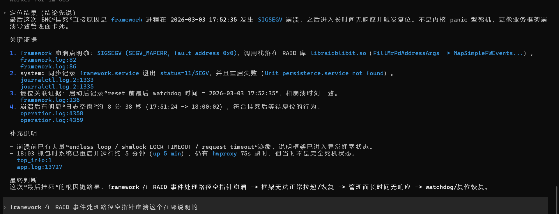

根因定位
1. 直接原因
libraidblibit.so 库中的 FillMrPdAddressArgs 函数存在未校验入参指针有效性的问题,在9500 HBA卡初始化不完整或未就绪时,传入了空指针,最终触发非法内存访问,导致BMC主进程 framework 崩溃。
2. 触发条件
  • AC Power Cycle(上下电)测试 中,BMC启动时尝试初始化RAID/HBA卡驱动。
  • 9500 HBA卡尚未完成硬件或固件初始化,但BMC已尝试与其通信。
  • 驱动层 libraidblibit.so 在获取设备状态或事件回调时,未能正确处理空状态对象,直接使用了NULL指针。

FillMrPdAddressArgs
代码里没搜到这个函数,用的是同一个storelibit库吗
使用的是7.29版本的storelib库代码,加上了其他一些代码合入,目前解决空指针后未出现卡死问题
“目前解决空指针后未出现卡死问题”,请问是已经解决了吗?没有的话可以解下环境上的coredump文件看看具体是在哪里coredump
