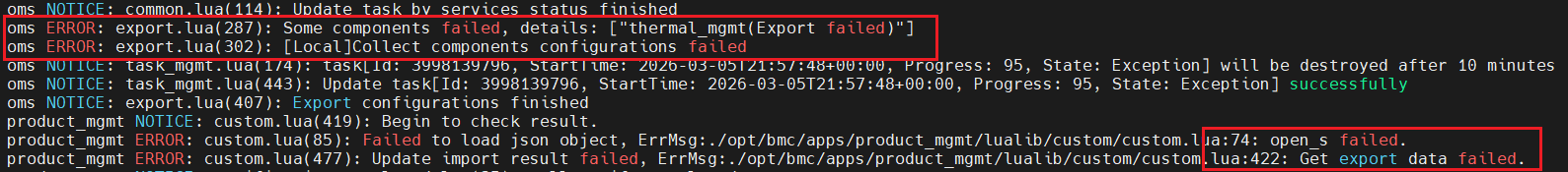

  1. 执行空定制化的时候,app日志报错如下:

2026-03-07 16:42:06.595441 oms ERROR: export.lua(204): Export service(thermal_mgmt) config failed, ret: ...mc/apps/oms/lualib/config/import_export/data_process.lua:103: attempt to index a nil value.
2026-03-07 16:42:07.696523 oms ERROR: export.lua(287): Some components failed, details: ["thermal_mgmt(Export failed)"]

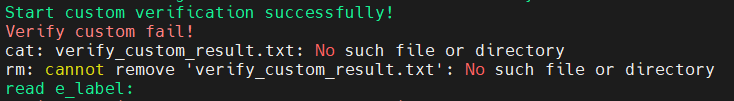

  2. 执行校验脚本:
    ./XXX_verify.sh a.ini b.ini
    → 输出:
    Start custom verification successfully!
    Verify custom fail!

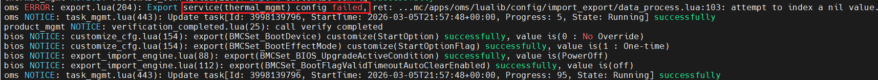

  3. 查看日志,核心报错为:

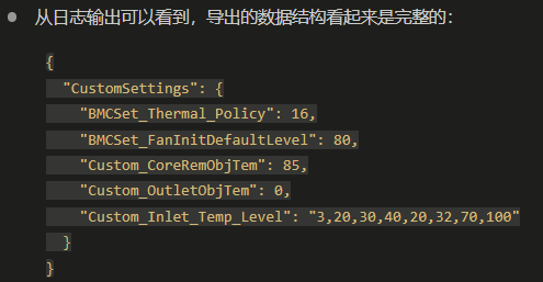

1. thermal_mgmt 日志看:导出逻辑已执行成功
customize_config.lua 中添加打印后,可见以下输出:
thermal_mgmt NOTICE: customize_config.lua(219): Export customize config successfully
thermal_mgmt NOTICE: server.lua(73): Export data [
    "CustomSettings": {
      "BMCSet_Thermal_Policy": 16,
      "BMCSet_FanInitDefaultLevel": 80,
      "Custom_CoreRemObjTem": 85,
      "Custom_OutletObjTem": 0,
      "Custom_Inlet_Temp_Level": "3,20,30,40,20,32,70,100"
:white_check_mark: 这说明 thermal_mgmt 组件内部导出逻辑已完成,并返回了结构化数据。
2. 从 OMS 日志看:框架层处理异常
然而,在 OMS 主服务中报错:
ERROR: export.lua(204): Export service(thermal_mgmt) config failed, ret: ...data_process.lua:103: attempt to index a nil value
