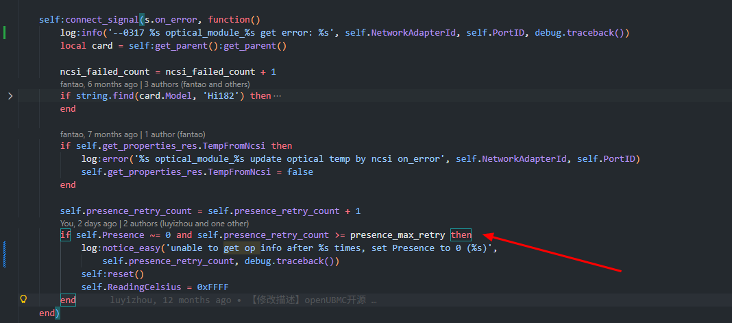

2026-03-14 21:15:38.961288 network_adapter ERROR: optical_module.lua(319): PCIeCard1(BCM957508-P2100G) optical_module_1 update optical temp by ncsi on_error [repeated 4 times in 243s from 2026-03-14 21:10:11.396496 to 2026-03-14 21:14:14.024439][flush]
2026-03-14 21:15:38.961491 network_adapter ERROR: optical_module.lua(319): PCIeCard1(BCM957508-P2100G) optical_module_0 update optical temp by ncsi on_error [repeated 4 times in 256s from 2026-03-14 21:09:58.462459 to 2026-03-14 21:14:14.184955][flush]
2026-03-14 21:15:38.961599 network_adapter NOTICE: optical_module.lua(325): unable to get op info after 3 times, set Presence to 0 (stack traceback:  ...s/network_adapter/lualib/device/class/optical_module.lua:326: in function <...s/network_adapter/lualib/device/class/optical_module.lua:300>  [C]: in function 'pcall'  ./opt/bmc/libmc/lualib/mc/signal.lua:93: in function 'run_slot'  ./opt/bmc/libmc/lualib/mc/signal.lua:113: in function <./opt/bmc/libmc/lualib/mc/signal.lua:103>  [C]: in function 'pcall'  ./opt/bmc/libmc/lualib/mc/signal.lua:293: in function 'emit'  ./opt/bmc/lualib/libmgmt_protocol/transport/scheduler.lua:43: in function ''  /opt/bmc/skynet/lualib/skynet.lua: in function </opt/bmc/skynet/lualib/skynet.lua:0>  [builtin#21]: at 0xffffb09f2d28  [C]: in function 'pcall'  ./opt/bmc/libmc/lualib/mc/context.lua:212: in function 'with_context'  ./opt/bmc/libmc/lualib/mc/app_preloader.lua:97: in function ''  /opt/bmc/skynet/lualib/skynet.lua: in function </opt/bmc/skynet/lualib/skynet.lua:0>) [repeated 8 times in 256s from 2026-03-14 21:09:58.464853 to 2026-03-14 21:14:14.186262][flush]
