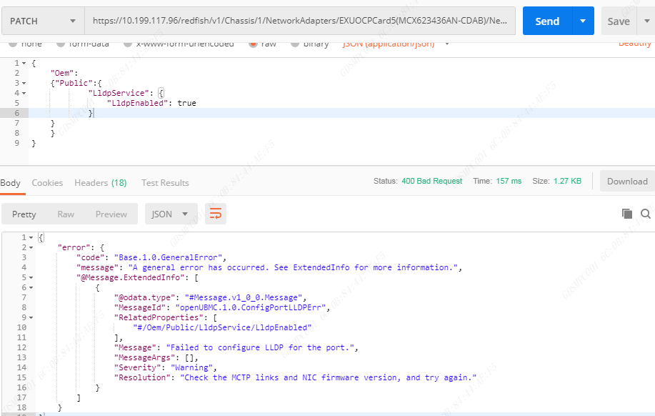

1、通过postman执行patch操作修改网口lldp使能状态,URL:https://ip//redfish/v1/Chassis/1/NetworkAdapters/EXUOCPCard5(MCX623436AN-CDAB)/NetworkPorts/1
   Body内容:
	"Oem":
        "Public":
            "LldpService":
                "LldpEnabled": true
2、查看redfish响应信息,返回码为400,message:failed to configure LLDP for the port。

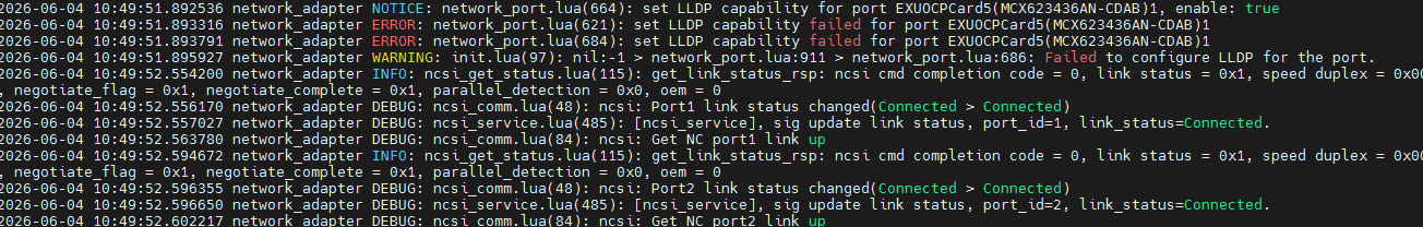

3、查看日志文件app.log,有如下打印:
2026-06-04 10:49:51.892536 network_adapter NOTICE: network_port.lua(664): set LLDP capability for port EXUOCPCard5(MCX623436AN-CDAB)1, enable: true
2026-06-04 10:49:51.893316 network_adapter ERROR: network_port.lua(621): set LLDP capability failed for port EXUOCPCard5(MCX623436AN-CDAB)1
2026-06-04 10:49:51.893791 network_adapter ERROR: network_port.lua(684): set LLDP capability failed for port EXUOCPCard5(MCX623436AN-CDAB)1
2026-06-04 10:49:51.895927 network_adapter WARNING: init.lua(97): nil:-1 > network_port.lua:911 > network_port.lua:686: Failed to configure LLDP for the port.
