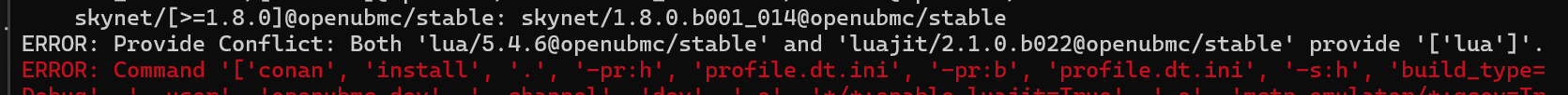

bingo test -ut -cov 在 Conan install / dependency resolution 阶段失败,关键报错如下:
ERROR: Provide Conflict: Both 'lua/5.4.6@openubmc/stable' and 'luajit/2.1.0.b022@openubmc/stable' provide '['lua']'.
ERROR: Command '['conan', 'install', '.', '-pr:h', 'profile.dt.ini', '-pr:b', 'profile.dt.ini', '-s:h', 'build_type=Debug', '--user', 'openubmc.dev', '--channel', 'dev', '-o', '*/*:enable_luajit=True', '-o', 'mctp_emulator/*:gcov=True', '-o', '*/*:test=True', '-of=/root/mctp_emulator/temp/.deploy/.install', '-d=full_deploy', '-f', 'json', '--out-file=package.info.json', '--build=missing']' returned non-zero exit status 1.
