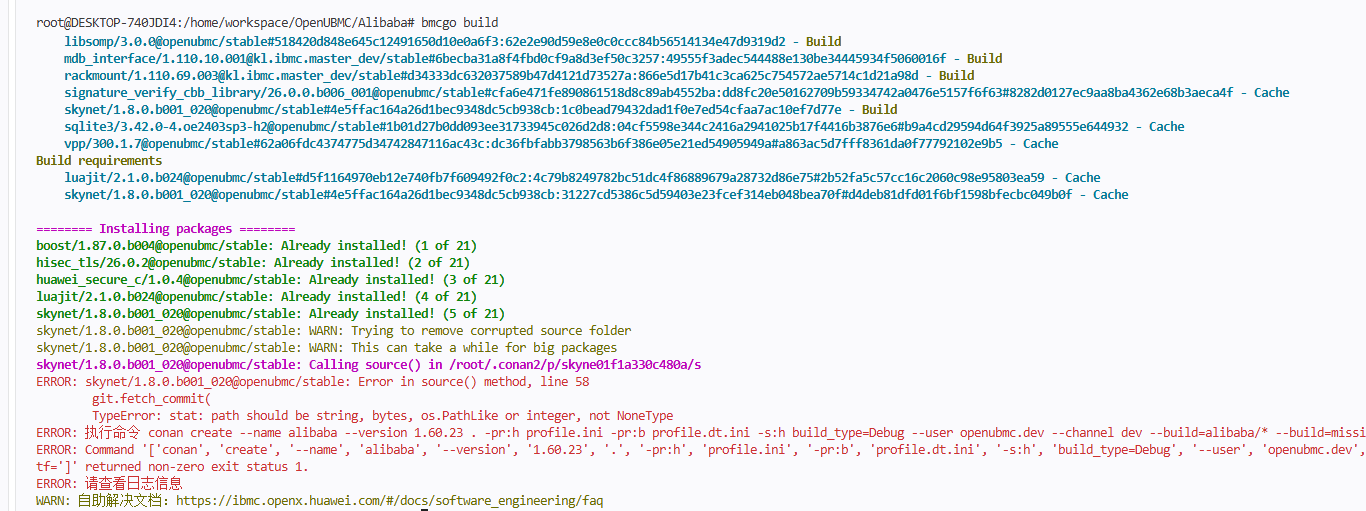

在定制仓组件下进行bmcgo build -jit 编译时报错 bingo命令错误或产品与平台版
root@DESKTOP-740JDI4:/home/workspace/OpenUBMC/Alibaba# bmcgo build -jit
whoami

导入模块 full_component 失败
============== 组件 mds schema 校验开始 ==============
WARN: 文件 /home/workspace/OpenUBMC/Alibaba/mds/schema.json 配置的 https://json-schema.org/draft/2019-09/schema# 为外部schema, 跳过检查
WARN: >>>>>> /home/workspace/OpenUBMC/Alibaba/mds/model.json 校验失败 <<<<<<
Unevaluated properties are not allowed (‘readOnly’ was unexpected)

On instance[‘SensorCategory’][‘properties’][‘Value’]:
{‘usage’: [‘CSR’],
‘baseType’: ‘Double’,
‘readOnly’: True,
‘description’: ‘传感器真实读数’}

On instance[‘cmds’][‘SetVncPassword’][‘req’][2]:
{‘data’: ‘Password’,
‘baseType’: ‘String’,
‘len’: ‘*’,
‘minLength’: 1,
‘maxLength’: 32}
ERROR: >>>>>> /home/workspace/OpenUBMC/Alibaba/mds/service.json 校验失败 <<<<<<
‘version’ is a required property
Failed validating ‘required’ in schema[‘properties’][‘codegen_policy’]:
{‘description’: ‘组件代码生成策略, 代码生成工具将基于生成策略指定的版本等信息生成配套的代码’,
‘type’: ‘object’,
‘required’: [‘version’],
‘properties’: {‘version’: {‘description’: '使用的codegen版本, ’
‘可以使用精准版本或大于等于最低版本’,
‘anyOf’: [{‘type’: ‘string’,
‘pattern’: ‘^(>=)?[0-9]+$’},
{‘type’: ‘integer’}]}}}
On instance[‘codegen_policy’]:
{‘Version’: 15}
ERROR: 请仔细阅读报错日志, 日志中会提示哪些是必要属性, 或哪个属性配置错误
mds schema 校验结果不通过
错误信息:所有 .yml/.yaml 文件检查失败, 请仔细检查报错并解决问题项
============== csr schema 校验开始 =============
WARN: >>>>>> /home/workspace/OpenUBMC/Alibaba/sr/platform_cust.sr 校验失败 <<<<<<
1.0 is not of type ‘string’
Failed validating ‘type’ in schema[‘properties’][‘FormatVersion’]:
{‘type’: ‘string’, ‘description’: ‘格式版本,表示CSR数据格式及整体结构’}
On instance[‘FormatVersion’]:
1.0
WARN: >>>>>> /home/workspace/OpenUBMC/Alibaba/sr/14100513_Sensor_0_cust.sr 校验失败 <<<<<<
3.0 is not of type ‘string’

Connecting to remote ‘master_dev’ with user ‘openubmc’
Connecting to remote ‘br_release_bytedance_kunlun2280v3_6.0.6’ with user ‘openubmc’
Connecting to remote ‘br_develop_KunLun5290TXV2_6.0.0’ with user ‘openubmc’
alibaba/1.60.23@openubmc.dev/dev: Forced build from source

boost/1.87.0.b004@openubmc/stable#474a998ecff6a2c2fe44673ef3174cc6:04cf5598e344c2416a2941025b17f4416b3876e6#f551496bc1c89e5409ffe63092f7c86a - Cache
hisec_tls/26.0.2@openubmc/stable#1ff091f755b5cb792d26f828dc0fadf7:da39a3ee5e6b4b0d3255bfef95601890afd80709#0ba8627bd47edc3a501e8f0eb9a79e5e - Cache
huawei_secure_c/1.0.4@openubmc/stable#6e31783683a334cbab3af35099bffb1b:fb395055c08492eaa1f2bfb114ebafc06988eedd#b02c10abcf96064ca75126b02ddbe84d - Cache
json/b003_00004@openubmc/stable#d4cfc42df5879e88ef2df22b86a6d6cd:196ffea52222b282191f2cf6055950f63b305680#b9de5441f6bc86f1d65ecdaa5fcd5c15 - Cache
kmc/26.0.0.b011@openubmc/stable#ce14a45101f8f825c72b173ac85e181e:d47e6aeb165d4ea918032260c8e42ba181bb33fb#e82f5070e6811014bcdd72b981d31907 - Cache
liblogger/1.110.0@openubmc/stable#25365ee5b6b74797aae9c54f5a3de93c:6614c40742e090c2fcc7e64f76dc2b433ec96b80#745981ff6f55ed945d4cd065519f1632 - Cache
libmc4lua/1.120.48@openubmc/stable#968c2702d097e1b861cfb82de17e9eb7:d905004543fbbe97fcdb95ffc836dbc3c38f6778#c20b07f620879d5e8e13b456a7cb27cb - Cache
libmgmt_protocol/1.90.20@openubmc/stable#498b3c736ecd53e16fb55f0fcabe99d6:ef2abd22cd5b84d83d96756dea82ae0d83b71d9f#af819e65823b0a7aeabc732af2885c41 - Cache
libroute_mapper/1.120.7@openubmc/stable#ed238b7290df7c0afd6f1559c58c8800:4cb7f43d7da3e563462f1d0de7c8907aec3bc764#10aa900fa9b226ee860492188c2d1bc8 - Cache
libsoc_adapter/1.120.109@openubmc/stable#2efa1953845decff636e9c4a0b159571:9646a6df6c7ee6f31b12a8740ec655d533205911 - Build
libsomp/3.0.0@openubmc/stable#518420d848e645c12491650d10e0a6f3:a3fce3c93e74b5246fcb70e3b2416ae865ccc806#88e65f6167f34d636c5e570824a09d1b - Cache
luajit/2.1.0.b024@openubmc/stable#d5f1164970eb12e740fb7f609492f0c2:9107db905d75e75226134b3cca785d5984cce5c4#de0bf52ab2a2e742f714cdb40c83e774 - Cache
mdb_interface/1.110.10.001@kl.ibmc.master_dev/stable#6becba31a8f4fbd0cf9a8d3ef50c3257:b157f5ab1b55c63c4ce259836f645862396ea7cf#d47b266c20376793e27547951e73da4d - Cache
rackmount/1.110.69.003@kl.ibmc.master_dev/stable#d34333dc632037589b47d4121d73527a:5ddfa2294acadb332775f170098ef9bca281ab96#f08ee41cd028c62ca157d082055550fb - Cache
signature_verify_cbb_library/26.0.0.b006_001@openubmc/stable#cfa6e471fe890861518d8c89ab4552ba:dd8fc20e50162709b59334742a0476e5157f6f63#8282d0127ec9aa8ba4362e68b3aeca4f - Cache
skynet/1.8.0.b001_020@openubmc/stable#4e5ffac164a26d1bec9348dc5cb938cb:16c8892085231ccdbbe098f7c20651ef432eeb55#4ff3d1be2cd2b825acea53ec96c82493 - Cache
sqlite3/3.42.0-4.oe2403sp3-h2@openubmc/stable#1b01d27b0dd093ee31733945c026d2d8:04cf5598e344c2416a2941025b17f4416b3876e6#b9a4cd29594d64f3925a89555e644932 - Cache
vpp/300.1.7@openubmc/stable#62a06fdc4374775d34742847116ac43c:dc36fbfabb3798563b6f386e05e21ed54905949a#a863ac5d7fff8361da0f77792102e9b5 - Cache
Build requirements
luajit/2.1.0.b024@openubmc/stable#d5f1164970eb12e740fb7f609492f0c2:4c79b8249782bc51dc4f86889679a28732d86e75#2b52fa5c57cc16c2060c98e95803ea59 - Cache
skynet/1.8.0.b001_020@openubmc/stable#4e5ffac164a26d1bec9348dc5cb938cb:31227cd5386c5d59403e23fcef314eb048bea70f#d4deb81dfd01f6bf1598bfecbc049b0f - Cache
======== Installing packages ========
boost/1.87.0.b004@openubmc/stable: Already installed! (1 of 22)
hisec_tls/26.0.2@openubmc/stable: Already installed! (2 of 22)
huawei_secure_c/1.0.4@openubmc/stable: Already installed! (3 of 22)
luajit/2.1.0.b024@openubmc/stable: Already installed! (4 of 22)
luajit/2.1.0.b024@openubmc/stable: Already installed! (5 of 22)
sqlite3/3.42.0-4.oe2403sp3-h2@openubmc/stable: Already installed! (6 of 22)
mdb_interface/1.110.10.001@kl.ibmc.master_dev/stable: Already installed! (7 of 22)
rackmount/1.110.69.003@kl.ibmc.master_dev/stable: Already installed! (8 of 22)
skynet/1.8.0.b001_020@openubmc/stable: Already installed! (9 of 22)
skynet/1.8.0.b001_020@openubmc/stable: Already installed! (10 of 22)
json/b003_00004@openubmc/stable: Already installed! (11 of 22)
liblogger/1.110.0@openubmc/stable: Already installed! (12 of 22)
signature_verify_cbb_library/26.0.0.b006_001@openubmc/stable: Already installed! (13 of 22)
vpp/300.1.7@openubmc/stable: Already installed! (14 of 22)
kmc/26.0.0.b011@openubmc/stable: Already installed! (15 of 22)
libsomp/3.0.0@openubmc/stable: Already installed! (16 of 22)
libsoc_adapter/1.120.109@openubmc/stable: WARN: Trying to remove corrupted source folder
libsoc_adapter/1.120.109@openubmc/stable: WARN: This can take a while for big packages
libsoc_adapter/1.120.109@openubmc/stable: Calling source() in /root/.conan2/p/libsoe966a8dd09521/s
ERROR: libsoc_adapter/1.120.109@openubmc/stable: Error in source() method, line 40
super().source()
KeyError: ‘pwd’
ERROR: 执行命令 conan create --name alibaba --version 1.60.23 . -pr:h profile.ini -pr:b profile.dt.ini -s:h build_type=Debug --user openubmc.dev --channel dev -o /:enable_luajit=True --build=alibaba/* --build=missing -f json --out-file=/tmp/tmptckwa_58.graph.json -tf= 错误, 日志: /root/.bmcgo_log/bingo.log
ERROR: Command ‘[‘conan’, ‘create’, ‘–name’, ‘alibaba’, ‘–version’, ‘1.60.23’, ‘.’, ‘-pr:h’, ‘profile.ini’, ‘-pr:b’, ‘profile.dt.ini’, ‘-s:h’, ‘build_type=Debug’, ‘–user’, ‘openubmc.dev’, ‘–channel’, ‘dev’, ‘-o’, ‘/:enable_luajit=True’, ‘–build=alibaba/*’, ‘–build=missing’, ‘-f’, ‘json’, ‘–out-file=/tmp/tmptckwa_58.graph.json’, ‘-tf=’]’ returned non-zero exit status 1.
ERROR: 请查看日志信息
conan install --requires=‘bingo_cases/[>=1.0.0]@openubmc/stable’ -u --deployer-folder=/tmp/tmp_3q1_99i -of /tmp/tmp_3q1_99i -d direct_deploy
conan install --requires=‘bmcgo_cases/[>=1.0.0]@openubmc/stable’ -u --deployer-folder=/tmp/tmpvw4s0iys -of /tmp/tmpvw4s0iys -d direct_deploy
2026-08-06 10:45:01,687 - INFO -
2026-08-06 10:45:01,687 - INFO - :magnifying_glass_tilted_left: 开始统一错误分析
2026-08-06 10:45:01,687 - INFO - ============================================================
2026-08-06 10:45:01,699 - INFO - :bar_chart: 统一分析完成!
2026-08-06 10:45:01,699 - INFO - 分析文件数量: 31 个
2026-08-06 10:45:01,699 - INFO - 日志条目总数: 186 条
2026-08-06 10:45:01,699 - INFO - 日志文件案例: 1 个
2026-08-06 10:45:01,699 - INFO - 命令失败案例: 0 个
2026-08-06 10:45:01,699 - INFO - 总案例: 1 个
2026-08-06 10:45:01,699 - INFO - :clipboard: 详细错误分析
2026-08-06 10:45:01,699 - INFO - ============================================================
2026-08-06 10:45:01,699 - INFO - :file_folder: 案例 1: bingo命令错误或产品与平台版本不匹配
2026-08-06 10:45:01,699 - INFO - ──────────────────────────────────────────────────
2026-08-06 10:45:01,699 - INFO - :one_o_clock: 发生时间: 未知时间
2026-08-06 10:45:01,699 - INFO - :round_pushpin: 来源: 日志文件
2026-08-06 10:45:01,700 - INFO - :page_facing_up: 文件: /root/.bmcgo_log/bingo.log
2026-08-06 10:45:01,700 - INFO - :memo: 问题描述: bingo test命令缺少 -jit选项,或manifest版本没有配套(例如 25.09版本的manifest需要配套25.09的bmc_sdk)
2026-08-06 10:45:01,700 - INFO - :page_facing_up: 相关输出:
2026-08-06 10:45:01,700 - INFO - KeyError: ‘pwd’
2026-08-06 10:45:01,700 - INFO - :light_bulb: 解决方案: 请检查bingo命令拼接以及manifest和sdk是否配套。
2026-08-06 10:45:01,700 - INFO - ──────────────────────────────────────────────────
WARN: 自助解决文档:https://ibmc.openx.huawei.com/#/docs/software_engineering/faq

可以通过bmcgo build -h查看可选项。
-jit参数用于bmcgo test ,用于修改enable_luajit的options
bmcgo build 命令报错,这里是sdk版本的问题吗
目前bingo构建已采用整包方案。建议拉取manifest main最新分支,根据readme指导重新进行环境初始化即可
