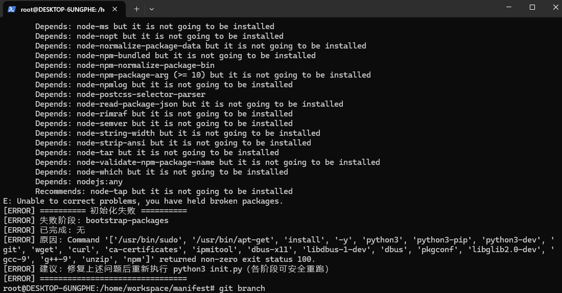

基于最新manifest+630 bmc_sdk执行环境初始化失败
// 基于最新manifest+630 bmc_sdk执行环境初始化失败
python3 init.py -path bmc_sdk.tar.gz -user caiyesheng_b48v3 -psw xxx

环境初始化成功
环境初始化报错,同时报错提示信息无法指导修复

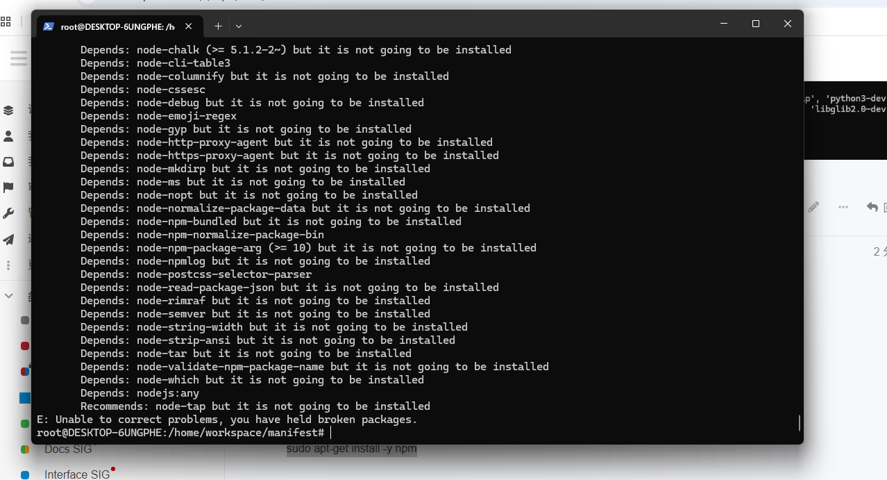

报错如下:
you have held broken packages看起来是apt 解析 npm 依赖时被某个已装包或版本错位卡住了,执行
dpkg -l | grep -E ‘node’
sudo apt-get install -y npm 2>&1 | tail -30
apt-cache policy nodejs node-semver node-tar node-which node-string-width
看下原因呢
或者尝试下以下命令看下能否修复
sudo apt-get purge -y ‘node-*’ 2>/dev/null
sudo dpkg --configure -a
sudo apt-get -f install -y
sudo apt-get update

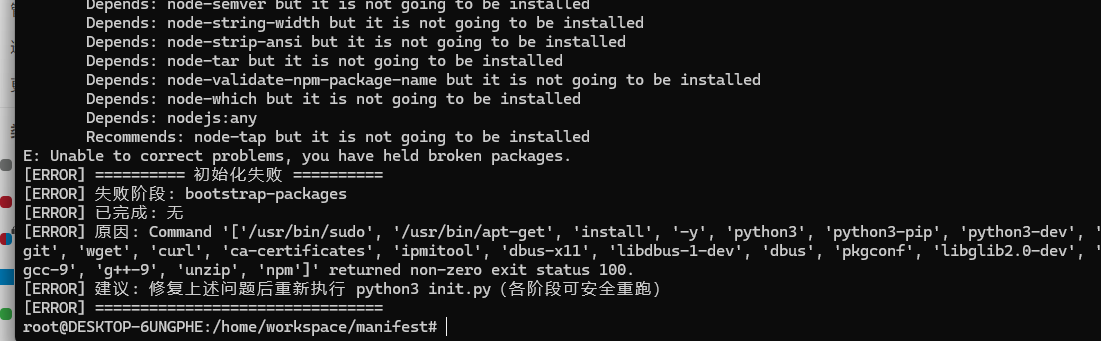

还是报错的
root@DESKTOP-6UNGPHE:/home/workspace/manifest# dpkg -l | grep -E ‘node’
Depends: node-cacache (>= 17) but it is not going to be installed
Depends: node-chalk (>= 5.1.2-2~) but it is not going to be installed
Depends: node-cli-table3
Depends: node-columnify but it is not going to be installed
Depends: node-cssesc
Depends: node-debug but it is not going to be installed
Depends: node-emoji-regex
Depends: node-gyp but it is not going to be installed
Depends: node-http-proxy-agent but it is not going to be installed
Depends: node-https-proxy-agent but it is not going to be installed
Depends: node-mkdirp but it is not going to be installed
Depends: node-ms but it is not going to be installed
Depends: node-nopt but it is not going to be installed
Depends: node-normalize-package-data but it is not going to be installed
Depends: node-npm-bundled but it is not going to be installed
Depends: node-npm-normalize-package-bin
Depends: node-npm-package-arg (>= 10) but it is not going to be installed
Depends: node-npmlog but it is not going to be installed
Depends: node-postcss-selector-parser
Depends: node-read-package-json but it is not going to be installed
Depends: node-rimraf but it is not going to be installed
Depends: node-semver but it is not going to be installed
Depends: node-string-width but it is not going to be installed
Depends: node-strip-ansi but it is not going to be installed
Depends: node-tar but it is not going to be installed
Depends: node-validate-npm-package-name but it is not going to be installed
Depends: node-which but it is not going to be installed
Depends: nodejs:any
Recommends: node-tap but it is not going to be installed
E: Unable to correct problems, you have held broken packages.
