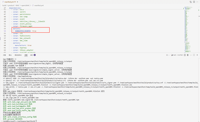

代码版本:2506
问题说明: 在2506增加自签名之后,编译成功,签名成功 在S920X20的环境上先刷了过渡包,之后刷自己编译的Openubmc固件包,提示升级失败,查看日志,在app.log的出现升级写入配置文件失败,请问怎么回事呀?
求助:1. 有没有详细的从华为版本到openubmc版本刷机的文档说明
2. openubmc刷入真机,增加签名外,还需要做什么修改呀
app.log的日志如下

2025-07-11 15:22:49.492398 bmc_core ERROR: l_crypt.c(929): RSA_private_decrypt failed.
2025-07-11 15:22:49.493614 firmware_mgmt WARNING: init.lua(98): hpm_package.lua:613 > hpm_package.lua:512 > hpm_package.lua:221: An error occurred during the firmware upgrade process. Details: Upgrade write config file failed
2025-07-11 15:22:49.494244 firmware_mgmt ERROR: control.lua(298): parse package(rootfs_openUBMC.hpm) failed, ret:FirmwareUpgradeError: An error occurred during the firmware upgrade process. Details: Upgrade write config file failed.

2025-07-11 15:46:43.974916 bmc_core ERROR: l_crypt.c(929): RSA_private_decrypt failed.
2025-07-11 15:46:43.976105 firmware_mgmt WARNING: init.lua(98): hpm_package.lua:613 > hpm_package.lua:512 > hpm_package.lua:221: An error occurred during the firmware upgrade process. Details: Upgrade write config file failed
2025-07-11 15:46:43.976679 firmware_mgmt ERROR: control.lua(298): parse package(rootfs_openUBMC.hpm) failed, ret:FirmwareUpgradeError: An error occurred during the firmware upgrade process. Details: Upgrade write config file failed.

你好,
  1. 社区包和非社区包是怎么区分呢?
  2. 我的包是通过openubmc2506的源码包构建的是不是属于社区包?
  3. 构建过程中是有做签名的,加密是怎么实现?
hpm 构建成功 !!
切换工作目录到: /root/workspace/manifest/temp/build_openUBMC_release_rc/output
不能从 yaml 文件中获取到键值 base/signature/hpm_digest, 没有相关配置
构建 openUBMC hpm 包结束 !
不能从 yaml 文件中获取到键值 base/signature/simple_signer_server, 没有相关配置
切换工作目录到: /tmp/tmp45u6z5cg
>> openssl x509 -in /root/workspace/manifest/build/product/ca/rootca.der -inform der -outform pem -out rootca.pem
>> openssl crl -in /root/workspace/manifest/build/product/ca/rootca.crl -inform der -outform pem -out cms.crl.pem
>> hpm_signer -s /root/workspace/manifest/build/product/ca/signer.pem -t /root/workspace/manifest/build/product/ca/ts_signer.pem -T /root/workspace/manifest/build/product/ca/tsa.cnf -i /root/workspace/manifest/temp/build_openUBMC_release_rc/output/rootfs_openUBMC.filelist -o /root/workspace/manifest/temp/build_openUBMC_release_rc/output/rootfs_openUBMC.filelist.cms
>> hpm_verify -r rootca.pem -C cms.crl.pem -c /root/workspace/manifest/temp/build_openUBMC_release_rc/output/rootfs_openUBMC.filelist -s /root/workspace/manifest/temp/build_openUBMC_release_rc/output/rootfs_openUBMC.filelist.cms
使用 hpm_signer 自签名 /root/workspace/manifest/temp/build_openUBMC_release_rc/output/rootfs_openUBMC.filelist 成功
给 hpm 包 rootfs_openUBMC.hpm 签名
>> cms_sign_hpm.sh 2 rootfs_openUBMC.hpm
复制 rootfs_openUBMC.hpm.signed 到 /root/workspace/manifest/output/rootfs_openUBMC.hpm
任务 work.task_sign_and_pack_hpm 完成
任务 work.task_buildhpm_ext4 完成
任务 work.task_buildgppbin 完成
任务 work.task_hpm_envir_prepare 完成
任务 work.task_build_rootfs_img 完成
开始生成全量接口配置
生成全量接口配置完成
任务 work.create_interface_config 完成
任务 personal 执行成功
root@Microsoft:~/workspace/manifest#
community_enable:true有设置
参考自签名指导
https://discuss.openubmc.cn/t/topic/1665
提示 改页面不存在或者是一个不公开页面,需要申请访问权限吗?@Larry_Li
是的,请联系PAE申请访问权限。

分2种情况
  • 升级社区无签名的openUBMC固件包, 过渡包中必须设置community_enable:true 即社区无签名模式。
  • 升级自制签名的固件包,过渡包不设置community_enable:true,且需要构建时将自值签名根ca证书,打包到opt/bmc/trust/partner

  1. 是的。 2种过渡包对应不同的场景,不要混用
  2. 是的。

你这个看上去像是验签失败,你制作自签名的固件包的私钥和你过渡包里面用来验签的公钥是一对吗?
或者你可以试试直接回退到iBMC,直接升级到openUBMC固件的方式,我现在就是这么干的,这个得话就是得要有个crypto_tool工具,加密一下你的固件包,否则升级的时候也会提示 无效的升级包。
