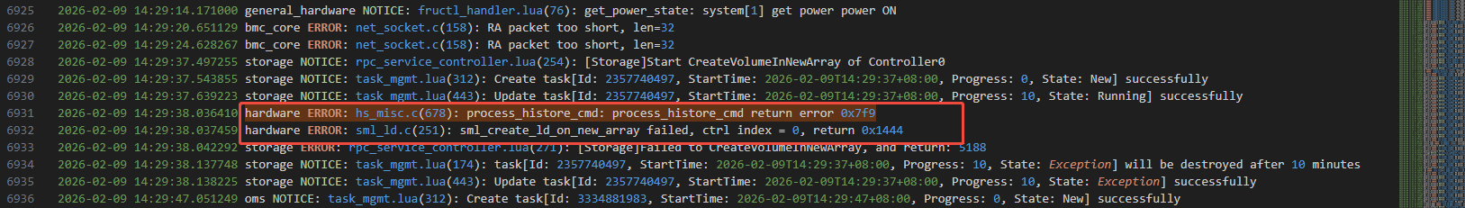

SP686C-M-40i 4G卡下新建逻辑盘失败
网页上想新建逻辑盘,前端提示操作失败,查看日志:
2026-02-09 14:29:37.497255 storage NOTICE: rpc_service_controller.lua(254): [Storage]Start CreateVolumeInNewArray of Controller0
2026-02-09 14:29:37.543855 storage NOTICE: task_mgmt.lua(312): Create task[Id: 2357740497, StartTime: 2026-02-09T14:29:37+08:00, Progress: 0, State: New] successfully
2026-02-09 14:29:37.639223 storage NOTICE: task_mgmt.lua(443): Update task[Id: 2357740497, StartTime: 2026-02-09T14:29:37+08:00, Progress: 10, State: Running] successfully
2026-02-09 14:29:38.036410 hardware ERROR: hs_misc.c(678): process_histore_cmd: process_histore_cmd return error 0x7f9
2026-02-09 14:29:38.037459 hardware ERROR: sml_ld.c(251): sml_create_ld_on_new_array failed, ctrl index = 0, return 0x1444
2026-02-09 14:29:38.042292 storage ERROR: rpc_service_controller.lua(271): [Storage]Failed to CreateVolumeInNewArray, and return: 5188
2026-02-09 14:29:38.137748 storage NOTICE: task_mgmt.lua(174): task[Id: 2357740497, StartTime: 2026-02-09T14:29:37+08:00, Progress: 10, State: Exception] will be destroyed after 10 minutes
2026-02-09 14:29:38.138225 storage NOTICE: task_mgmt.lua(443): Update task[Id: 2357740497, StartTime: 2026-02-09T14:29:37+08:00, Progress: 10, State: Exception] successfully
这个c文件里打印的错误码是啥意思哇

这个错误码0x1444 在storage仓能搜索到,错误原因为创建逻辑盘的物理盘已被使用
