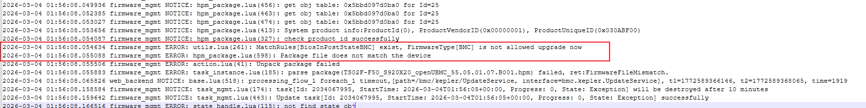

直接升级报了如下错误
2026-03-04 01:56:07.507081 firmware_mgmt NOTICE: file_transfer.lua(174): move_file_s ok:true, err:0
2026-03-04 01:56:07.999442 firmware_mgmt NOTICE: validate_sign.lua(195): verify signature successfully
2026-03-04 01:56:08.000293 firmware_mgmt NOTICE: action.lua(37): Validate signature successfully
2026-03-04 01:56:08.002030 firmware_mgmt NOTICE: hpm_package.lua(782): ManufacturerValidateEnabled is false, there is no need to validate manufacture_id.
2026-03-04 01:56:08.049364 firmware_mgmt NOTICE: hpm_package.lua(582): parse cfg file successfully, Version:55.05.01.07 FileNum:2
2026-03-04 01:56:08.049936 firmware_mgmt NOTICE: hpm_package.lua(456): get obj table: 0x5bbd097d0ba0 for Id=25
2026-03-04 01:56:08.052385 firmware_mgmt NOTICE: hpm_package.lua(463): get obj table: 0x5bbd097d0ba0 for Id=25
2026-03-04 01:56:08.053027 firmware_mgmt NOTICE: hpm_package.lua(474): get obj table: 0x5bbd097d0ba0 for Id=25
2026-03-04 01:56:08.053656 firmware_mgmt NOTICE: hpm_package.lua(413): System product info:ProductId(0), ProductVendorID(0x00000001), ProductUniqueID(0x030ABF00)
2026-03-04 01:56:08.054087 firmware_mgmt NOTICE: hpm_package.lua(327): check product id successfully
2026-03-04 01:56:08.054634 firmware_mgmt ERROR: utils.lua(261): MatchRules[BiosInPostStateBMC] exist, FirmwareType[BMC] is not allowed upgrade now
2026-03-04 01:56:08.055088 firmware_mgmt ERROR: hpm_package.lua(598): Package file does not match the device
2026-03-04 01:56:08.055506 firmware_mgmt ERROR: action.lua(41): Unpack package failed
2026-03-04 01:56:08.055883 firmware_mgmt ERROR: task_instance.lua(185): parse package(TS02F-F50_S920X20_openUBMC_55.05.01.07.B001.hpm) failed, ret:FirmwareFileMismatch.
2026-03-04 01:56:08.065826 web_backend NOTICE: base.lua(518): processing_flow_1 foreach_1 timeout,[path=/bmc/kepler/UpdateService, interface=bmc.kepler.UpdateService], t1=1772589366146, t2=1772589368065, time=1919
2026-03-04 01:56:08.158584 firmware_mgmt NOTICE: task_mgmt.lua(174): task[Id: 2034067995, StartTime: 2026-03-04T01:56:05+00:00, Progress: 0, State: Exception] will be destroyed after 10 minutes
2026-03-04 01:56:08.159642 firmware_mgmt NOTICE: task_mgmt.lua(443): Update task[Id: 2034067995, StartTime: 2026-03-04T01:56:05+00:00, Progress: 0, State: Exception] successfully
2026-03-04 01:56:08.166516 firmware_mgmt ERROR: state_handle.lua(115): not find state obj
这表明系统中存在 升级匹配规则(MatchRules)阻止了本次升级。此规则通常由前期“装备流程”或特定构建配置引入。

报错信息是 BIOS Post阶段不允许升级,等待至POST阶段结束即可
您好,这边是进了OS之后才升级的BMC
请附一份一键日志收集
HengshanTS02F-F50_YS2B60201790_20260304-0156.txt (9.6 MB)
麻烦下载后,转成tar.gz格式
操作日志显示01:55:16刚重启OS,且升级操作日志上下都存在BIOS向BMC发送的IPMI命令的日志。
升级BMC时正处于POST阶段,不允许升级
2026-03-04 01:55:16 KVM,baixin@172.10.32.221,fructrl,Set FRU0 to forced system reset successfully
2026-03-04 01:55:16 KVM,baixin@172.10.32.221,remote_console,Set power state successfully
2026-03-04 01:55:28 IPMI,N/A@HOST,BIOS,Set BIOS version to 21.52E
2026-03-04 01:55:28 IPMI,N/A@HOST,ipmi_core,Set watchdog timer use to (BIOS/POST), action to (Hard Reset), timeout to (900) seconds, stop running successfully
2026-03-04 01:55:37 IPMI,N/A@HOST,fault_diagnosis,BIOS report memory SPPR resource info
2026-03-04 01:55:38 IPMI,N/A@HOST,fault_diagnosis,BIOS report memory ACLS resource info
2026-03-04 01:55:46 IPMI,N/A@HOST,BIOS,No need to apply patch!  ,
2026-03-04 01:56:03 IPMI,N/A@HOST,BIOS,Set TeeOS version to 1.1
2026-03-04 01:56:04 WEB,baixin@172.10.32.221,web_backend,Upload file(TS02F-F50_S920X20_openUBMC_55.05.01.07.B001.hpm) successfully
2026-03-04 01:56:05 WEB,baixin@172.10.32.221,firmware_mgmt,Upgrade TS02F-F50_S920X20_openUBMC_55.05.01.07.B001.hpm started
2026-03-04 01:56:07 IPMI,N/A@HOST,Compute,BIOS set chip bitwidth successfully
2026-03-04 01:56:08 WEB,baixin@172.10.32.221,firmware_mgmt,Upgrade (TS02F-F50_S920X20_openUBMC_55.05.01.07.B001.hpm) failed
