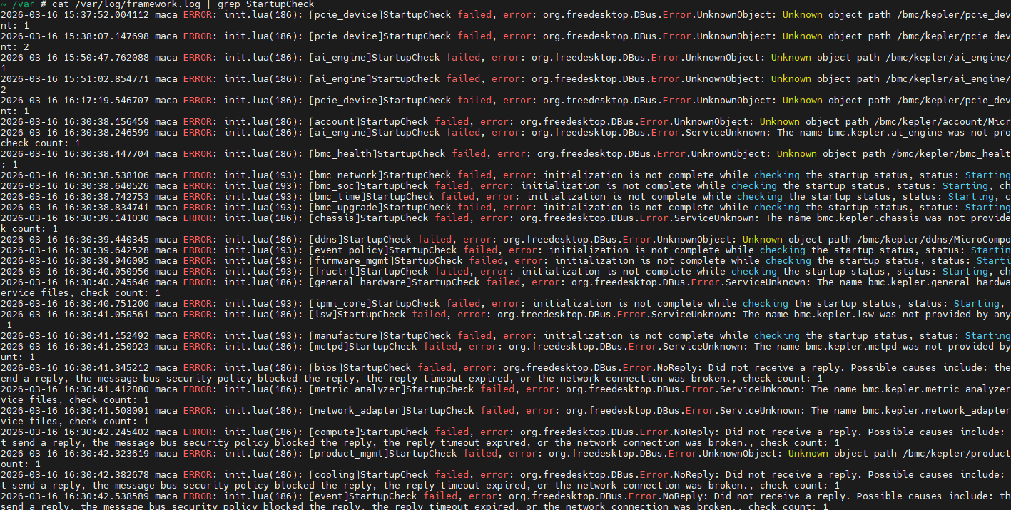

【问题描述】测试进行反复AC测试过程中,出现IP能ping通,但是Web无法连接问题
【基线版本】openUBMC 2509
【定位步骤】
1.尝试SSH使用ipmcget -d dia 一键收集日志,出现以下报错
企业微信截图_17736518723116
2.尝试使用telnet连接BMC,查看framework.log发现出现大量组件启动检查失败
3.通过手动在telnet下将/var/log/目录的日志压缩下载见附件
dump.tar.gz.txt (9.2 MB)

好的,我先看下日志
定位情况怎么样了?
2026-03-16 16:29:13.183697 [:00000008] hardware: LAUNCH snlua hica/subsys/hardware/service/main
2026-03-16 16:29:13.254727 [:00000008] hardware: lua loader error : /opt/bmc/skynet/lualib/loader.lua:0: cannot open /opt/bmc/libmc/service/hica/subsys/hardware/service/main.lua: No such file or directory cannot open /opt/bmc/libmc/service/hica/subsys/hardware/service/main/init.lua: No such file or directory cannot open /opt/bmc/skynet/service/hica/subsys/hardware/service/main.lua: No such file or directory cannot open /opt/bmc/skynet/service/hica/subsys/hardware/service/main/init.lua: No such file or directory cannot open /opt/bmc/apps/hica/subsys/hardware/service/main.lua: Structure needs cleaning cannot open /opt/bmc/apps/hica/subsys/hardware/service/main/init.lua: Structure needs cleaning stack traceback: [C]: in function ‘error’ /opt/bmc/skynet/lualib/loader.lua: in function </opt/bmc/skynet/lualib/loader.lua:0>
2026-03-16 16:29:13.276787 [:00000008] hardware: KILL self
2026-03-16 16:29:13.307257 [:00000002] hardware: KILL self
2026-03-16 16:29:13.226668 certificate ERROR: class.lua(129): failed to start certificate in init stage, err: error loading module ‘rtos_security_config.interface.banner_config_mdb’ from file ‘/opt/bmc/apps/certificate/lualib/rtos_security_config/interface/banner_config_mdb.lua’: …lib/rtos_security_config/interface/banner_config_mdb.lua:1: unexpected symbol stack traceback: [C]: at 0xffff891be748 [C]: in function ‘require’ …lualib/rtos_security_config/rtos_security_config_app.lua:47: in function ‘banner_config_init’ …lualib/rtos_security_config/rtos_security_config_app.lua:27: in function ‘execute’ ./opt/bmc/libmc/lualib/mc/class.lua:156: in function ‘new’ ./opt/bmc/libmc/lualib/mc/singleton.lua:40: in function <./opt/bmc/libmc/lualib/mc/singleton.lua:38> [C]: in function ‘’ /opt/bmc/skynet/lualib/skynet/queue.lua: in function </opt/bmc/skynet/lualib/skynet/queue.lua:0> ./opt/bmc/libmc/lualib/mc/singleton.lua:38: in function ‘new’ ./opt/bmc/apps/certificate/lualib/certificate_app.lua:114: in function ‘old_init’ ./opt/bmc/libmc/lualib/mc/service_app_base.lua:345: in function <./opt/bmc/libmc/lualib/mc/service_app_base.lua:343> [C]: in function ‘pcall’ ./opt/bmc/libmc/lualib/mc/class.lua:124: in function ‘execute’ ./opt/bmc/libmc/lualib/mc/class.lua:156: in function ‘new’ ./opt/bmc/apps/certificate/service/main.lua:35: in function ‘user_main’ ./opt/bmc/libmc/lualib/mc/app_preloader.lua:180: in function ‘’ /opt/bmc/skynet/lualib/skynet.lua: in function </opt/bmc/skynet/lualib/skynet.lua:0> [C]: in function ‘xpcall’ /opt/bmc/skynet/lualib/skynet.lua: in function ‘init_service’ /opt/bmc/skynet/lualib/skynet.lua: in function ‘’ /opt/bmc/skynet/lualib/skynet.lua: in function </opt/bmc/skynet/lualib/skynet.lua:0>
2026-03-16 16:29:13.230751 security ERROR: app_preloader.lua(212): ./opt/bmc/libmc/lualib/mc/launch_control/init.lua:108: app(hica/subsys/security/service/main) count(1) pcall failed(/opt/bmc/skynet/service/service_mgr.lua:0: /opt/bmc/skynet/lualib/skynet.lua:0: call failed)
2026-03-16 16:29:13.237923 security ERROR: l_sig_handler.c(350): ========== FATAL SIGNAL CAUGHT ========== PackageBuildTime: 20260310100621 PID: 2592, PPID: 1 Program: security Signal: 6 (SIGABRT) - Abort signal Signal code: -6 Sending PID: 2592 ========== END OF CRASH REPORT ==========
目前看到有安全进程coredump,以及hardware进程打开文件失败。
文件打开失败的这个,有cannot open /opt/bmc/apps/hica/subsys/hardware/service/main.lua: Structure needs cleaning报错, 这个是报错文件系统错误 ,通常与文件系统损坏或存储硬件问题有关。
Structure needs cleaning 表示:
  • 文件系统元数据损坏或不一致
  • 存储设备有坏块或硬件故障
  • 系统意外断电导致文件系统状态异常
  • 内存错误影响文件系统操作
