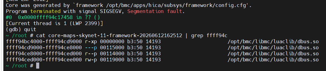

从framework.log可以发现在重启前有大量init service failed和endless loop,最早的异常是2026-06-17 15:40:59.564562 [:00000002] framework: KILL self

2026-06-17 15:41:49.757559 maca ERROR: init.lua(184): [storage]StartupCheck failed, error: org.freedesktop.DBus.Error.ServiceUnknown: The name bmc.kepler.storage was not provided by any .service files, check count: 1
2026-06-17 15:41:49.845961 maca ERROR: init.lua(184): [thermal_mgmt]StartupCheck failed, error: org.freedesktop.DBus.Error.ServiceUnknown: The name bmc.kepler.thermal_mgmt was not provided by any .service files, check count: 1
2026-06-17 15:41:50.048650 maca ERROR: init.lua(184): [ums]StartupCheck failed, error: org.freedesktop.DBus.Error.ServiceUnknown: The name bmc.kepler.ums was not provided by any .service files, check count: 1
2026-06-17 15:41:50.350121 maca ERROR: init.lua(191): [web_backend]StartupCheck failed, error: initialization is not complete while checking the startup status, status: Starting, check count: 1
2026-06-17 15:41:53.382747 hwproxy NOTICE: monitor.lua(156): main service no recevice from work service, bus_name: Hisport_8, position: 01010A, count:6 [repeated 1000 times in 21s from 2026-06-17 15:41:32.848460 to 2026-06-17 15:41:53.382747]
2026-06-17 15:41:59.917543 maca ERROR: init.lua(184): [ai_engine]StartupCheck failed, error: org.freedesktop.DBus.Error.ServiceUnknown: The name bmc.kepler.ai_engine was not provided by any .service files, check count: 2
2026-06-17 15:42:00.822205 maca ERROR: init.lua(184): [chassis]StartupCheck failed, error: org.freedesktop.DBus.Error.ServiceUnknown: The name bmc.kepler.chassis was not provided by any .service files, check count: 2
2026-06-17 15:42:01.015995 maca ERROR: init.lua(184): [cooling]StartupCheck failed, error: org.freedesktop.DBus.Error.ServiceUnknown: The name bmc.kepler.cooling was not provided by any .service files, check count: 2
2026-06-17 15:42:01.164825 maca ERROR: init.lua(191): [dcmid]StartupCheck failed, error: initialization is not complete while checking the startup status, status: Starting, check count: 2
2026-06-17 15:42:01.327387 maca ERROR: init.lua(191): [event]StartupCheck failed, error: initialization is not complete while checking the startup status, status: Starting, check count: 2
2026-06-17 15:42:02.020554 maca ERROR: init.lua(184): [general_hardware]StartupCheck failed, error: org.freedesktop.DBus.Error.ServiceUnknown: The name bmc.kepler.general_hardware was not provided by any .service files, check count: 2
2026-06-17 15:42:02.819009 maca ERROR: init.lua(191): [lsw]StartupCheck failed, error: initialization is not complete while checking the startup status, status: Starting, check count: 2
2026-06-17 15:42:02.921923 maca ERROR: init.lua(184): [manufacture]StartupCheck failed, error: org.freedesktop.DBus.Error.ServiceUnknown: The name bmc.kepler.manufacture was not provided by any .service files, check count: 2
2026-06-17 15:42:03.134005 maca ERROR: init.lua(184): [metric_analyzer]StartupCheck failed, error: org.freedesktop.DBus.Error.ServiceUnknown: The name bmc.kepler.metric_analyzer was not provided by any .service files, check count: 2
2026-06-17 15:42:03.227056 maca ERROR: init.lua(184): [network_adapter]StartupCheck failed, error: org.freedesktop.DBus.Error.ServiceUnknown: The name bmc.kepler.network_adapter was not provided by any .service files, check count: 2
2026-06-17 15:42:03.326569 maca ERROR: init.lua(191): [nsm]StartupCheck failed, error: initialization is not complete while checking the startup status, status: Starting, check count: 2
2026-06-17 15:42:03.416771 maca ERROR: init.lua(191): [observability]StartupCheck failed, error: initialization is not complete while checking the startup status, status: Starting, check count: 2
2026-06-17 15:42:03.509410 hwproxy ERROR: monitor.lua(127): set the hwproxy health status to need restart now, bus_name: Hisport
2026-06-17 15:42:03.510696 hwproxy NOTICE: main.lua(71): set hwproxy service health status need to restart
2026-06-17 15:42:03.534014 maca ERROR: init.lua(184): [oms]StartupCheck failed, error: org.freedesktop.DBus.Error.ServiceUnknown: The name bmc.kepler.oms was not provided by any .service files, check count: 2
2026-06-17 15:42:03.631658 maca ERROR: init.lua(184): [pcie_device]StartupCheck failed, error: org.freedesktop.DBus.Error.ServiceUnknown: The name bmc.kepler.pcie_device was not provided by any .service files, check count: 2
2026-06-17 15:42:03.818160 maca ERROR: init.lua(184): [power_mgmt]StartupCheck failed, error: org.freedesktop.DBus.Error.ServiceUnknown: The name bmc.kepler.power_mgmt was not provided by any .service files, check count: 2
2026-06-17 15:42:03.920465 maca ERROR: init.lua(184): [power_strategy]StartupCheck failed, error: org.freedesktop.DBus.Error.ServiceUnknown: The name bmc.kepler.power_strategy was not provided by any .service files, check count: 2
2026-06-17 15:42:04.115267 maca ERROR: init.lua(191): [redfish]StartupCheck failed, error: initialization is not complete while checking the startup status, status: Starting, check count: 2
2026-06-17 15:42:04.841574 maca ERROR: init.lua(184): [storage]StartupCheck failed, error: org.freedesktop.DBus.Error.ServiceUnknown: The name bmc.kepler.storage was not provided by any .service files, check count: 2
2026-06-17 15:42:04.923474 maca ERROR: init.lua(184): [thermal_mgmt]StartupCheck failed, error: org.freedesktop.DBus.Error.ServiceUnknown: The name bmc.kepler.thermal_mgmt was not provided by any .service files, check count: 2
2026-06-17 15:42:05.120597 maca ERROR: init.lua(184): [ums]StartupCheck failed, error: org.freedesktop.DBus.Error.ServiceUnknown: The name bmc.kepler.ums was not provided by any .service files, check count: 2
2026-06-17 15:42:05.443334 maca ERROR: init.lua(191): [web_backend]StartupCheck failed, error: initialization is not complete while checking the startup status, status: Starting, check count: 2
2026-06-17 15:42:08.583478 [:00000000] framework: A message from [ :0000000f ] to [ :00000013 ] maybe in an endless loop (version = 1641)
2026-06-17 15:42:08.584712 [:00000000] framework: A message from [ :0000000f ] to [ :00000026 ] maybe in an endless loop (version = 3587)
2026-06-17 15:42:14.997402 maca ERROR: init.lua(184): [ai_engine]StartupCheck failed, error: org.freedesktop.DBus.Error.ServiceUnknown: The name bmc.kepler.ai_engine was not provided by any .service files, check count: 3
2026-06-17 15:42:15.888787 maca ERROR: init.lua(184): [chassis]StartupCheck failed, error: org.freedesktop.DBus.Error.ServiceUnknown: The name bmc.kepler.chassis was not provided by any .service files, check count: 3
2026-06-17 15:42:16.163125 maca ERROR: init.lua(184): [cooling]StartupCheck failed, error: org.freedesktop.DBus.Error.ServiceUnknown: The name bmc.kepler.cooling was not provided by any .service files, check count: 3
2026-06-17 15:42:16.237819 maca ERROR: init.lua(191): [dcmid]StartupCheck failed, error: initialization is not complete while checking the startup status, status: Starting, check count: 3
2026-06-17 15:42:16.396241 maca ERROR: init.lua(191): [event]StartupCheck failed, error: initialization is not complete while checking the startup status, status: Starting, check count: 3
2026-06-17 15:42:17.894056 maca ERROR: init.lua(191): [lsw]StartupCheck failed, error: initialization is not complete while checking the startup status, status: Starting, check count: 3
2026-06-17 15:42:18.690013 maca ERROR: init.lua(191): [nsm]StartupCheck failed, error: initialization is not complete while checking the startup status, status: Starting, check count: 3
2026-06-17 15:42:18.770432 maca ERROR: init.lua(191): [observability]StartupCheck failed, error: initialization is not complete while checking the startup status, status: Starting, check count: 3
2026-06-17 15:42:19.174860 maca ERROR: init.lua(191): [redfish]StartupCheck failed, error: initialization is not complete while checking the startup status, status: Starting, check count: 3
2026-06-17 15:42:20.514188 maca ERROR: init.lua(191): [web_backend]StartupCheck failed, error: initialization is not complete while checking the startup status, status: Starting, check count: 3
2026-06-17 15:42:31.318277 maca ERROR: init.lua(191): [dcmid]StartupCheck failed, error: initialization is not complete while checking the startup status, status: Starting, check count: 4
2026-06-17 15:42:31.470495 maca ERROR: init.lua(191): [event]StartupCheck failed, error: initialization is not complete while checking the startup status, status: Starting, check count: 4
2026-06-17 15:42:33.010896 maca ERROR: init.lua(191): [lsw]StartupCheck failed, error: initialization is not complete while checking the startup status, status: Starting, check count: 4
2026-06-17 15:42:33.771406 maca ERROR: init.lua(191): [nsm]StartupCheck failed, error: initialization is not complete while checking the startup status, status: Starting, check count: 4
2026-06-17 15:42:33.850959 maca ERROR: init.lua(191): [observability]StartupCheck failed, error: initialization is not complete while checking the startup status, status: Starting, check count: 4
2026-06-17 15:42:34.269026 maca ERROR: init.lua(191): [redfish]StartupCheck failed, error: initialization is not complete while checking the startup status, status: Starting, check count: 4
2026-06-17 15:42:35.596417 maca ERROR: init.lua(191): [web_backend]StartupCheck failed, error: initialization is not complete while checking the startup status, status: Starting, check count: 4
2026-06-17 15:42:38.593139 [:00000000] framework: A message from [ :0000000f ] to [ :00000027 ] maybe in an endless loop (version = 2297)
2026-06-17 15:42:38.603219 [:00000000] framework: A message from [ :0000000f ] to [ :00000013 ] maybe in an endless loop (version = 1641)
2026-06-17 15:42:38.603299 [:00000000] framework: A message from [ :0000000f ] to [ :00000026 ] maybe in an endless loop (version = 3587)
2026-06-17 15:42:46.400971 maca ERROR: init.lua(191): [dcmid]StartupCheck failed, error: initialization is not complete while checking the startup status, status: Starting, check count: 5
2026-06-17 15:42:46.540640 maca ERROR: init.lua(191): [event]StartupCheck failed, error: initialization is not complete while checking the startup status, status: Starting, check count: 5
2026-06-17 15:42:48.077337 maca ERROR: init.lua(191): [lsw]StartupCheck failed, error: initialization is not complete while checking the startup status, status: Starting, check count: 5
2026-06-17 15:42:48.851350 maca ERROR: init.lua(191): [nsm]StartupCheck failed, error: initialization is not complete while checking the startup status, status: Starting, check count: 5
2026-06-17 15:42:48.927523 maca ERROR: init.lua(191): [observability]StartupCheck failed, error: initialization is not complete while checking the startup status, status: Starting, check count: 5
2026-06-17 15:42:49.333113 maca ERROR: init.lua(191): [redfish]StartupCheck failed, error: initialization is not complete while checking the startup status, status: Starting, check count: 5
2026-06-17 15:42:50.665937 maca ERROR: init.lua(191): [web_backend]StartupCheck failed, error: initialization is not complete while checking the startup status, status: Starting, check count: 5
2026-06-17 15:43:01.479999 maca ERROR: init.lua(191): [dcmid]StartupCheck failed, error: initialization is not complete while checking the startup status, status: Starting, check count: 6
2026-06-17 15:43:01.618986 maca ERROR: init.lua(191): [event]StartupCheck failed, error: initialization is not complete while checking the startup status, status: Starting, check count: 6
2026-06-17 15:43:03.155608 maca ERROR: init.lua(191): [lsw]StartupCheck failed, error: initialization is not complete while checking the startup status, status: Starting, check count: 6
2026-06-17 15:43:03.916945 maca ERROR: init.lua(191): [nsm]StartupCheck failed, error: initialization is not complete while checking the startup status, status: Starting, check count: 6
2026-06-17 15:43:04.000613 maca ERROR: init.lua(191): [observability]StartupCheck failed, error: initialization is not complete while checking the startup status, status: Starting, check count: 6
2026-06-17 15:43:04.422690 maca ERROR: init.lua(191): [redfish]StartupCheck failed, error: initialization is not complete while checking the startup status, status: Starting, check count: 6
2026-06-17 15:43:05.726097 maca ERROR: init.lua(191): [web_backend]StartupCheck failed, error: initialization is not complete while checking the startup status, status: Starting, check count: 6
2026-06-17 15:43:08.591664 [:00000000] framework: A message from [ :0000000f ] to [ :00000027 ] maybe in an endless loop (version = 2297)
2026-06-17 15:43:08.592328 [:00000000] framework: A message from [ :0000000f ] to [ :00000013 ] maybe in an endless loop (version = 1641)
2026-06-17 15:43:08.592403 [:00000000] framework: A message from [ :0000000f ] to [ :00000026 ] maybe in an endless loop (version = 3587)
2026-06-17 15:43:16.553361 maca ERROR: init.lua(191): [dcmid]StartupCheck failed, error: initialization is not complete while checking the startup status, status: Starting, check count: 7
2026-06-17 15:43:16.693829 maca ERROR: init.lua(191): [event]StartupCheck failed, error: initialization is not complete while checking the startup status, status: Starting, check count: 7
2026-06-17 15:43:18.231804 maca ERROR: init.lua(191): [lsw]StartupCheck failed, error: initialization is not complete while checking the startup status, status: Starting, check count: 7
2026-06-17 15:43:35.927096 maca NOTICE: init.lua(243): check startup status completely, total components count: 57, normal count: 36, abnormal components: ["ai_engine","chassis","cooling","dcmid","event","general_hardware","lsw","manufacture","metric_analyzer","network_adapter","nsm","observability","oms","pcie_device","power_mgmt","power_strategy","redfish","storage","thermal_mgmt","ums","web_backend"]

2026-06-17 15:40确实有coredump产生,使用gdb进行分析
coredump发生在/opt/bmc/libmc/luaclib/dbus.so
##AI补充分析
由于没有带debug info的dbus.so,只能让AI辅助分析了一下:
这份 coredump 是 framework /opt/bmc/apps/hica/subsys/framework/config.cfg 进程崩溃,信号是 SIGSEGV。崩溃地址在 core 中映射的 /opt/bmc/libmc/luaclib/dbus.so 内:
PC = 0xffff94c17458
dbus.so base = 0xffff94bc4000
offset = 0x53458
最开始在板上直接跑 gdb 时显示:
dev_tree::property::get_signature() const + 12
但这个符号化结果不可靠,因为 core maps 里的 dbus.so inode 是 14193,而板上当前 /opt/bmc/libmc/luaclib/dbus.so inode 是 14358,库已经不是 core 当时加载的那份。gdb 也提示了 wrong library or version mismatch。
我后来按 core maps 的 ELF 分页布局找到了更匹配的本机 release 版:
/home/workspace/source/manifest/temp/build_openUBMC_release_dev/tmp_root/opt/bmc/libmc/luaclib/dbus.so
这份库的布局和 core maps 对得上:r-xp 到 0x115000,后面 r--/rw 到 0x119000,文件大小 0x119858。用它解析 0x53458,真实位置更像是:
luawrap::c_call<... DBus::LDBusConnection::l_filter_message_cb ...>(lua_State*)
也就是崩溃路径应关注 DBus::LDBusConnection::l_filter_message_cb / do_filter_message_cb 这条 D-Bus 消息过滤回调链,而不是 dev_tree::property::get_signature。
寄存器上,板上 gdb 看到崩溃线程 x0 = 0、x1 = 0,属于空指针/空对象传入 C++/luawrap 调用链后解引用导致的段错误。线程栈不完整,有 corrupt stack 提示,但主线程关键栈为:
luawrap/dbus.so -> liblua.so -> lua_pcall -> dbus.so
目前缺口是:没有找到带 debug info 的 AArch64 luaclib/dbus.so 或对应 .debug/.dwo 文件。本机找到的 AArch64 dbus.so 都是 stripped;带 debug info 的 dbus.so 只有 x86-64,只能辅助确认同名函数源码大概在历史路径 src/lualib-src/dbus/l_connection.cpp,do_filter_message_cb 约 71 行、l_filter_message_cb 约 90 行,不能做 AArch64 地址级精确行号解析。
因此当前问题判断是:framework 在处理 D-Bus filter message callback 时,DBus::LDBusConnection* 或相关 Lua/C++ wrapper 参数为空,进入 luawrap::c_call 后触发空指针访问崩溃。下一步应从 l_filter_message_cb 的调用注册、对象生命周期、连接注销/回调并发、Lua userdata 是否失效这些方向查。

之前fructrl使用SDK的 mc_sys_info.get_reset_type 函数判断BMC复位类型,不太准确,最新的fructrl已修改为通过全局属性BmcResetType来判断BMC复位类型,并结合私有属性PowerOnStrategyStatus一起判断是否执行开机策略。BmcResetType的取值是在闭源组件bmc_soc中更新的,新版的fructrl需要搭配最新的SDK使用。
这个改动我看过了,但是一来我们是LTS SP2分支SDK不支持,二来我们想知道为啥会coredump
通过maps文件找下coredump的地方
我补充了AI分析结果,但是我没有带符号表的dbus.so,无法精准定位,帖子附件里面有对应的coredump文件,可以用带符号表的dbus.so精准定位一下吗
