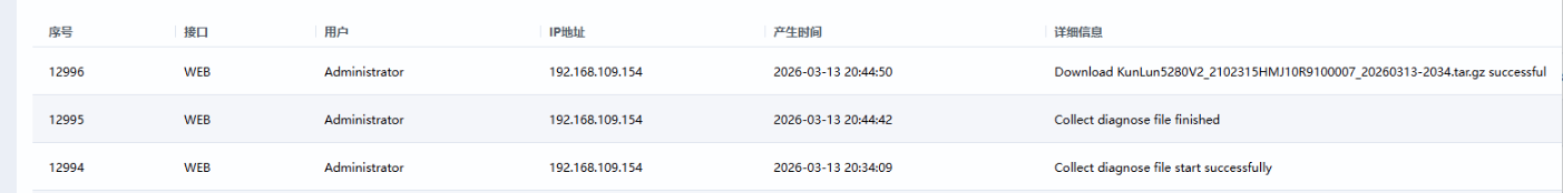

一键收集日志,概率出现收集任务持续10min后成功,收集时间久,network_adapter报错
web接口进行一键收集日志,概率出现收集任务持续10min后成功,收集时间久
  • 软件版本:openUBMC LTS SP1
收集进度每次都在49%时变得很慢,并且有网卡组件未响应的打印
2026-03-13 20:40:06.345758 oms NOTICE: task_mgmt.lua(443): Update task[Id: 1758058394, StartTime: 2026-03-13T20:34:09+08:00, Progress: 49, State: Running] successfully
2026-03-13 20:44:22.030223 oms ERROR: log_dump.lua(459): Dump app: network_adapter failed, err = {"format":"Did not receive a reply. Possible causes include:the remote application did not send a reply, the messagebus security policy blocked the reply, the reply timeout expired,or the network connection was broken.","name":"org.freedesktop.DBus.Error.NoReply"}
2026-03-13 20:44:22.753529 oms NOTICE: task_mgmt.lua(443): Update task[Id: 1758058394, StartTime: 2026-03-13T20:34:09+08:00, Progress: 50, State: Running] successfully
KunLun5280V2_2102315HMJ10R9100007_20260313-2034.part1.rar.txt (9 MB)
KunLun5280V2_2102315HMJ10R9100007_20260313-2034.part2.rar.txt (556.5 KB)

最终收集成功了吗
成功了
最终日志收集成功,原因应该是network_adapter组件正在执行周期任务,与收日志的动作冲突导致进程繁忙。收集日志动作本身最终成功,且未超过基线要求即可
