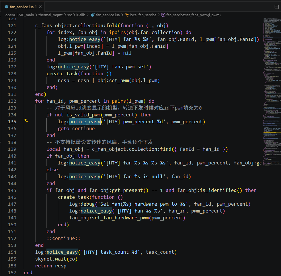

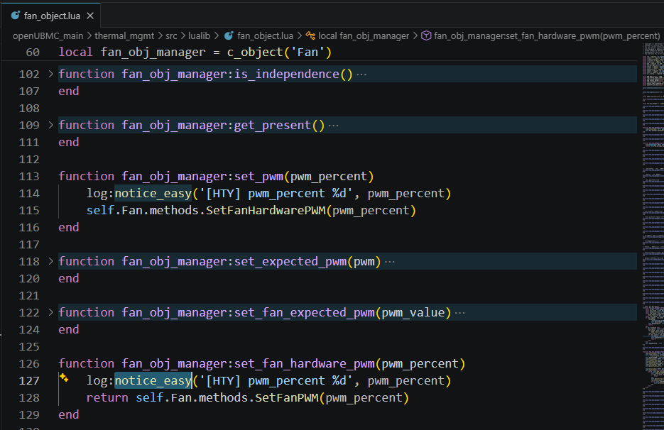

在fan_service:set_fans_pwm(l_pwm),fan_service:set_fan_pwm(system_id, fan_id, pwm_percent)、fan_obj_manager:set_pwm(pwm_percent)这三个函数加一点日志看看,打印下下发转速,是由哪里导致的风扇转速变化。日志级别用notice就行
在fan_obj_manager:set_pwm和fan_obj_manager:set_fan_hardware_pwm加的notice日志都没有打印,应该是风扇型号一直未识别到,fan_service:set_fans_pwm中无法调到fan_obj:set_fan_hardware_pwm进行PWM生效。

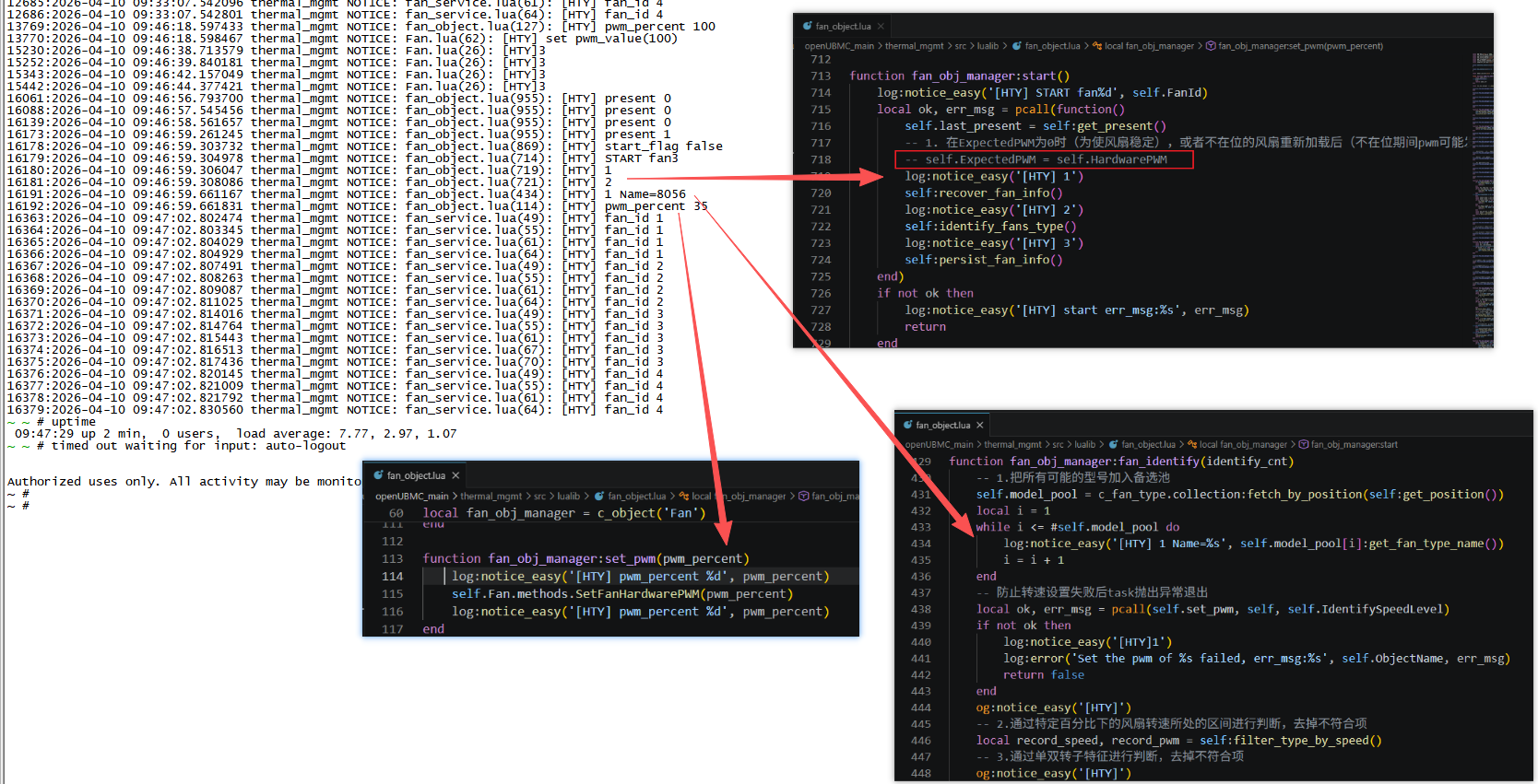

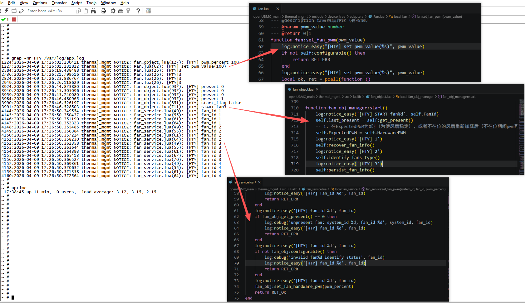

使用tracechip查看SMC对象又能够看到大量的PWM设置操作。

2026-04-08 18:57:25.750493 thermal_mgmt NOTICE: fan_service.lua(142): [HTY] fan 4 80 [repeated 147 times in 301s from 2026-04-08 18:52:25.091038 to 2026-04-08 18:57:25.750493]
2026-04-08 18:57:29.810639 thermal_mgmt NOTICE: fan_service.lua(142): [HTY] fan 1 80 [repeated 147 times in 301s from 2026-04-08 18:52:29.171399 to 2026-04-08 18:57:29.810639]
2026-04-08 18:57:29.812522 thermal_mgmt NOTICE: fan_service.lua(142): [HTY] fan 2 80 [repeated 147 times in 301s from 2026-04-08 18:52:29.187865 to 2026-04-08 18:57:29.812522]
2026-04-08 18:57:29.814499 thermal_mgmt NOTICE: fan_service.lua(142): [HTY] fan 3 80 [repeated 147 times in 301s from 2026-04-08 18:52:29.191415 to 2026-04-08 18:57:29.814499]
2026-04-08 18:57:33.642182 thermal_mgmt ERROR: synchronization.lua(187): set value failed when synchronizing property Fan_4_010103.RearSpeed, err:./opt/bmc/libmc/lualib/sd_bus/object.lua:832: ./opt/bmc/libmc/lualib/mc/signal.lua:289: emit signal: nesting is not allowed [repeated 5 times in 308s from 2026-04-08 18:52:26.010044 to 2026-04-08 18:57:33.642182]
2026-04-08 18:57:45.329218 thermal_mgmt DEBUG: fan_object.lua(911): Detect fan(4) HardwarePWM:173 [repeated 15 times in 323s from 2026-04-08 18:52:22.501661 to 2026-04-08 18:57:45.329218]
2026-04-08 18:57:54.386945 thermal_mgmt INFO: cooling_mgmt.lua(1008): Set all fan pwm, pwm(80 80 80 80) [repeated 148 times in 302s from 2026-04-08 18:52:51.622124 to 2026-04-08 18:57:54.386945]
2026-04-08 18:57:54.387257 thermal_mgmt NOTICE: fan_service.lua(119): [HTY] task_count 0 [repeated 148 times in 302s from 2026-04-08 18:52:51.622537 to 2026-04-08 18:57:54.387257]
2026-04-08 18:57:54.388795 thermal_mgmt NOTICE: fan_service.lua(121): [HTY] task_count 0 [repeated 148 times in 302s from 2026-04-08 18:52:51.624139 to 2026-04-08 18:57:54.388795]
2026-04-08 18:57:54.389232 thermal_mgmt NOTICE: fan_service.lua(133): [HTY] task_count 0 [repeated 148 times in 302s from 2026-04-08 18:52:51.624627 to 2026-04-08 18:57:54.389232]
2026-04-08 18:57:54.389513 thermal_mgmt NOTICE: fan_service.lua(137): [HTY] pwm_percent 0 [repeated 148 times in 302s from 2026-04-08 18:52:51.624923 to 2026-04-08 18:57:54.389513]

fan_service:set_fans_pwm会尝试走的批量接口下发,这个方法有没有打印,风扇识别会走fan_obj_manager:set_pwm(pwm_percent),看看是不是这两处导致的转速变化,截图的时候把添加日志的地方一起截上,开notice日志就行,用不限频的打印
打印位置
日志打印

1 CSR没有定义fans对象,没走批量接口
2 风扇型号未识别,单个风扇设置未执行
adapter下风扇接口加下打印呢,确定下是否是thermal组件进行的pwm设置操作,是否还有其他地方在进行转速设置
adapter的日志在BMC刚启动的时候打印了一次,且因为self:configurable判断没有真正生效,运行过程中没有持续的PWM设置日志

还有一点比较奇怪,fan_obj_manager:start只有入口的日志输出了,后续日志都没有。
cooling组件下发风扇转速也是走的therma组件的接口下发的,start的712、714中间用pcall加上看看,有没有崩,或者错误打印
pcall未捕捉到异常,屏蔽self.ExpectedPWM = self.HardwarePWM后可以继续后续流程,在fan_obj_manager:set_pwm执行self.Fan.methods.SetFanHardwarePWM时又阻塞了

监听回调里的self:update_pwm_percentage()函数也都是执行完了吗,日志有没有endless loop的打印,收集一份日志看看(不开debug日志,notice就行)
验证看来和Scanner、Accessor的type有关,使用BlockIO有问题,风扇的presence、PWM只支持BitIO的操作吗?
type为0代表位读,1是块读
CPLD之前只支持了块读,CSR用块读就会导致上面的问题,CPLD和BMC都换成位读就正常了
