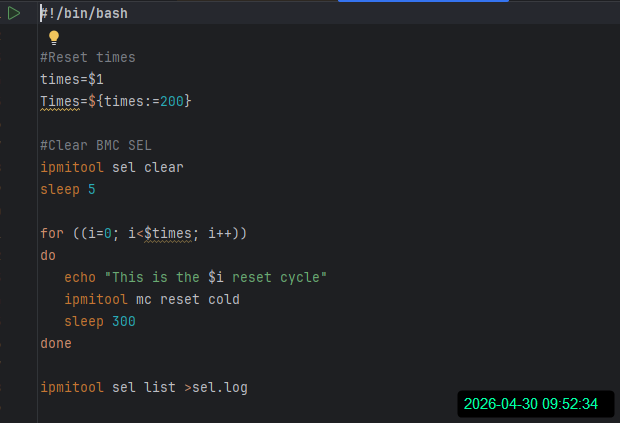

  1. 见截图测试脚本
测试无ipmi异常打印返回
中途出现ipmi命令发送失败

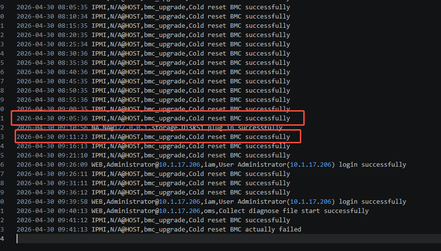

1.分析操作日志发现,确定ipmitool mc reset cold发送失败时间为2026-04-30 9:10:36左右
2.查看linux_kernel_log发现btc init时间符合预期,但是在09:09:45有异常打印
3.查看app.log存在bt 服务退出日志

- **测试操作**:在带内环境下循环执行 `ipmitool mc reset cold` 命令进行 BMC 长期压测(共 200 次,间隔 300 秒)。

- 此前的 `mc reset cold` 均记录为成功(`Cold reset BMC successfully`)

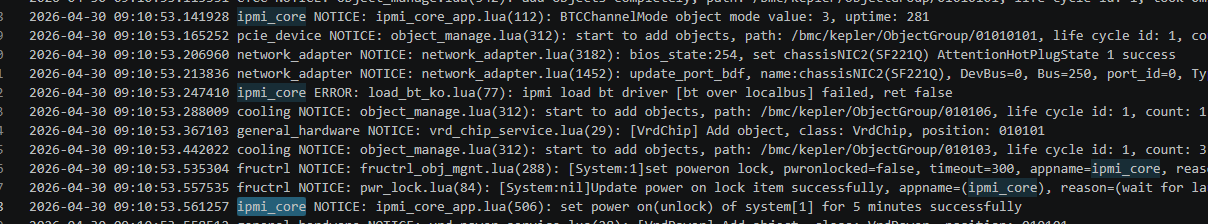

3. App.log 中关键错误
2026-04-30 09:10:53.247410 ipmi_core ERROR: load bt_ko.lua(77): ipmi load bt driver [bt over localbus] failed, ret false
2026-04-30 09:10:54.54493 unknown service NOTICE: bt.lua(185): expected service type is [btc], exit if service
2026-04-30 09:10:54.545958 unknown service NOTICE: bt_drv_init.lua(22): waiting for btc driver to initialize
  • BT 核心驱动加载失败(ipmi load bt driver failed)
  • 后续服务持续尝试等待 btc 驱动初始化,但始终未能恢复
  • 表明 BT 子系统已崩溃或退出运行
:white_check_mark: 综合判断:BT 驱动在第172次 reset 前后发生异常退出,导致后续所有带内 IPMI 命令无法正常通信,引发命令失败

1、组件拉起报错
2026-04-30 09:07:16.038999 [:0000000c] energy: lua loader error : error loading module ‘power_mgmt.json_types.PowerSupplies’ from file ‘/opt/bmc/apps/power_mgmt/json_types/PowerSupplies.lua’: /opt/bmc/apps/power_mgmt/json_types/PowerSupplies.lua:1: unexpected symbol stack traceback: [C]: at 0xffff85879138 [C]: in function ‘require’ ./opt/bmc/apps/power_mgmt/service.lua:25: in main chunk [C]: in function ‘require’ ./opt/bmc/apps/power_mgmt/lualib/power_mgmt_app.lua:12: in main chunk [C]: in function ‘require’ ./opt/bmc/apps/power_mgmt/service/main.lua:14: in main chunk /opt/bmc/skynet/lualib/loader.lua: in function </opt/bmc/skynet/lualib/loader.lua:0>
2026-04-30 09:07:16.039322 [:0000000b] energy: lua loader error : error loading module ‘thermal_mgmt.json_types.Pump’ from file ‘/opt/bmc/apps/thermal_mgmt/json_types/Pump.lua’: /opt/bmc/apps/thermal_mgmt/json_types/Pump.lua:1: unexpected symbol stack traceback: [C]: at 0xffff85879138 [C]: in function ‘require’ ./opt/bmc/apps/thermal_mgmt/service.lua:30: in main chunk [C]: in function ‘require’ ./opt/bmc/apps/thermal_mgmt/lualib/thermal_mgmt_app.lua:13: in main chunk [C]: in function ‘require’ ./opt/bmc/apps/thermal_mgmt/service/main.lua:14: in main chunk /opt/bmc/skynet/lualib/loader.lua: in function </opt/bmc/skynet/lualib/loader.lua:0>
2、组件启动检查失败
2026-04-30 09:09:31.844936 maca ERROR: init.lua(184): [power_mgmt]StartupCheck failed, error: org.freedesktop.DBus.Error.ServiceUnknown: The name bmc.kepler.power_mgmt was not provided by any .service files, check count: 8
2026-04-30 09:09:34.016794 maca ERROR: init.lua(184): [thermal_mgmt]StartupCheck failed, error: org.freedesktop.DBus.Error.ServiceUnknown: The name bmc.kepler.thermal_mgmt was not provided by any .service files, check count: 8
power_mgmt / thermal_mgmt 组件拉起失败导致框架启动检查失败,导致BMC重启了,导致这个点的ipmi命令发送失败了。要继续定位组件拉起报错的原因
