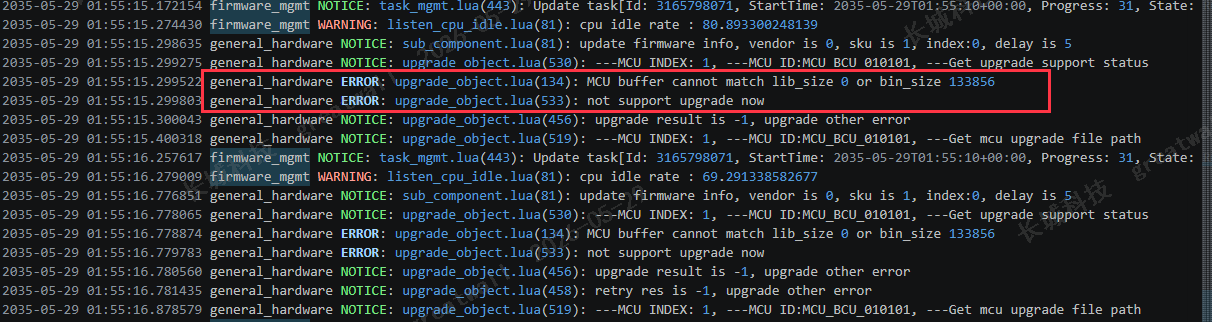

【S920S20】BCU MCU升级失败
1、S920S20机器,初始BCU MCU版本为2.03.28
2、误操作将MCU升级到了2.03.20
3、现在升级到2.03.28和最新的2.03.54都失败
升级失败时的日志信息

2035-05-29 01:55:12.271676 firmware_mgmt WARNING: listen_cpu_idle.lua(81): cpu idle rate : 76.381909547739
2035-05-29 01:55:12.588823 general_hardware NOTICE: upgrade_service_comm.lua(352): set upgarde flag to Mcu
2035-05-29 01:55:12.589126 general_hardware NOTICE: upgrade_service_mcu.lua(194): [Mcu] the system_id(1) old version is 2.03.20
2035-05-29 01:55:12.589348 general_hardware NOTICE: upgrade_service_mcu.lua(203): [Mcu] Prepare mcu upgrade finish
2035-05-29 01:55:12.591598 firmware_mgmt NOTICE: info_mgmt.lua(384): set FirmwareMode to Single
2035-05-29 01:55:12.592081 firmware_mgmt NOTICE: info_mgmt.lua(230): info_key(1_Mcu_3165798071) upgrade set_stage: DIFF_PREPARE → COMMON_PREPARE, 5
2035-05-29 01:55:12.634732 firmware_mgmt NOTICE: action.lua(86): public prepare action start
2035-05-29 01:55:12.702732 firmware_mgmt NOTICE: task_mgmt.lua(443): Update task[Id: 3165798071, StartTime: 2035-05-29T01:55:10+00:00, Progress: 5, State: Starting] successfully
2035-05-29 01:55:12.703020 firmware_mgmt NOTICE: worker: start action in worker
2035-05-29 01:55:12.778433 firmware_mgmt NOTICE: worker: execute before action script successfully
2035-05-29 01:55:13.274104 firmware_mgmt WARNING: listen_cpu_idle.lua(81): cpu idle rate : 79.292929292929
2035-05-29 01:55:13.692231 firmware_mgmt NOTICE: action.lua(92): public prepare action end
2035-05-29 01:55:13.692793 firmware_mgmt NOTICE: task_instance.lua(722): upgrade FirmwareMode Single
2035-05-29 01:55:13.800669 firmware_mgmt NOTICE: task_mgmt.lua(443): Update task[Id: 3165798071, StartTime: 2035-05-29T01:55:10+00:00, Progress: 5, State: Starting] successfully
2035-05-29 01:55:13.801273 firmware_mgmt NOTICE: info_mgmt.lua(230): info_key(1_Mcu_3165798071) upgrade set_stage: COMMON_PREPARE → PROCESS, 15
2035-05-29 01:55:13.892378 firmware_mgmt NOTICE: task_mgmt.lua(443): Update task[Id: 3165798071, StartTime: 2035-05-29T01:55:10+00:00, Progress: 15, State: Starting] successfully
2035-05-29 01:55:13.892887 firmware_mgmt NOTICE: task_instance.lua(352): sys_id=1, fw_type=Mcu, filename=/dev/shm/upgrade/3165798071/Firmware1
2035-05-29 01:55:13.897349 firmware_mgmt NOTICE: hpm_package.lua(492): get obj table: 0x26800c9bd590 for Id=29_0
2035-05-29 01:55:13.898807 general_hardware NOTICE: upgrade_subject.lua(139): [on_upgrade_process] start upgrade Mcu
2035-05-29 01:55:13.899088 general_hardware NOTICE: upgrade_service_handle.lua(78): on upgrade process start, firmware_type = Mcu
2035-05-29 01:55:13.899392 general_hardware NOTICE: upgrade_service_mcu.lua(303): [Mcu] on upgrade process, firmware_type:Mcu
2035-05-29 01:55:13.900183 general_hardware NOTICE: upgrade_subject.lua(146): [on_upgrade_process] end upgrade Mcu
2035-05-29 01:55:13.908758 general_hardware NOTICE: upgrade_service_comm.lua(71): -------uid = 00000001020302083825, mcu.Id = MCU_BCU_010101
2035-05-29 01:55:13.910921 general_hardware NOTICE: fructl_handler.lua(76): get_power_state: system[1] get power power OFF
2035-05-29 01:55:13.915789 general_hardware NOTICE: upgrade_service_comm.lua(38): -------comp.Type=0, type=0
2035-05-29 01:55:13.916243 general_hardware NOTICE: upgrade_service_comm.lua(38): -------comp.Type=2, type=0
2035-05-29 01:55:13.916471 general_hardware NOTICE: upgrade_service_comm.lua(38): -------comp.Type=2, type=0
2035-05-29 01:55:13.916699 general_hardware NOTICE: upgrade_service_comm.lua(38): -------comp.Type=2, type=0
2035-05-29 01:55:13.917239 general_hardware NOTICE: upgrade_service_comm.lua(38): -------comp.Type=2, type=0
2035-05-29 01:55:13.917905 general_hardware NOTICE: upgrade_service_comm.lua(38): -------comp.Type=2, type=0
2035-05-29 01:55:13.918220 general_hardware NOTICE: upgrade_service_comm.lua(38): -------comp.Type=2, type=0
2035-05-29 01:55:13.923800 general_hardware NOTICE: upgrade_service_comm.lua(76): -------upgrade_list cnt = 1
2035-05-29 01:55:14.024404 firmware_mgmt NOTICE: task_mgmt.lua(443): Update task[Id: 3165798071, StartTime: 2035-05-29T01:55:10+00:00, Progress: 31, State: Running] successfully
2035-05-29 01:55:14.075367 general_hardware NOTICE: upgrade_service_mcu.lua(114): [Mcu] paraller upgrade mcu start
2035-05-29 01:55:14.081297 general_hardware NOTICE: upgrade_service_comm.lua(250): firmware to be upgraded index:1
2035-05-29 01:55:14.081591 general_hardware NOTICE: upgrade_service_comm.lua(165): [McuUpgrade] system_id(1) mcu/vrd/vdm upgrading
2035-05-29 01:55:14.082200 general_hardware NOTICE: upgrade_object.lua(519): —MCU INDEX: 1, —MCU ID:MCU_BCU_010101, —Get mcu upgrade file path
2035-05-29 01:55:14.279997 firmware_mgmt WARNING: listen_cpu_idle.lua(81): cpu idle rate : 57.537688442211
2035-05-29 01:55:15.172154 firmware_mgmt NOTICE: task_mgmt.lua(443): Update task[Id: 3165798071, StartTime: 2035-05-29T01:55:10+00:00, Progress: 31, State: Running] successfully
2035-05-29 01:55:15.274430 firmware_mgmt WARNING: listen_cpu_idle.lua(81): cpu idle rate : 80.893300248139
2035-05-29 01:55:15.298635 general_hardware NOTICE: sub_component.lua(81): update firmware info, vendor is 0, sku is 1, index:0, delay is 5
2035-05-29 01:55:15.299275 general_hardware NOTICE: upgrade_object.lua(530): —MCU INDEX: 1, —MCU ID:MCU_BCU_010101, —Get upgrade support status
2035-05-29 01:55:15.299522 general_hardware ERROR: upgrade_object.lua(134): MCU buffer cannot match lib_size 0 or bin_size 133856
2035-05-29 01:55:15.299803 general_hardware ERROR: upgrade_object.lua(533): not support upgrade now
2035-05-29 01:55:15.300043 general_hardware NOTICE: upgrade_object.lua(456): upgrade result is -1, upgrade other error
2035-05-29 01:55:15.400318 general_hardware NOTICE: upgrade_object.lua(519): —MCU INDEX: 1, —MCU ID:MCU_BCU_010101, —Get mcu upgrade file path
2035-05-29 01:55:16.257617 firmware_mgmt NOTICE: task_mgmt.lua(443): Update task[Id: 3165798071, StartTime: 2035-05-29T01:55:10+00:00, Progress: 31, State: Running] successfully
2035-05-29 01:55:16.279009 firmware_mgmt WARNING: listen_cpu_idle.lua(81): cpu idle rate : 69.291338582677
2035-05-29 01:55:16.776851 general_hardware NOTICE: sub_component.lua(81): update firmware info, vendor is 0, sku is 1, index:0, delay is 5
2035-05-29 01:55:16.778065 general_hardware NOTICE: upgrade_object.lua(530): —MCU INDEX: 1, —MCU ID:MCU_BCU_010101, —Get upgrade support status
2035-05-29 01:55:16.778874 general_hardware ERROR: upgrade_object.lua(134): MCU buffer cannot match lib_size 0 or bin_size 133856
2035-05-29 01:55:16.779783 general_hardware ERROR: upgrade_object.lua(533): not support upgrade now
2035-05-29 01:55:16.780560 general_hardware NOTICE: upgrade_object.lua(456): upgrade result is -1, upgrade other error
2035-05-29 01:55:16.781435 general_hardware NOTICE: upgrade_object.lua(458): retry res is -1, upgrade other error
2035-05-29 01:55:16.878579 general_hardware NOTICE: upgrade_object.lua(519): —MCU INDEX: 1, —MCU ID:MCU_BCU_010101, —Get mcu upgrade file path
2035-05-29 01:55:17.272402 firmware_mgmt WARNING: listen_cpu_idle.lua(81): cpu idle rate : 81.298701298701
2035-05-29 01:55:17.352532 firmware_mgmt NOTICE: task_mgmt.lua(443): Update task[Id: 3165798071, StartTime: 2035-05-29T01:55:10+00:00, Progress: 31, State: Running] successfully
2035-05-29 01:55:17.973810 general_hardware NOTICE: sub_component.lua(81): update firmware info, vendor is 0, sku is 1, index:0, delay is 5
2035-05-29 01:55:17.974566 general_hardware NOTICE: upgrade_object.lua(530): —MCU INDEX: 1, —MCU ID:MCU_BCU_010101, —Get upgrade support status
2035-05-29 01:55:17.974825 general_hardware ERROR: upgrade_object.lua(134): MCU buffer cannot match lib_size 0 or bin_size 133856
2035-05-29 01:55:17.975022 general_hardware ERROR: upgrade_object.lua(533): not support upgrade now
2035-05-29 01:55:17.975227 general_hardware NOTICE: upgrade_object.lua(456): upgrade result is -1, upgrade other error
2035-05-29 01:55:17.975443 general_hardware NOTICE: upgrade_object.lua(458): retry res is -1, upgrade other error
2035-05-29 01:55:18.076300 general_hardware ERROR: upgrade_service_comm.lua(273): [vrd upgrade task] firmware upgrade failed, index:1, err:-1
2035-05-29 01:55:18.081473 general_hardware NOTICE: upgrade_service_comm.lua(285): firmware upgraded index:1
2035-05-29 01:55:18.275553 firmware_mgmt WARNING: listen_cpu_idle.lua(81): cpu idle rate : 73.350253807107
2035-05-29 01:55:18.447883 firmware_mgmt NOTICE: task_mgmt.lua(443): Update task[Id: 3165798071, StartTime: 2035-05-29T01:55:10+00:00, Progress: 31, State: Running] successfully
2035-05-29 01:55:18.449083 general_hardware NOTICE: upgrade_service_comm.lua(291): [Mcu update] all firmware upgraded, cnt:1
2035-05-29 01:55:18.449339 general_hardware NOTICE: upgrade_service_mcu.lua(152): [Mcu] paraller upgrade mcu end
2035-05-29 01:55:18.449720 general_hardware ERROR: upgrade_service_mcu.lua(327): [Mcu] upgrade process failed, firmware_type:Mcu, ok:true, ret_code: -1
2035-05-29 01:55:18.451178 general_hardware NOTICE: vrd_chip_service.lua(52): [VrdChip] listen vrd_info changed
2035-05-29 01:55:18.451508 firmware_mgmt ERROR: control.lua(205): Upgrade Mcu process failed, ret=-1
2035-05-29 01:55:18.452299 firmware_mgmt NOTICE: info_mgmt.lua(230): info_key(1_Mcu_3165798071) upgrade set_stage: PROCESS → COMMON_FINISH, 95
2035-05-29 01:55:18.508780 firmware_mgmt NOTICE: task_instance.lua(293): wait_msg_result stage=COMMON_FINISH, timeout=7200S, loop=45
2035-05-29 01:55:18.509152 firmware_mgmt NOTICE: info_mgmt.lua(341): info_key(1_Mcu_3165798071) upgrade failed, set_stage: COMMON_FINISH → COMPLETED
2035-05-29 01:55:18.540817 firmware_mgmt NOTICE: task_mgmt.lua(443): Update task[Id: 3165798071, StartTime: 2035-05-29T01:55:10+00:00, Progress: 95, State: Running] successfully
2035-05-29 01:55:18.643226 firmware_mgmt NOTICE: task_mgmt.lua(174): task[Id: 3165798071, StartTime: 2035-05-29T01:55:10+00:00, Progress: 95, State: Exception] will be destroyed after 10 minutes
2035-05-29 01:55:18.644049 firmware_mgmt NOTICE: task_mgmt.lua(443): Update task[Id: 3165798071, StartTime: 2035-05-29T01:55:10+00:00, Progress: 95, State: Exception] successfully
2035-05-29 01:55:18.644327 firmware_mgmt NOTICE: task_instance.lua(626): Upgrade 1_Mcu_3165798071 completely, pre_version=2.03.20
2035-05-29 01:55:18.644683 firmware_mgmt NOTICE: task_instance.lua(632): firmware(info key:1_Mcu_3165798071) do upgrade ret:-1, pre_version:2.03.20

如何进一步定位“MCU buffer cannot match lib_size 0 or bin_size 133856”的问题
  • lib_size 0 表示 MCU 当前固件中定义的缓冲区(buffer)大小为 0,或未能正确获取到有效缓冲区信息。
  • bin_size 133856 是待升级固件包的大小。
  • 两者无法匹配,导致升级引擎认为当前 MCU 不支持该升级包,进而反复重试均失败。

这个是因为MCU的升级包大小做过一次拓展,老的MCU返回的最大bin_size不满足现在的规格了,可以出个调试版本的BMC把这块的校验逻辑先去掉。在general_hardware
