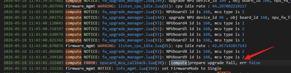

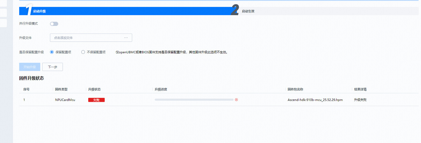

我这边升级25.53.33版本的mcu是能正常升级的,但是升级25.52.29版本mcu就会报错
报错信息:
我想问下这个闭源组件报错的原因是什么?还是说ai卡的mcu升级也有防回退机制?
2512 LTS SP1
必现
升级成功
低版本升级失败

在失败的升级包中有报错缺少对应firmware文件,可以对比下成功和失败的update.cfg,ComponentIDEx转为16进制应该有结尾是a002的firmware
行 7473: 2026-05-18 11:43:40.318397 compute NOTICE: fw_upgrade_manager.lua(93): NPUboard5 id is 160, mcu type is 2
行 7474: 2026-05-18 11:43:40.620978 compute NOTICE: fw_upgrade_manager.lua(93): NPUboard6 id is 160, mcu type is 2
行 7475: 2026-05-18 11:43:40.825342 compute NOTICE: fw_upgrade_manager.lua(93): NPUboard7 id is 160, mcu type is 2
行 7477: 2026-05-18 11:43:41.066801 compute NOTICE: fw_upgrade_manager.lua(93): NPUboard8 id is 160, mcu type is 2
行 7478: 2026-05-18 11:43:41.294586 compute NOTICE: fw_upgrade_manager.lua(93): NPUboard9 id is 160, mcu type is 2
带内也升级失败了,应该就是升级包的问题
