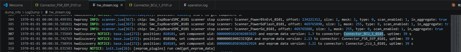

1970-01-01 00:00:38.861651 hwproxy NOTICE: cmds.lua(60): position: 010101, component uid: 00000001020302083825 signature data is empty, skip get signature data.
1970-01-01 00:00:38.862005 hwproxy NOTICE: cmds.lua(301): position: 010101, component uid: 00000001020302083825 get data without signature verification
1970-01-01 00:00:38.871489 hwproxy NOTICE: cmds.lua(60): position: 010103, component uid: 00000001050302023924 signature data is empty, skip get signature data.
1970-01-01 00:00:38.871868 hwproxy NOTICE: cmds.lua(301): position: 010103, component uid: 00000001050302023924 get data without signature verification

无签名包不会将数据从eeprom备份出来,所以本地不会有这个sr文件,一键收集时创建出空文件
