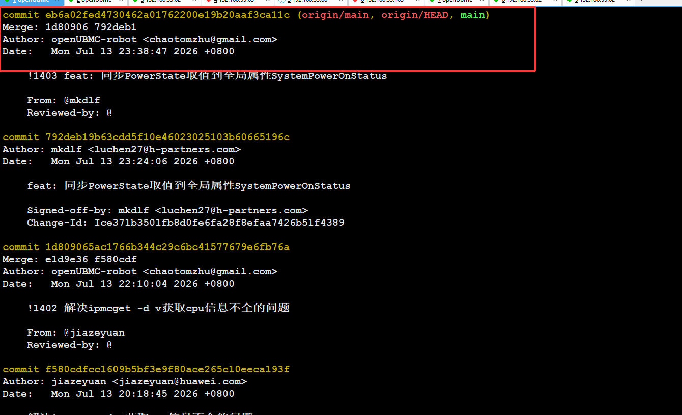

拉最新的manifest库编译出版本之后,升级bmc包之后再次升级bmc包就出错

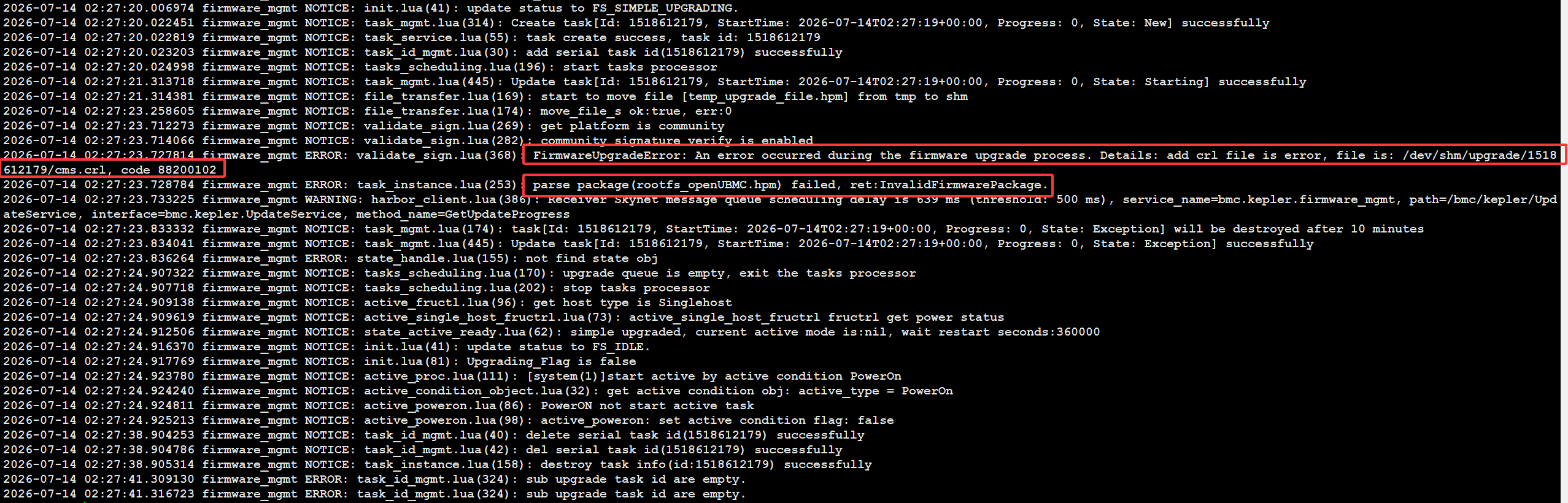

2026-07-14 02:27:23.727814 firmware_mgmt ERROR: validate_sign.lua(368): FirmwareUpgradeError: An error occurred during the firmware upgrade process. Details: add crl file is error, file is: /dev/shm/upgrade/1518612179/cms.crl, code 88200102
2026-07-14 02:27:23.728784 firmware_mgmt ERROR: task_instance.lua(253): parse package(rootfs_openUBMC.hpm) failed, ret:InvalidFirmwarePackage.
2026-07-14 02:27:23.733225 firmware_mgmt WARNING: harbor_client.lua(386): Receiver Skynet message queue scheduling delay is 639 ms (threshold: 500 ms), service_name=bmc.kepler.firmware_mgmt, path=/bmc/kepler/UpdateService, interface=bmc.kepler.UpdateService, method_name=GetUpdateProgress
2026-07-14 02:27:23.833332 firmware_mgmt NOTICE: task_mgmt.lua(174): task[Id: 1518612179, StartTime: 2026-07-14T02:27:19+00:00, Progress: 0, State: Exception] will be destroyed after 10 minutes
2026-07-14 02:27:23.834041 firmware_mgmt NOTICE: task_mgmt.lua(445): Update task[Id: 1518612179, StartTime: 2026-07-14T02:27:19+00:00, Progress: 0, State: Exception] successfully
2026-07-14 02:27:23.836264 firmware_mgmt ERROR: state_handle.lua(155): not find state obj
2026-07-14 02:27:24.907322 firmware_mgmt NOTICE: tasks_scheduling.lua(170): upgrade queue is empty, exit the tasks processor
2026-07-14 02:27:24.907718 firmware_mgmt NOTICE: tasks_scheduling.lua(202): stop tasks processor
2026-07-14 02:27:24.909138 firmware_mgmt NOTICE: active_fructl.lua(96): get host type is Singlehost

伙伴反馈:
操作1、使用tag: 26.06_2026.06.30的manifest升级BMC正常
操作2、使用主干最新manifest升级BMC后,就不能继续升级了
估计是最新manifest调整过相关校验机制,需要继续定位
开发者本地出包不能使用community_sign_webvnc_1711配置整包,只能使用community_unsign_webvnc_1711配置,否则将导致后续验签无法通过导致升级失败
我什么都没有改,直接在manifest库里 bingo build 出包,然后升级该包。升级之后再次升级这个包就报错。
