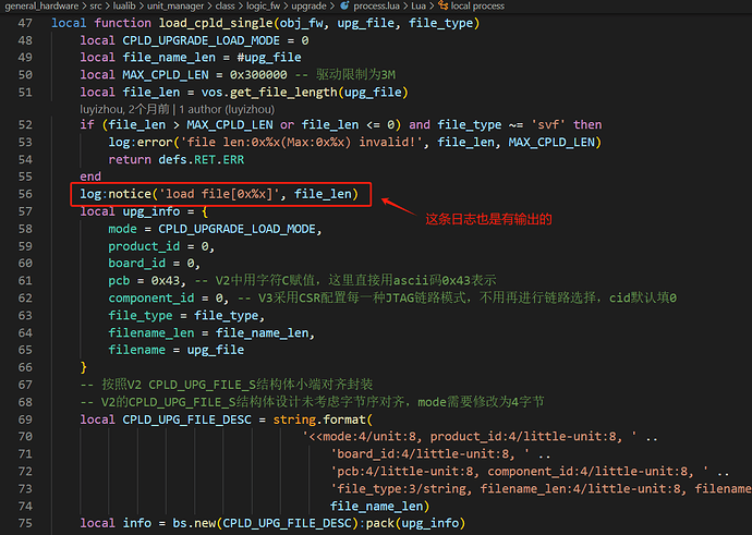

1970-01-01 00:08:37.405032 general_hardware NOTICE: process.lua(189): [cpld]_____load_cpld_single_____
1970-01-01 00:08:37.405402 general_hardware NOTICE: process.lua(54): load file[0x13bede]

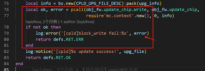

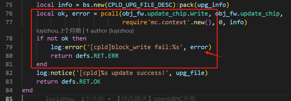

1970-01-01 00:10:37.415467 general_hardware ERROR: process.lua(77): [cpld]block_write fail:kepler.hwproxy.RequestTimeout: table: 0x0f2147da4c60
1970-01-01 00:10:37.420313 firmware_mgmt ERROR: control.lua(380): Upgrade Cpld process failed, ret=-1

结合代码排查,发现cpld hpm包签名校验,uid校验等步骤都是ok的,最终应该是在jtag写入出错了,日志显示[cpld]block_write fail:kepler.hwproxy.RequestTimeout:,
目前已经没有头绪,所以想咨询一下后面该如何定位排查?
