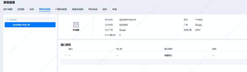

s920x20鲲鹏高性能服务器
现象

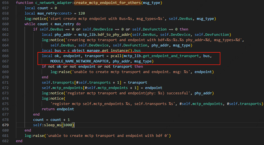

BMC除基本信息外获取不到端口信息
分析
1.分析日志定位在闭源组件 mctp_lib.get_endpoint_and_transport 这里阻塞

QLE2690网卡如何打开其的MCTP使能(也没有升级包)?同时该网卡实现MCTP通信有无固件版本要求?有要求的话,请问需要的版本是多少?

local function create_with_timeout(bus, mod_name, phy_addr, msg_type, timeout_sec)
    local result = { success = false, endpoint = nil, transport = nil }
    local co = coroutine.create(function()
        local ok, ep, tp = pcall(mctp_lib.get_endpoint_and_transport, bus, mod_name, phy_addr, msg_type)
        result.success = ok and ep and tp
        result.endpoint = ep
        result.transport = tp
    end)
    local timer = setTimeout(timeout_sec * 1000, function()
        if coroutine.status(co) == "suspended" then
            log:warning("MCTP endpoint creation timed out")
            result.success = false
    end)
    coroutine.resume(co)
    clearTimeout(timer)
    return result.success, result.endpoint, result.transport

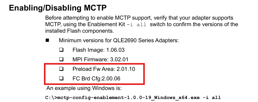

参考用户指南
User’s Guide—Fibre Channel Adapter (2600 Series) (marvell.com)
Enabling/Disabling MCTP
Before attempting to enable MCTP support, verify that your adapter supports
MCTP, using the Enablement Kit -i all switch to confirm the versions of the
installed Flash components.
 Minimum versions for QLE2690 Series Adapters:
 Flash Image: 1.06.03
 MPI Firmware: 3.02.01
 Preload Fw Area: 2.01.10
 FC Brd Cfg:2.00.06
An example using Windows is:
C:>mctp-config-enablement-1.0.0-19_Windows_x64.exe -i all
非常感谢伙伴的分享与帮助!现在在官网下载的驱动包(驱动同事给的最新的)升级完成后,其中两项即Preload Fw Area和FC Brd Cfg的版本没达到最低要求
询问过驱动管控的同事,其回复表明他给我的升级包是当前marvell官网能拿到的最新版本了,所以想来问一下伙伴这两个升级包可以从哪里获取?
