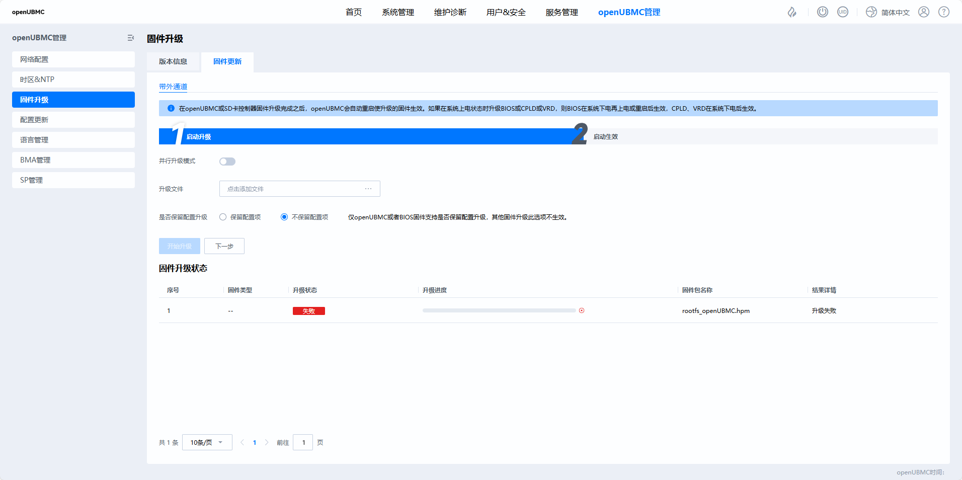

无签名UBMC上无法继续更新BMC固件
参考 v2升级openubmc指导 - 交流互助区 - openUBMC 论坛,在iBMC无签名升级ubmc后,在ubmc网页上导入BMC固件升级失败
  • 操作系统:Ubuntu 24.04
  • 软件版本:version:25.12.00.01
  • 工具版本:bingo 0.6.120
    conan 2.13.0
日志信息
参考 自签名CA创建以及HPM签名指导 - CICD SIG - openUBMC 论坛文档,完成自签名出的签名包仍不能更新
更新日志如下
1970-01-01 01:35:03.005715 firmware_mgmt ERROR: task_id_mgmt.lua(290): sub upgrade task id are empty.
1970-01-01 01:35:03.010985 firmware_mgmt ERROR: task_id_mgmt.lua(290): sub upgrade task id are empty.
1970-01-01 01:35:19.944099 web_backend NOTICE: init.lua(98): upload content length:number 76868778, remaining capacity space:number 134098944
1970-01-01 01:35:26.826272 firmware_mgmt NOTICE: active_fructl.lua(95): get host type is Singlehost
1970-01-01 01:35:26.826716 firmware_mgmt NOTICE: utils.lua(36): The file path is Local.
1970-01-01 01:35:26.828727 firmware_mgmt NOTICE: init.lua(79): Upgrading_Flag is true
1970-01-01 01:35:26.845629 firmware_mgmt NOTICE: init.lua(40): update status to FS_SIMPLE_UPGRADING.
1970-01-01 01:35:26.870997 firmware_mgmt NOTICE: task_mgmt.lua(287): Create task[Id: 2441780218, StartTime: 1970-01-01T01:35:26+00:00, Progress: 0, State: New] successfully
1970-01-01 01:35:26.871516 firmware_mgmt NOTICE: task_service.lua(59): task create success, task id: 2441780218
1970-01-01 01:35:26.872043 firmware_mgmt NOTICE: task_id_mgmt.lua(30): add serial task id(2441780218) successfully
1970-01-01 01:35:26.873629 firmware_mgmt NOTICE: tasks_scheduling.lua(121): start tasks processer
1970-01-01 01:35:26.970568 firmware_mgmt NOTICE: task_mgmt.lua(418): Update task[Id: 2441780218, StartTime: 1970-01-01T01:35:26+00:00, Progress: 0, State: Running] successfully
1970-01-01 01:35:27.020855 firmware_mgmt NOTICE: file_transfer.lua(141): start to move file [rootfs_openUBMC.hpm] from tmp to shm
1970-01-01 01:35:27.534141 firmware_mgmt NOTICE: file_transfer.lua(146): move_file_s ok:true, err:0
1970-01-01 01:35:29.673748 firmware_mgmt NOTICE: validate_sign.lua(261): get platform is community
1970-01-01 01:35:29.674747 firmware_mgmt NOTICE: action.lua(37): Validate signature successfully
1970-01-01 01:35:29.676691 firmware_mgmt NOTICE: hpm_package.lua(757): ManufacturerValidateEnabled is false, there is no need to validate manufacture_id.
1970-01-01 01:35:29.733811 firmware_mgmt ERROR: utils.lua(219): secure_tar_unzip failed: -3003
1970-01-01 01:35:29.788153 firmware_mgmt ERROR: task_instance.lua(159): parse package(rootfs_openUBMC.hpm) failed, ret:./opt/bmc/libmc/lualib/mc/utils.lua:1215: cannot open v2 persistence file.
1970-01-01 01:35:29.887747 firmware_mgmt NOTICE: task_mgmt.lua(418): Update task[Id: 2441780218, StartTime: 1970-01-01T01:35:26+00:00, Progress: 0, State: Exception] successfully
1970-01-01 01:35:30.004971 firmware_mgmt ERROR: state_handle.lua(115): not find state obj

你好,请问下这个openUBMC默认的管理IP是多少呀?我是V2版本的iBMC升级到25.09版本的openUBMC后,串口在系统运行一段时间后,没法进行输入输出了。请问下默认的openUBMC管理IP是多少呀?我试试能不能通过网络IP进入web界面端
无签名UBMC 升级 无签名UBMC ,前提条件为:
  1. 无加密 ,hpm_encrypt配置enable=false或去掉hpm_encrypt配置
[hpm_encrypt]
enable=false
  1. manifest.yml中firmware_mgmt 的特性community_enable 为true
- conan: firmware_mgmt
    options:
    community_enable: true
  1. 使用bingo 构建
按照指导修改配置后,出包在网页上更新没有报错
但是一些修改 比如添加my_app组件未生效
是不是ubmc又自动回退了
执行ipmcget -d version 查看Build time 行时间是否为你新的固件构建时间。
显示为1月6号版本,就是之前v2更新到ubmc的那个版本
  1. 一键收集日志,查看/var/log/app.log里面是哪里报错导致的回滚,特别是搜索my_app组件相关的行。
  2. 或者去掉my_app组件,构建升级固件查看是否会回退。
去掉my_app组件后,编出的固件包升级后还是会回退
固件更新相关的log如下:

2026-01-14 16:39:48.870476 firmware_mgmt NOTICE: task_mgmt.lua(418): Update task[Id: 2340558203, StartTime: 2026-01-14T16:38:37+00:00, Progress: 36, State: Running] successfully
2026-01-14 16:39:49.654265 bmc_upgrade NOTICE: decompress_img.lua(100): extract img in cgroup successfully.
2026-01-14 16:39:49.771216 bmc_upgrade NOTICE: decompress_img.lua(119): extract img file sucessfully
2026-01-14 16:39:49.970622 firmware_mgmt NOTICE: task_mgmt.lua(418): Update task[Id: 2340558203, StartTime: 2026-01-14T16:38:37+00:00, Progress: 37, State: Running] successfully
2026-01-14 16:39:50.006980 bmc_upgrade NOTICE: process.lua(74): end extract rootfs img to flash
2026-01-14 16:39:50.024534 bmc_upgrade NOTICE: scm3.lua(80): Set BMC upgrade flag ok
2026-01-14 16:39:50.027369 bmc_upgrade NOTICE: update_mgmt.lua(81): update LastAction to 1
2026-01-14 16:39:50.029316 bmc_upgrade NOTICE: update_mgmt.lua(125): expected partition is refreshed by Upgrade, ExpectedActivePartition = 2, ExpectedBackupPartition = 0
2026-01-14 16:39:50.031983 bmc_upgrade NOTICE: update_mgmt.lua(81): update UpdateStage to 0
2026-01-14 16:39:50.047949 firmware_mgmt NOTICE: info_mgmt.lua(240): info_key(1_BMC_2340558203) upgrade set_stage: PROCESS -> COMMON_FINISH, 95
2026-01-14 16:39:50.072442 firmware_mgmt NOTICE: task_instance.lua(266): wait_msg_result stage=COMMON_FINISH, timeout=7200S, loop=613
2026-01-14 16:39:50.072937 firmware_mgmt NOTICE: action.lua(96): public finish action start
2026-01-14 16:39:50.107163 firmware_mgmt NOTICE: [worker](9): start action in worker
2026-01-14 16:39:50.137558 firmware_mgmt NOTICE: task_mgmt.lua(418): Update task[Id: 2340558203, StartTime: 2026-01-14T16:38:37+00:00, Progress: 95, State: Running] successfully
2026-01-14 16:39:50.175200 firmware_mgmt NOTICE: [worker](14): execute finish action script successfully
2026-01-14 16:39:51.102489 firmware_mgmt NOTICE: action.lua(102): public finish action end
2026-01-14 16:39:51.102857 firmware_mgmt NOTICE: info_mgmt.lua(240): info_key(1_BMC_2340558203) upgrade set_stage: COMMON_FINISH -> DIFF_FINISH, 95
2026-01-14 16:39:51.209041 general_hardware ERROR: upgrade_subject.lua(124): [on_upgrade_finish] does not exists the observer, firmware_type:BMC
2026-01-14 16:39:51.215704 firmware_mgmt NOTICE: active_info.lua(235): register: FirmwareId = BMC FirmwareType = BMC ActiveCondition = None ActiveMode = ForceResetBMC ActiveStatus = Ready SystemId = nil
2026-01-14 16:39:51.229283 firmware_mgmt NOTICE: active_info.lua(126): Insert FirmwareActive info [FirmwareId:BMC] to table [t_fw_active_objs]
2026-01-14 16:39:51.259372 bmc_upgrade NOTICE: upgrade.lua(262): [BMCpgrade] Register active action successfully
2026-01-14 16:39:51.260632 bmc_upgrade NOTICE: upgrade.lua(292): send signal RestoreFactorySettings to oms
2026-01-14 16:39:51.281787 oms ERROR: recover.lua(361): No factory restore point is set.
2026-01-14 16:39:51.283219 oms NOTICE: recover.lua(222): upgrade BMC and recover manufacturer default configuration, system_id = 1
2026-01-14 16:39:51.289515 firmware_mgmt NOTICE: info_mgmt.lua(240): info_key(1_BMC_2340558203) upgrade set_stage: DIFF_FINISH -> CLEAR, 95
2026-01-14 16:39:51.303968 firmware_mgmt NOTICE: task_instance.lua(266): wait_msg_result stage=CLEAR, timeout=600S, loop=0
2026-01-14 16:39:51.304807 firmware_mgmt NOTICE: task_instance.lua(583): firmware(info key:1_BMC_2340558203) do upgrade ret:0, pre_version:25.12.00.01
2026-01-14 16:39:51.304451 firmware_mgmt NOTICE: task_instance.lua(577): Upgrade 1_BMC_2340558203 completely, pre_version=25.12.00.01
2026-01-14 16:39:51.378911 oms WARNING: init.lua(97): nil:210 > app_preloader.lua:-1 > recover.lua:364: Failed to find the restore point when restoring the factory settings.
2026-01-14 16:39:51.379645 oms ERROR: app_preloader.lua(212): ./opt/bmc/apps/oms/lualib/config/config_init.lua:31: app(oms/service/main) count(1) pcall failed(NoRestorePoint: Failed to find the restore point when restoring the factory settings.)
2026-01-14 16:39:51.477088 firmware_mgmt NOTICE: info_mgmt.lua(240): info_key(1_BMC_2340558203) upgrade set_stage: CLEAR -> COMPLETED, 100
2026-01-14 16:39:51.579329 firmware_mgmt NOTICE: task_mgmt.lua(418): Update task[Id: 2340558203, StartTime: 2026-01-14T16:38:37+00:00, Progress: 100, State: Completed] successfully
2026-01-14 16:39:51.579753 firmware_mgmt NOTICE: utils.lua(172): Does not exists the same Id obj
2026-01-14 16:39:52.060671 firmware_mgmt NOTICE: tasks_scheduling.lua(126): upgrade queue is empty, exit the tasks processer
2026-01-14 16:39:52.061077 firmware_mgmt NOTICE: tasks_scheduling.lua(138): stop tasks processer
2026-01-14 16:39:52.062824 firmware_mgmt NOTICE: active_fructl.lua(95): get host type is Singlehost
2026-01-14 16:39:52.063277 firmware_mgmt NOTICE: active_single_host_fructrl.lua(61): active_single_host_fructrl fructrl get power status
2026-01-14 16:39:52.069604 firmware_mgmt NOTICE: state_simple_upgrading.lua(101): simple upgraded, current active mode is:ForceResetBMC, wait restart seconds:360000
2026-01-14 16:39:52.074599 firmware_mgmt NOTICE: init.lua(40): update status to FS_WAIT_RESTART.
2026-01-14 16:39:52.082342 firmware_mgmt NOTICE: active_comm.lua(101): start exec bmc reset
2026-01-14 16:39:58.203253 firmware_mgmt NOTICE: active_comm.lua(110): Force Reboot BMC successfully
2026-01-14 16:39:58.331442 om_priv ERROR: l_sig_handler.c(350): ========== FATAL SIGNAL CAUGHT ========== PackageBuildTime: 20260106171409 PID: 2584, PPID: 1 Program: om_priv Signal: 15 (SIGTERM) - Termination signal Signal code: 0 Sending PID: 1  ========== END OF CRASH REPORT ==========
2026-01-14 16:39:58.331528 om_priv ERROR: l_sig_handler.c(310): === Stack Backtrace ===
2026-01-14 16:39:58.331561 om_priv ERROR: l_sig_handler.c(310): core-info-skynet-15-om_priv-20260106171409
2026-01-14 16:39:58.331590 om_priv ERROR: l_sig_handler.c(310): === Source Code Backtrace ===
2026-01-14 16:39:58.331634 om_priv ERROR: l_sig_handler.c(310): [0] /lib64/libc.so.6(+0x7f104) [0xffff90992104]
2026-01-14 16:39:58.331677 om_priv ERROR: l_sig_handler.c(310): [1] /lib64/libc.so.6(+0x8407c) [0xffff9099707c]
2026-01-14 16:39:58.331695 om_priv ERROR: l_sig_handler.c(310): [2] om_priv(skynet_start+0x300) [0xaaaae4cd9a60]
2026-01-14 16:39:58.331711 om_priv ERROR: l_sig_handler.c(310): [3] om_priv(main+0x290) [0xaaaae4cd5510]
2026-01-14 16:39:58.331734 om_priv ERROR: l_sig_handler.c(310): [4] /lib64/libc.so.6(+0x27608) [0xffff9093a608]
2026-01-14 16:39:58.331753 om_priv ERROR: l_sig_handler.c(310): [5] /lib64/libc.so.6(__libc_start_main+0x94) [0xffff9093a6e4]
2026-01-14 16:39:58.331799 om_priv ERROR: l_sig_handler.c(310): [6] om_priv(_start+0x30) [0xaaaae4cd5630]
2026-01-14 16:39:58.331812 om_priv ERROR: l_sig_handler.c(310): === Source Code Analysis ===
2026-01-14 16:39:58.331837 om_priv ERROR: l_sig_handler.c(310): To get exact source lines, run these commands:
2026-01-14 16:39:58.331860 om_priv ERROR: l_sig_handler.c(310): Frame 0: addr2line -e /lib64/libc.so.6 -f -C 0x7f104
2026-01-14 16:39:58.331878 om_priv ERROR: l_sig_handler.c(310): Frame 1: addr2line -e /lib64/libc.so.6 -f -C 0x8407c
2026-01-14 16:39:58.331898 om_priv ERROR: l_sig_handler.c(310): Frame 2: addr2line -e om_priv -f -C skynet_start+0x300
2026-01-14 16:39:58.332704 om_priv ERROR: l_sig_handler.c(310): Frame 3: addr2line -e om_priv -f -C main+0x290
2026-01-14 16:39:58.332741 om_priv ERROR: l_sig_handler.c(310): Frame 4: addr2line -e /lib64/libc.so.6 -f -C 0x27608
2026-01-14 16:39:58.364616 security ERROR: l_sig_handler.c(350): ========== FATAL SIGNAL CAUGHT ========== PackageBuildTime: 20260106171409 PID: 2391, PPID: 1 Program: security Signal: 15 (SIGTERM) - Termination signal Signal code: 0 Sending PID: 1  ========== END OF CRASH REPORT ==========
2026-01-14 16:39:58.364674 security ERROR: l_sig_handler.c(310): === Stack Backtrace ===
2026-01-14 16:39:58.364722 security ERROR: l_sig_handler.c(310): core-info-skynet-15-security-20260106171409
2026-01-14 16:39:58.364746 security ERROR: l_sig_handler.c(310): === Source Code Backtrace ===
2026-01-14 16:39:58.451397 Remove pcie drivers
2026-01-14 16:39:58.586116 killall busybox_x
2026-01-14 16:39:58.658629 Remove cdev_veth_drv successfully.
2026-01-14 16:39:58.727148 Remove bmc_tpcm_drv successfully.
2026-01-14 16:39:59.525569 Remove bmc_veth_drv successfully.
2026-01-14 16:40:02.195805 Remove bmc_cdev_drv successfully.
2026-01-14 16:40:02.305264 Remove bmc_edma_drv successfully.
2026-01-14 16:40:02.395511 Remove bmc_hisport_drv successfully.
 bios ERROR: bios file not exist
从日志看,是升级成功了。应该重启后,有服务启动失败,maca检查没通过,导致bmc回滚复位了。
怎么解决服务启动失败,bmc回滚的问题呢
