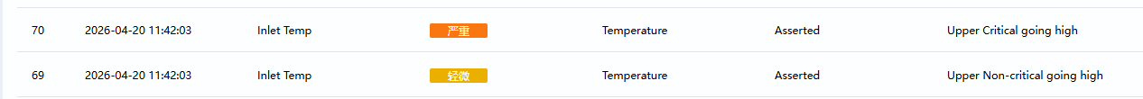

系统记录了两条事件:
  • 严重告警:Temperature Asserted Upper Critical going high
  • 轻微告警:Temperature Asserted Upper Non-critical going high
并由此引发疑问:为何会同时触发“轻微”和“严重”两级告警?这是否符合规范?

这也与您提供的截图一致:
Inlet Temp 轻微 Temperature Asserted Upper Non-critical going high
Inlet Temp 严重 Temperature Asserted Upper Critical going high
说明两起事件是分步发生但几乎同时记录,属于正常行为。
