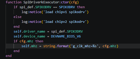

开始有控制权的问题,硬件已经解决了,升级页面显示成功,其实没有写进去,怀疑是flash型号问题,目前已经换了推荐的flash型号MX25U12832FM2I02H,大小是128M,还是有这种错误,spi_flash.lua代码里找不到,请大神协助帮忙看看。
[升级过程日志如下]

2026-04-20 17:54:40.987357 bios NOTICE: upgrade_executor.lua(177): load chipv1 spikodrv

2026-04-20 17:54:54.857824 bios ERROR: spi_flash.lua(105): File does not seem to match flash data. First mismatch at 0 - 10240
2026-04-20 17:54:54.858998 bios ERROR: spi_flash.lua(143): write data to spi flash failed

2026-04-21 10:54:06.105793 bios NOTICE: upgrade_executor.lua(177): load chipv1 spikodrv

2026-04-21 10:54:20.285332 bios ERROR: spi_flash.lua(105): File does not seem to match flash data. First mismatch at 0 - 10240
2026-04-21 10:54:20.287299 bios ERROR: spi_flash.lua(143): write data to spi flash failed
2026-04-21 10:54:20.290020 bios ERROR: spi_flash.lua(163): erase and write block flash failed, retry time: 1cur_block: 1, total block: 88
2026-04-21 10:54:20.317519 bios ERROR: spi_flash.lua(105): File does not seem to match flash data. First mismatch at 0 - 10240
2026-04-21 10:54:20.319226 bios ERROR: spi_flash.lua(143): write data to spi flash failed
2026-04-21 10:54:20.321376 bios ERROR: spi_flash.lua(163): erase and write block flash failed, retry time: 2cur_block: 1, total block: 88
2026-04-21 10:54:20.345476 bios ERROR: spi_flash.lua(105): File does not seem to match flash data. First mismatch at 0 - 10240
2026-04-21 10:54:20.347060 bios ERROR: spi_flash.lua(143): write data to spi flash failed
2026-04-21 10:54:20.348942 bios ERROR: spi_flash.lua(163): erase and write block flash failed, retry time: 3cur_block: 1, total block: 88
2026-04-21 10:54:20.418407 bios ERROR: spi_flash.lua(105): File does not seem to match flash data. First mismatch at 65536 - 75776
2026-04-21 10:54:20.420687 bios ERROR: spi_flash.lua(143): write data to spi flash failed
2026-04-21 10:54:20.422634 bios ERROR: spi_flash.lua(163): erase and write block flash failed, retry time: 1cur_block: 2, total block: 88
2026-04-21 10:54:20.448879 bios ERROR: spi_flash.lua(105): File does not seem to match flash data. First mismatch at 65536 - 75776
2026-04-21 10:54:20.450520 bios ERROR: spi_flash.lua(143): write data to spi flash failed
2026-04-21 10:54:20.452407 bios ERROR: spi_flash.lua(163): erase and write block flash failed, retry time: 2cur_block: 2, total block: 88
2026-04-21 10:54:20.478939 bios ERROR: spi_flash.lua(105): File does not seem to match flash data. First mismatch at 65536 - 75776
2026-04-21 10:54:20.480424 bios ERROR: spi_flash.lua(143): write data to spi flash failed
2026-04-21 10:54:20.481968 bios ERROR: spi_flash.lua(163): erase and write block flash failed, retry time: 3cur_block: 2, total block: 88
2026-04-21 10:54:20.540065 bios ERROR: spi_flash.lua(105): File does not seem to match flash data. First mismatch at 131072 - 141312
2026-04-21 10:54:20.541602 bios ERROR: spi_flash.lua(143): write data to spi flash failed
2026-04-21 10:54:20.542824 bios ERROR: spi_flash.lua(163): erase and write block flash failed, retry time: 1cur_block: 3, total block: 88
2026-04-21 10:54:20.574517 bios ERROR: spi_flash.lua(105): File does not seem to match flash data. First mismatch at 131072 - 141312
2026-04-21 10:54:20.575921 bios ERROR: spi_flash.lua(143): write data to spi flash failed
2026-04-21 10:54:20.577092 bios ERROR: spi_flash.lua(163): erase and write block flash failed, retry time: 2cur_block: 3, total block: 88
2026-04-21 10:54:20.600184 bios ERROR: spi_flash.lua(105): File does not seem to match flash data. First mismatch at 131072 - 141312
2026-04-21 10:54:20.602004 bios ERROR: spi_flash.lua(143): write data to spi flash failed
2026-04-21 10:54:20.603308 bios ERROR: spi_flash.lua(163): erase and write block flash failed, retry time: 3cur_block: 3, total block: 88
2026-04-21 10:54:20.663323 bios ERROR: spi_flash.lua(105): File does not seem to match flash data. First mismatch at 196608 - 206848
2026-04-21 10:54:20.664380 bios ERROR: spi_flash.lua(143): write data to spi flash failed

硬件提供了一个思路,软件能否在哪里修改SPI总线的速度,这个可以调整吗?
最终还是硬件把MISO的下拉电阻去掉了,就可以正常读写flash了,改SPI的速率也不行。
