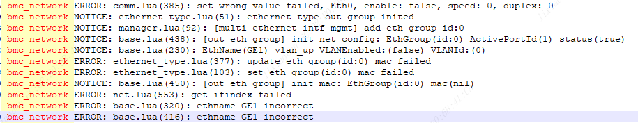

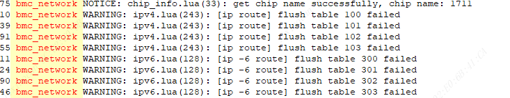

使用串口命令行回滚到2603版本,再不保留配置升级到LTS SP2版本后,BMC网络还是不通
app日志显示
Line 136: 1970-01-01 08:00:59.497501 unknown_service NOTICE: main.lua(46): bmc_network start proc.

	Line 260: 2026-06-24 15:44:35.571075 bmc_network NOTICE: chip_info.lua(33): get chip name successfully, chip name: 1711
	Line 267: 2026-06-24 15:44:35.688610 bmc_network WARNING: ipv4.lua(243): [ip route] flush table 100 failed
	Line 271: 2026-06-24 15:44:36.046339 bmc_network WARNING: ipv4.lua(243): [ip route] flush table 101 failed
	Line 283: 2026-06-24 15:44:36.371991 bmc_network WARNING: ipv4.lua(243): [ip route] flush table 102 failed
	Line 296: 2026-06-24 15:44:36.711055 bmc_network WARNING: ipv4.lua(243): [ip route] flush table 103 failed
	Line 305: 2026-06-24 15:44:37.042311 bmc_network WARNING: ipv6.lua(128): [ip -6 route] flush table 300 failed
	Line 309: 2026-06-24 15:44:37.256624 bmc_network WARNING: ipv6.lua(128): [ip -6 route] flush table 301 failed
	Line 336: 2026-06-24 15:44:37.535090 bmc_network WARNING: ipv6.lua(128): [ip -6 route] flush table 302 failed
	Line 386: 2026-06-24 15:44:37.918646 bmc_network WARNING: ipv6.lua(128): [ip -6 route] flush table 303 failed

	Line 1169: 2026-06-24 15:44:50.766508 bmc_network WARNING: ipv4.lua(243): [ip route] flush table 100 failed
	Line 1173: 2026-06-24 15:44:50.993913 bmc_network WARNING: ipv4.lua(243): [ip route] flush table 101 failed
	Line 1183: 2026-06-24 15:44:51.304706 bmc_network WARNING: ipv4.lua(243): [ip route] flush table 102 failed
	Line 1184: 2026-06-24 15:44:51.480002 bmc_network WARNING: ipv4.lua(243): [ip route] flush table 103 failed
	Line 1190: 2026-06-24 15:44:51.713013 bmc_network WARNING: ipv6.lua(128): [ip -6 route] flush table 300 failed
	Line 1259: 2026-06-24 15:44:52.015424 bmc_network WARNING: ipv6.lua(128): [ip -6 route] flush table 301 failed
	Line 1318: 2026-06-24 15:44:52.383789 bmc_network WARNING: ipv6.lua(128): [ip -6 route] flush table 302 failed
	Line 1380: 2026-06-24 15:44:52.740490 bmc_network WARNING: ipv6.lua(128): [ip -6 route] flush table 303 failed

	Line 1544: 2026-06-24 15:44:55.711411 bmc_network NOTICE: network_init.lua(173): Init eth speed duplex
	Line 1545: 2026-06-24 15:44:55.712676 bmc_network ERROR: comm.lua(385): set wrong value failed, Eth0, enable: false, speed: 0, duplex: 0
	Line 1563: 2026-06-24 15:44:55.916169 bmc_network NOTICE: ethernet_type.lua(51): ethernet type out group inited
	Line 1564: 2026-06-24 15:44:55.925013 bmc_network NOTICE: manager.lua(92): [multi_ethernet_intf_mgmt] add eth group id:0
	Line 1565: 2026-06-24 15:44:55.932180 bmc_network NOTICE: base.lua(438): [out eth group] init net config: EthGroup(id:0) ActivePortId(1) status(true)
	Line 1566: 2026-06-24 15:44:55.942592 bmc_network NOTICE: base.lua(230): EthName(GE1) vlan_up VLANEnabled:(false) VLANId:(0)
	Line 1567: 2026-06-24 15:44:55.944221 bmc_network ERROR: ethernet_type.lua(377): update eth group(id:0) mac failed
	Line 1568: 2026-06-24 15:44:55.945748 bmc_network ERROR: ethernet_type.lua(103): set eth group(id:0) mac failed
	Line 1569: 2026-06-24 15:44:55.952320 bmc_network NOTICE: base.lua(450): [out eth group] init mac: EthGroup(id:0) mac(nil)
	Line 1575: 2026-06-24 15:44:56.027410 bmc_network ERROR: net.lua(553): get ifindex failed
	Line 1576: 2026-06-24 15:44:56.035434 bmc_network ERROR: base.lua(320): ethname GE1 incorrect
	Line 1577: 2026-06-24 15:44:56.036960 bmc_network ERROR: base.lua(416): ethname GE1 incorrect

好的,根据您提供的上下文信息,我将对您的问题进行分析。
从2603版本升级到LTS SP2版本后,BMC网络不通的问题,其根本原因在于新版本的bmc_network组件在处理网络接口时,接口名称发生了不兼容的变更,导致初始化失败。
问题原因分析
根据您提供的app日志,问题根因可以定位为以下几点:
  1. 接口名称冲突与初始化失败:
    • 日志中显示 bmc_network 组件成功初始化了两个MAC地址对象,分别对应 eth2 和 eth0。
    • 然而,在后续的初始化过程中,bmc_network 尝试对一个名为 GE1 的接口名进行操作,并出现了大量严重错误。
    • 核心错误日志如下:
      • Line 1575: bmc_network ERROR: net.lua(553): get ifindex failed
      • Line 1576: bmc_network ERROR: base.lua(320): ethname GE1 incorrect
      • Line 1577: bmc_network ERROR: base.lua(416): ethname GE1 incorrect
    • 这表明,升级后的 bmc_network 代码使用 GE1 作为逻辑接口名称,但系统内核中并不识别此名称,导致无法获取其网络接口索引(ifindex)。
  2. ARP及ICMP报文发送失败:
    • 由于GE1接口名无效,后续所有依赖此接口的操作均失败。
    • Line 2021: bmc_network ERROR: arp.lua(92): GE1 send arp result is : fail, content is : ... arp send fail: No such device[19]
    • Line 2535: bmc_network ERROR: icmpv6.lua(30): GE1 send ipv6 na result is : fail, content is : get GE1 mac address failed: errno(19)
    • 报错 No such device[19] 进一步确认了系统找不到名为 GE1 的网络设备。
  3. 网络连接彻底中断:
    • 由于核心的地址解析协议(ARP)和邻居发现(ICMPv6 NA)报文无法发送,系统在网络层面上无法被其他设备发现和通信,导致网络完全不通。
    • 网络服务虽然启动,但所有网络流量都会因为找不到正确的出口设备而被丢弃。
问题根因总结
LTS SP2版本的 bmc_network 组件使用了新的内部逻辑接口名 GE1,而系统底层识别的依然是传统的物理接口名(如 eth0, eth2)。由于 GE1 这一中间逻辑名未被正确映射或创建到系统的网络设备树中,导致 bmc_network 在初始化网络、设置路由、发送报文等所有环节均因“找不到设备”而失败,最终造成网络不通。
解决方案建议
根据上下文信息,根本的解决方法是修改 bmc_network 组件的代码逻辑,使其不依赖 GE1 这样的逻辑接口名,而是直接使用系统能够识别的物理接口名(如 eth0、eth1 等)来匹配MAC地址和执行网络操作。
  • 逻辑匹配方式: 代码不应通过“网口资源树对象”来匹配MAC地址,而应通过物理接口的名称(ethname,如 eth2)来匹配MAC地址,以避免因升级后接口命名逻辑变更带来的时序问题和兼容性问题。
