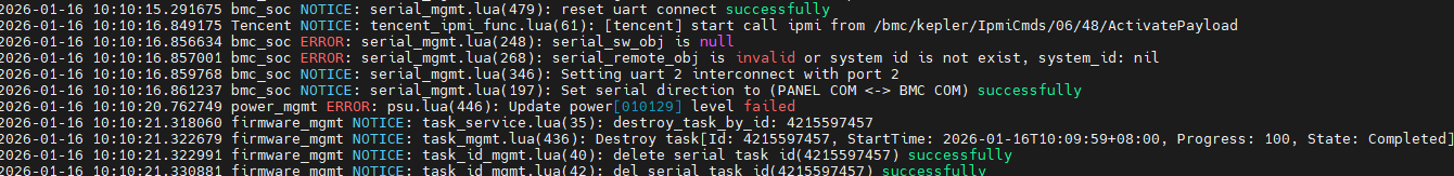

  • 系统信息:运行 bmc_soc 版本为 1.80.25@openubmc/stable
:page_facing_up: 相关日志分析
从提供的日志片段可提取关键信息:
2026-01-16 10:10:15.291675 bmc_soc NOTICE: serial_mgmt.lua(479): reset uart connect successfully
2026-01-16 10:10:16.849175 Tencent tencent_ipmi_func.lua(61): [tencent] start call ipmi from /bmc/kepler/IpmiCmds/06/48/ActivatePayload
2026-01-16 10:10:16.856634 bmc_soc ERROR: serial_mgmt.lua(248): serial_sw_obj is null
2026-01-16 10:10:16.857001 bmc_soc ERROR: serial_mgmt.lua(268): serial_remote_obj is invalid or system id is not exist, system_id: nil
2026-01-16 10:10:16.859768 bmc_soc NOTICE: serial_mgmt.lua(346): Setting uart interconnect with port 2
2026-01-16 10:10:16.861237 bmc_soc NOTICE: serial_mgmt.lua(197): Set serial direction to (PANEL COM <-> BMC COM) successfully
日志解读:
日志条目 含义
reset uart connect successfully UART连接已重置,初始化正常
serial_sw_obj is null 关键的串行交换对象未创建,可能原因:驱动未加载或配置缺失
serial_remote_obj is invalid or system id is not exist 远端系统对象无效或系统ID未识别,可能导致无法建立到OS的链路
Set serial direction to (PANEL COM <-> BMC COM) 串行方向被设置为“面板串口 ↔ BMC”,而非 ↔ OS
:warning: 核心问题:SOL成功激活,但串行通道方向仍停留在BMC内部通信模式(PANEL COM ↔ BMC COM),并未切换至“BMC ↔ OS”或“HOST OS”路径。

看看 rmcpd 组件是否是 1.90.72 及以上版本呢
rmcpd/1.90.70@openubmc/stable#5c1a758610a587363687f2a321c51caf%1764674869.266
使用新版本试试呢,该问题在 1.90.72 版本修复
