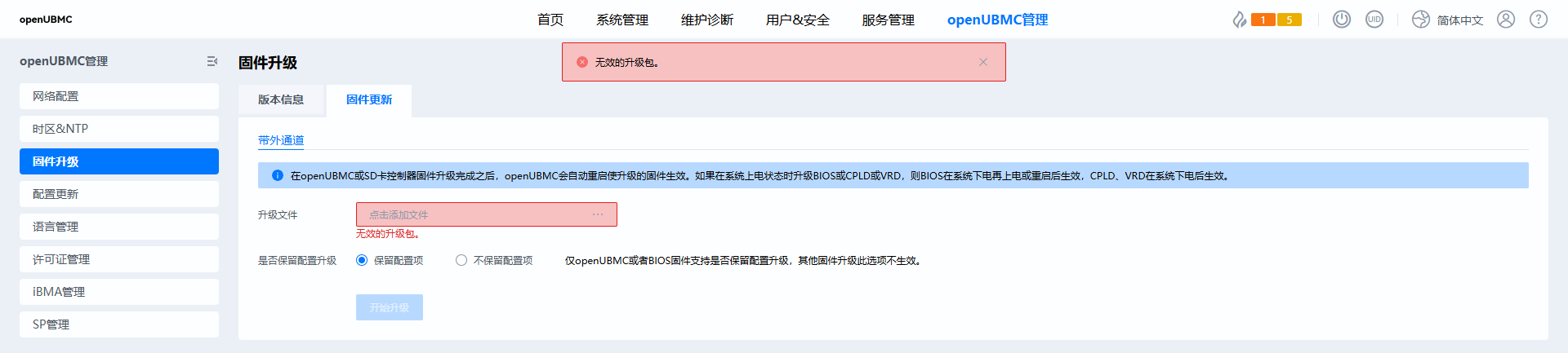

重新按照自签名CA创建以及HPM签名指导制作了新的证书,替换后编译可通过
但是更新时会显示无效的升级包
app.log报错如下:
1970-01-01 02:42:09.877524 web_backend NOTICE: init.lua(98): upload content length:number 68969326, remaining capacity space:number 134094848
1970-01-01 02:42:16.259647 firmware_mgmt NOTICE: active_fructl.lua(95): get host type is Singlehost
1970-01-01 02:42:16.260178 firmware_mgmt NOTICE: utils.lua(35): The file path is local.
1970-01-01 02:42:16.269387 firmware_mgmt NOTICE: init.lua(33): update status to FS_SIMPLE_UPGRADING.
1970-01-01 02:42:16.283164 firmware_mgmt NOTICE: task_service.lua(49): task create success, task id: 3113431330
1970-01-01 02:42:16.337004 firmware_mgmt NOTICE: file_transfer.lua(145): start to move file [rootfs_openUBMC.hpm] from tmp to shm
1970-01-01 02:42:16.801839 firmware_mgmt NOTICE: file_transfer.lua(150): move_file_s ok:true, err:0
1970-01-01 02:42:17.249509 firmware_mgmt WARNING: init.lua(97): nil:294 > validate_sign.lua:-1 > validate_sign.lua:172: An error occurred during the firmware upgrade process. Details: verify signature error, code 88200004
1970-01-01 02:42:17.249874 firmware_mgmt ERROR: validate_sign.lua(296): FirmwareUpgradeError: An error occurred during the firmware upgrade process. Details: verify signature error, code 88200004
1970-01-01 02:42:17.250614 firmware_mgmt ERROR: control.lua(321): parse package(rootfs_openUBMC.hpm) failed, ret:nil.
1970-01-01 02:42:17.458282 firmware_mgmt NOTICE: active_fructl.lua(95): get host type is Singlehost
1970-01-01 02:42:17.458629 firmware_mgmt NOTICE: active_single_host_fructrl.lua(61): active_single_host_fructrl fructrl get power status
1970-01-01 02:42:17.463160 firmware_mgmt NOTICE: state_simple_upgrading.lua(87): simple upgraded, current active mode is:nil, wait restart seconds:30000
1970-01-01 02:42:17.470158 firmware_mgmt NOTICE: init.lua(33): update status to FS_IDLE.

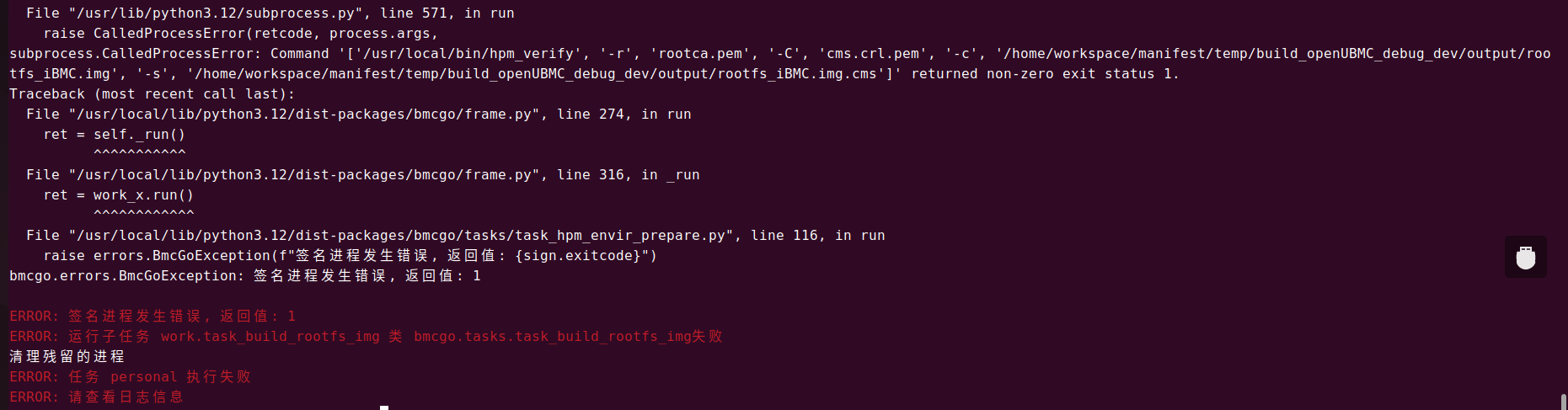

hpm_verify -r rootca.pem -C cms.crl.pem -c /home/workspace/manifest/temp/build_openUBMC_debug_dev/output/rootfs_iBMC.img -s /home/workspace/manifest/temp/build_openUBMC_debug_dev/output/rootfs_iBMC.img.cms
ERROR: 执行命令 /usr/local/bin/hpm_verify -r rootca.pem -C cms.crl.pem -c /home/workspace/manifest/temp/build_openUBMC_debug_dev/output/rootfs_iBMC.img -s /home/workspace/manifest/temp/build_openUBMC_debug_dev/output/rootfs_iBMC.img.cms 错误, 日志: /home/workspace/manifest/temp/log/task.log
Process SignProcess-9:9:2:
File “/usr/lib/python3.12/multiprocessing/process.py”, line 314, in _bootstrap
self.run()
File “/usr/local/lib/python3.12/dist-packages/bmcgo/tasks/task_hpm_envir_prepare.py”, line 31, in run
self.work.signature(f"{self.config.work_out}/rootfs_iBMC.img",
File “/usr/local/lib/python3.12/dist-packages/bmcgo/tasks/task.py”, line 280, in signature
self.run_command(f"hpm_verify -r rootca.pem -C cms.crl.pem -c {unsigned_file} -s {cms_output}“)
File “/usr/local/lib/python3.12/dist-packages/bmcgo/tasks/task.py”, line 257, in run_command
return self.tools.run_command(command, ignore_error, sudo, **kwargs)
File “/usr/local/lib/python3.12/dist-packages/bmcgo/utils/tools.py”, line 665, in run_command
raise e
File “/usr/local/lib/python3.12/dist-packages/bmcgo/utils/tools.py”, line 655, in run_command
ret = subprocess.run(command, stdout=log_fd, stderr=log_fd, check=check, timeout=timeout)
File “/usr/lib/python3.12/subprocess.py”, line 571, in run
subprocess.CalledProcessError: Command ‘[’/usr/local/bin/hpm_verify’, ‘-r’, ‘rootca.pem’, ‘-C’, ‘cms.crl.pem’, ‘-c’, ‘/home/workspace/manifest/temp/build_openUBMC_debug_dev/output/rootfs_iBMC.img’, ‘-s’, ‘/home/workspace/manifest/temp/build_openUBMC_debug_dev/output/rootfs_iBMC.img.cms’]’ returned non-zero exit status 1.
File “/usr/local/lib/python3.12/dist-packages/bmcgo/frame.py”, line 274, in run
ret = self._run()
File “/usr/local/lib/python3.12/dist-packages/bmcgo/frame.py”, line 316, in _run
ret = work_x.run()
File “/usr/local/lib/python3.12/dist-packages/bmcgo/tasks/task_hpm_envir_prepare.py”, line 116, in run
raise errors.BmcGoException(f"签名进程发生错误, 返回值: {sign.exitcode}”)
bmcgo.errors.BmcGoException: 签名进程发生错误, 返回值: 1
ERROR: 签名进程发生错误, 返回值: 1
清理残留的进程
ERROR: 任务 personal 执行失败
ERROR: 请查看日志信息

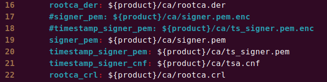

3. 替换构建环境中的 CRL 文件
3.1 确认文件路径
根据您的 manifest.ymlcertificates 配置,通常类似:
certificates:
  rootca_crl: ${product}/ca/rootca.crl   # 或指定绝对路径
将新生成的 rootca.crl(DER 格式)复制到该路径下,覆盖旧文件。
3.2 检查文件名匹配
注意文件名必须与配置一致:${product}/ca/rootca.crl(字母大小写、下划线/点号)——常见错误是配置为 rootca_crl 而实际文件名为 rootca_crl(无扩展名),请确保一致(参见社区帖子中 恒扬-李天亮 的解答)。

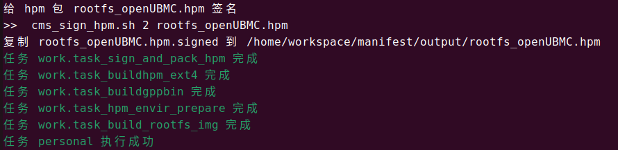

试下这个是否可行:
  1. 下载bingo源码,
  2. 在bingo 里把hpm_verify的行注释掉,
  3. 执行sh install_local.sh 本地重新安装bingo
  4. 在manifest使用原来的证书和crl构建出包,看下是否能升级成功。
  5. 如果能,则
    a. 在manifest目录将新的根证书放在rootfs/opt/bmc/trust/partner下 制作过渡包。
    b. 使用新的根证书进行签名构建出包。即完成转换。
  6. 如果不能,则需要去烧片。
